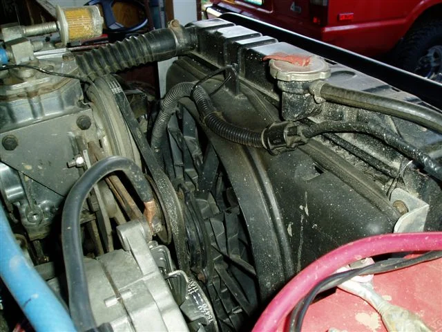

Auxillary Electric fan in front of radi as air pusher while crawling
Before I begin, yes, I did a search and spent a good while reading a ton of posts on electric fans (diagrams, taurus, V8, mounting, FAQ links, etc), but still have some questions as most of the past topics seemed to cover electric replacements/upgrades behind the radi versus in front as an auxillary.
At slow crawling speeds the temp in my V8 will get up to 220 or so in the hot desert we have inland. SO, in preperation for the coming summer, I was thinking of running an auxillary electric fan (the PO claims he had one, but kept it) in front of the radi. This is just to cover the cooling issue when crawling as my daily driving temps are good to go.
1. what are your thoughts on a fan in front of the radi as an auxillary to the fan behind the radi
2. your thoughts on using a therma to control it, versus a manual switch to run it as you see fit. (I seem to tend towards a switch so I can run it as I want when I want.)
3. any side effects of having an Auxillary fan in front of radi that, when not in use, impinges/reduces air flow into radi when in general use and effect my daily driving?
4. your opinions on affordable fans for in front of radi as an auxillary
I read a post by Gumby that eludes to this setup and that Woody might be doing this setup?

i have one just for that reason, it get nice and warm when i crawl, i mounted it as a pusher see pics, it helps and no side effects, i run it on a manual switch, turn it on and off when i want, got it at autozone like 40-50 bucks dont recall, but very easy to do.

PO installed a pusher fan, it has a manual switch on the dash - on demand. It works well with my 2F, I don't have a theromostat but simply go by the temperature indicator in the gauge cluster. Only downside is that you have so little space to work with that you need to remove the grille screen and don't have a mount for the Toyota emblem anymore

hmmm... so I see you dont run the front grill either. is this because they just do not make fans thin enough to fit in that area bewteen grill and radi? or becuase you just bought what was fast and local?
BTW, can you post a few photos of a view looking down on the fan in front of radi setup so I can visualize the mount and setup?

The one in my truck is the narrowest/slimmest the PO could find, he told me. It is held to the radiator by diagonal mounting strips that come with a pusher fan kit.
I am contemplating two options to solve the "emblem problem", either 1) fab a smaller grille that is held by the bezel, or 2) paint that newer Toyota logo (the roundish thing) onto the round motor of the pusher fan . I haven't decided yet what to do. Just recently, I cannibalized the LandCruiser part from the IH8MUD sticker and put it on the Bezel so that the "nice Jeep" is going to stop.

for your needs i would just get a different radiator, or get a taurus fan. if you must have an emblem

Do you have a fan shroud on your rig?

yep.. custom fan shroud, new radiator (6 months old) and fluids, flushed, good therma and seals, big hoses, etc....
As I said, I have no DD issues or regular wheelin issues, just some slow heavy crawling issues in dead of summer, so just trying to plan ahead. It is just that V8 and no moving air when going real slow and working it.
anyway, it seems these guys are about as thin as they get http://www.flex-a-lite.com/auto/html...-electric.html at about 2 5/8 for 140 pusher.

Taurus fan fixed mine...fit like a champ with only minor trimming. Really dig the amp needle being pegged when it kicks on too. Let's you know something is happening up there. That and the squirrels being sucked out of the trees and into your grill.

nice to finally see an install photo of the Taurus fan I've read a ton about.... but I am sticking to my story about just wanting an 'auxillary' fan setup (though I doubt it is going to happen given the lack of room).
