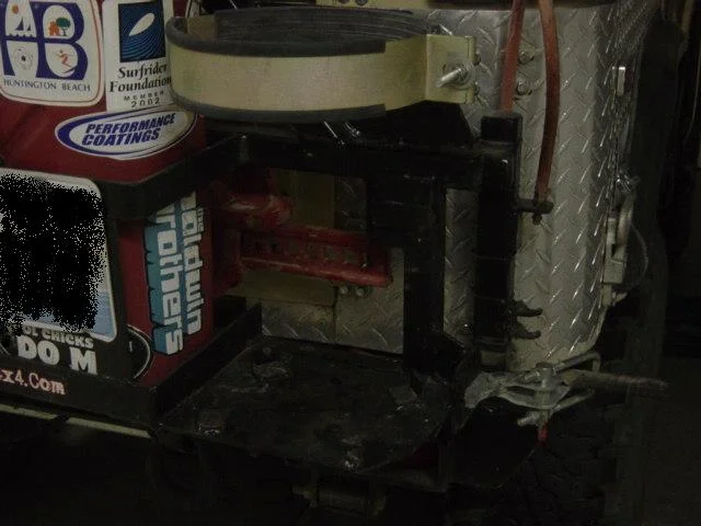

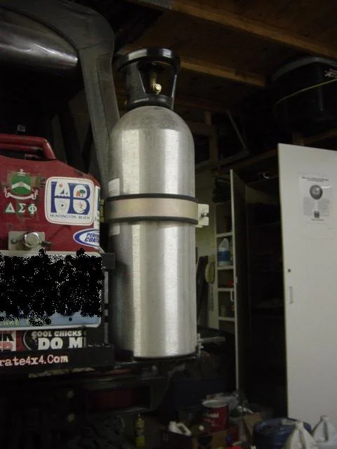

I have a 20 pnd tank mounted to my rear rack, next to my jerry can and spare. I bought a regulator that I got from williamsballoon.com, cheap. Never had a problem with it. Unless you need the "super" fill valves that some vendors sell then just get a standard one with a quick release. I figured I could wait the additional 30 seconds to have my tire fill up. The tank also powers an air block in the engine compartment which I run my arb's off of from pneumatic switches. No electrical or solenoids to go bad, all mechanical and air driven.
On a side note, I have about 50 of these switches I need to get rid of. I bought them with a good friend when at one time we were going to be putting a company and kits together. Never materialized. That being said, if anyone wants a pair of switches, let me know.
I will be doing the ROTW later this week and will include more info on the switches setup, cost, etc.

nother.....

I've been running a Co2 bottle for quite a while. My original mount had it in the back passenger corner right next to the tailgate. A mishap, at Tellico, had me going backward down "school-bus" and another rig moving forward to keep me from going all the way down. Scary indeed. After the sudden stop. and damage evaluation. My tank mount (at the time a standard fire extinguisher mount) broke free and put the tank on a position where the regulator might have been broken off, by impacting my cage. The only thing preventing that was the handle that shrouds the regulator (powertank tubular handle deallie-O). That was the scariest thought of the whole ordeal. Had the regulator been sheared... Since then I relocated the mounting position to where in the event of a roll/crash, whatever, the tank and regulator should not impact anything at all. and in the off chance it does, it gets ejected from the rig, not into the driver/passenger compartment.
My mounting position will not work on a rig with jump seats as it is on the driver side wheelwell, horizontal, with the regulator right behind the driver seat. Yes I have to remove it to fill tires, etc..., but I don't mind. With jump seats it may be mountable beneath one on either side. All I know, is I feel much safer where I have it now.

A CO2 tank will not violently discharge like you are describing. You are thinking of compressed air or nitrogen tanks. Think of a Co2 fire extinguisher and you have a better idea of what would happen. Probably scary but not likely life threatening or "missile" like.

I did not know this, so that's why I placed mine where I did. Not to sound like a dick, but can you please provide back-up for this. I know the expansion rate of Co2 is much greater than air, and that is confusing me right now. It sounds like you know what you are talking about, but for those of us less knowledgeable, I feel it would make some of us feel a little safer with some back-up.
Since I got rid of the jump seats placing the tank where I did works well for me. The placement leaves very little risk of even chancing damage to the regulator. For me placement anywhere else just isn't worth the risk. I know it isn't ideal for everyone, as we all use our rigs differently, and are physically set-up to our own needs.
Again, I don't want to question you on the perceived "danger" just some explanation for education sake. I like to be well informed, that way if anyone asks why, etc.. , I can also pass along competent information.
