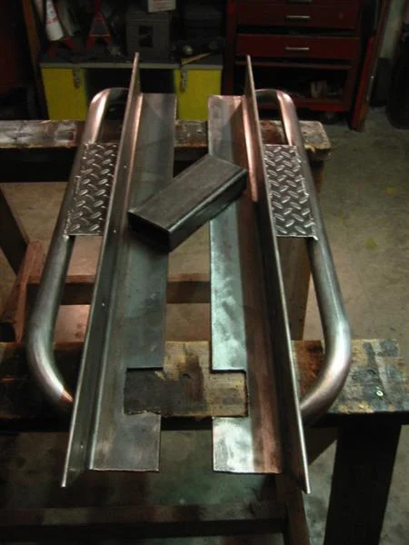

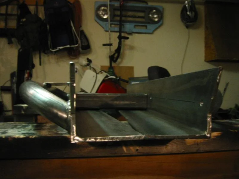

Hey folks,
Finally got around to buildin up the sliders. They're my first so they're not perfected yet but they'll do the trick and give me a start to base future builds off of. I like the DP step but I'd like to also try just adding 2 evenly spaced tubes in place of the step to get that "totally tubular" look , we'll see.
Just used 4" x 1/4" angle and cut out a hole for the frame's body mount arm extension thing, and 1 1/2" tube with some 1/8" thick DP. I had one bolted up and jumped around on it and it was super solid (being on fiberglass even ) and I think it'll be tough enough. I'll go plant em on some rawks and do the ol Hi-lift test here soon, pics to come.
If I find that they need some extra support to the frame I'll likely just use 2x2 tube welded atop the lower part running to plate bolted to the frame. I'll post up some pics of em installed asap.
Whaddya think?

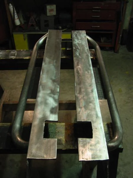

More pics...

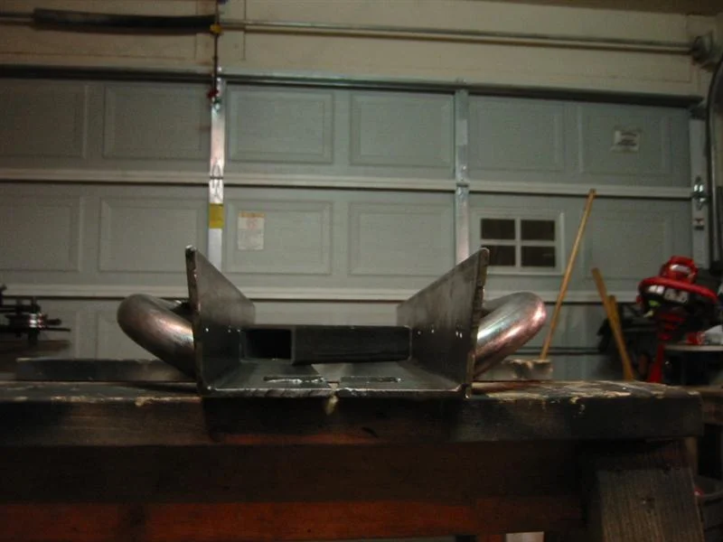

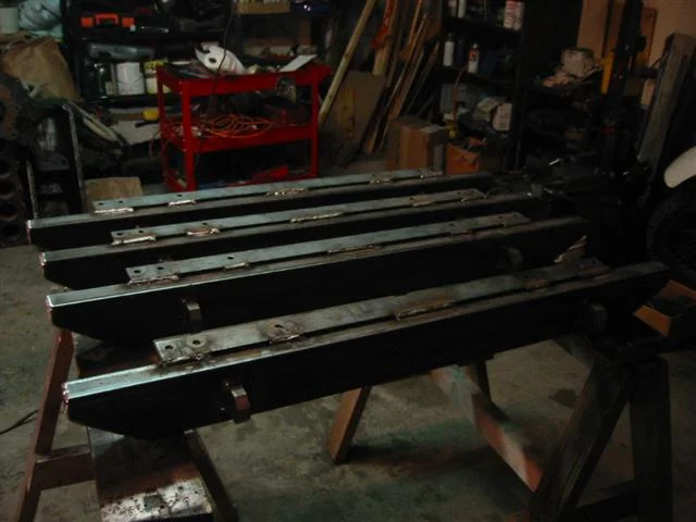

Oh yeah, and I still have bumpers available too. I'll build em to your lengths and ends. Please PM if interested in order to keep this thread clean and about the sliders.
Just thought I'd mention that too

they very sleek. verynice job!!

Look nice....
So these are designed to bolt onto the lower rocker section?
No pic of that one installed?

Thanks guys.
Yeah just bolts on with no cutting. Eventually I'll build em skinnier after I trim the rockers once I get this thing built up a bit bigger. But for now, for simplicity they just bolt on. I also have those rear bushwacker flares that reach all the way up to the bend in the body so that saved me from having to form that section.
Didn't get any pics of the one installed, was just test fitting it. I'll post up pics when I get em painted and installed.

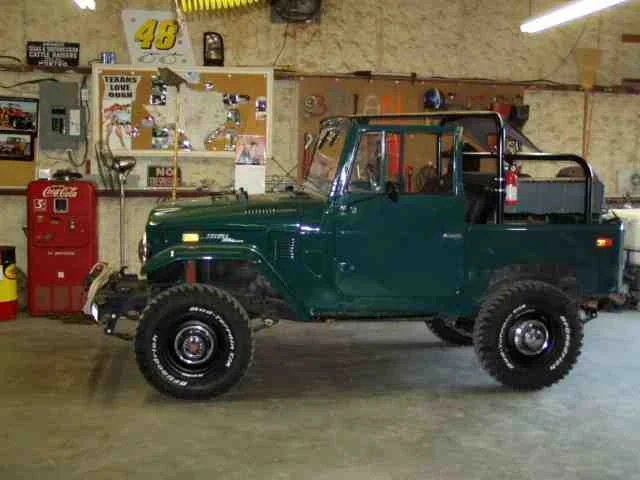

[QUOTE=HawkDriver]Where U live at in CenTex? I'm in Killeen.
I'm between Waco and McGregor off Hwy84. I've been working on a '70 40 I picked up in Cove back in Oct. It was sitting on 190 infront of Repair shop (bad camo). Its been a few years since wrenching on my '72. Having a lot of fun with it.
I would have just bought one of your bumper if I had known about them. I asked about installation because of the pipe through the frame at the saginaw box hinders other bolts for the bumper brackets. I'll probably just weld it.
The weather sucks today! Sitting on the c'puter while drinking beer. I hear theres good offroading around Hood. Do you have access?

Dude if that's the same cruiser that I think it is (there were 2 within a mile of eachother on 190, one with a deerstand both camo, I think yours had terrible tape and padding on the roll bar) then I asked that guy about it about 3 years ago. He said no way would he consider selling it so I was like whateva! and drove past it for 3 years, then it just disappeared oneday .
Yeah I wheel on post alot, it's the only place to do it around here. But you have to be sneaky and do it enroute to the fishing hole or bird watching spot.
Let me know if ya wanna hit the trails oneday. PM me.
Is that the same one in both those pics?

Yea,
That padded roll bar rusted holes in the tubing. Cut it up and bent a new roll bar from a Harbor Crap bender. Not perfect but good for now. No, their not the same cruiser.
The green one is a DD I rebuilt a few years ago. Its pretty much stock. Thats why wanted the camo one from CC. I won't feel guilty cutting it up. I hope to make it a more trail worthy rig.
I'd love to wheel on Post. I'm limited to my buddies ranch in Evant. I've heard the tank trails can be fun. I'll PM later.

I dig those. I especialy like the diamond plate step area/support. nice!
here is my friend and mines first attempt. Welded right to the rocker protection panel which is bolted on.
Something I did, which I have seen no one else do is the addition of skateboard grip tape on the top of the slider for that no slip entry/exit.

Here are some driveway pics. The things to overcome yet are whether people will have the fender flares or not as I will have to lengthen them just a bit and bend that rear few inches to match the body. Look at the closeups of the area.
The step doesn't appear to be centered on the door but it's in the spot so that as you're climbing in it's just right. I was afraid that the aft area of the tube would stick out quite a bit but it barely sticks out past flush with the flares.
They're pretty tucked in and streamlined with the rockerpanels. Trail testing still to come.

I think I will need to add some black to the bottom of the front fenders somewhere to tie in the colors. I plan to trim some of the corners off of the fenders as well.

Those look good, I might be interested in a set myself. For the whole non skid deal, you might want to consider spray on bedliner. I had both my front and rear tube bumpers linexed and no longer worry about slipping and killing myself. On sliders, it might make them a little less likely to "slide" but it works great for the nonskid deal, and it's way tougher than paint. Whatever I wind up doing, either buying or building sliders, I plan on linex.
