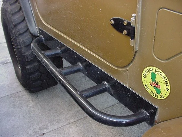

Hey folks,
Finally got around to buildin up the sliders. They're my first so they're not perfected yet but they'll do the trick and give me a start to base future builds off of. I like the DP step but I'd like to also try just adding 2 evenly spaced tubes in place of the step to get that "totally tubular" look , we'll see.

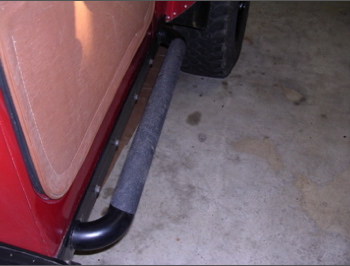

Do you mean something like these?

I dig those. I especialy like the diamond plate step area/support. nice!
here is my friend and mines first attempt. Welded right to the rocker protection panel which is bolted on.
Something I did, which I have seen no one else do is the addition of skateboard grip tape on the top of the slider for that no slip entry/exit.

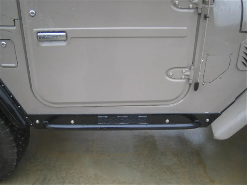

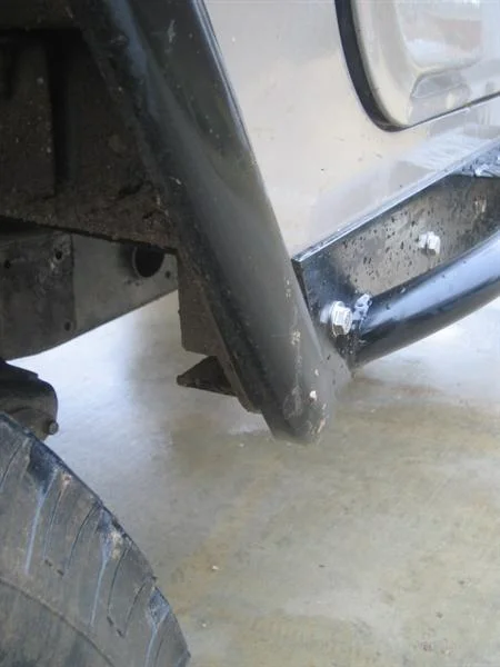

Here are some driveway pics. The things to overcome yet are whether people will have the fender flares or not as I will have to lengthen them just a bit and bend that rear few inches to match the body. Look at the closeups of the area.
The step doesn't appear to be centered on the door but it's in the spot so that as you're climbing in it's just right. I was afraid that the aft area of the tube would stick out quite a bit but it barely sticks out past flush with the flares.
They're pretty tucked in and streamlined with the rockerpanels. Trail testing still to come.

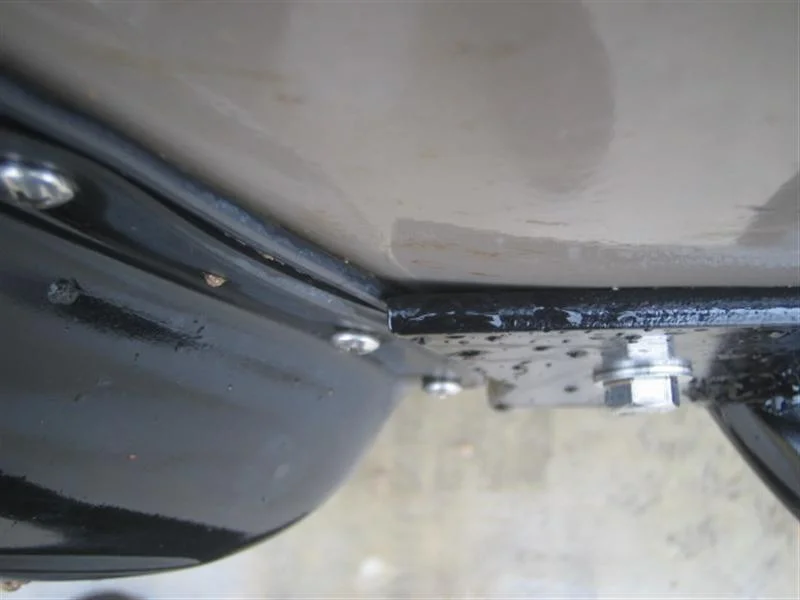

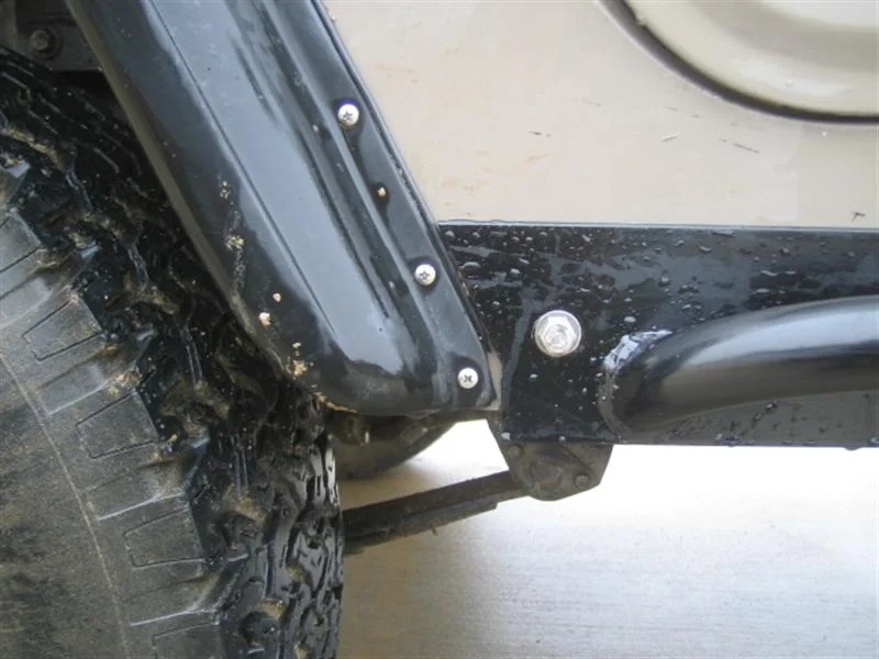

More pics...

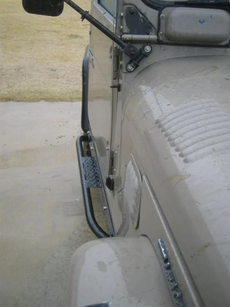

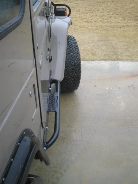

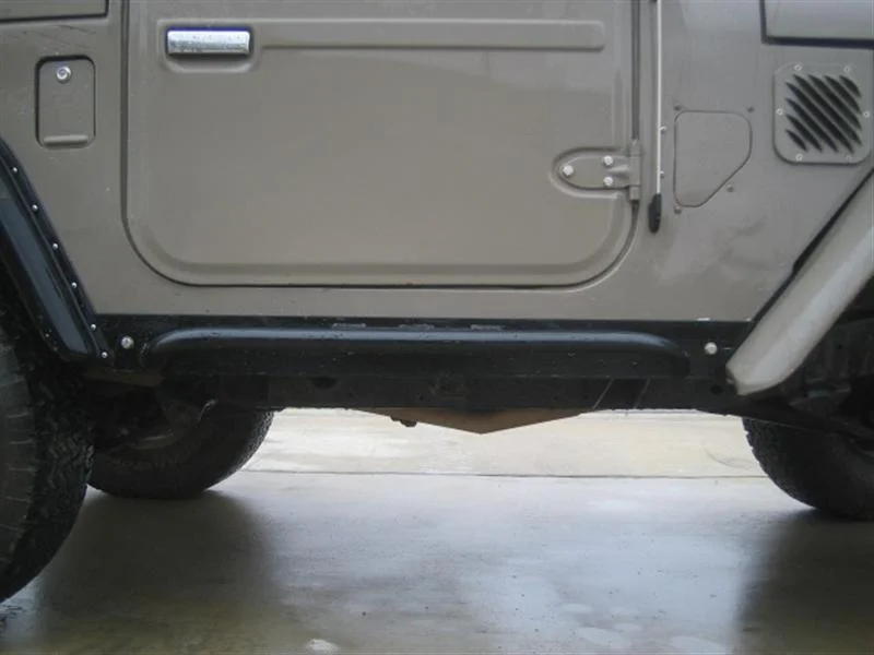

Oops I forgot the side views.
I think I will need to add some black to the bottom of the front fenders somewhere to tie in the colors. I plan to trim some of the corners off of the fenders as well.

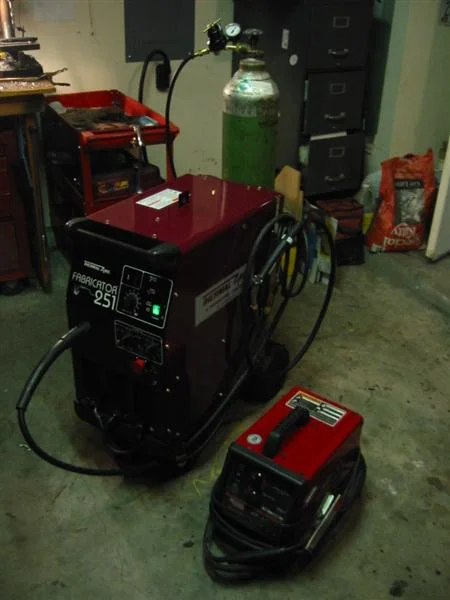

Let me dig up some garage pics. Just pieceing it together a little at a time. Please excuse my mess, havn't had a chance to clean up since yesterday.
Thermalarc Thermadyne Fabricator 251 Mig
JD2 Model 3 Bender
Victor Cut Master medium duty Oxy/Acetylene outfit
Dewalt 14" Chop Saw
GMC 4 1/2" Grinder
Harbor Freight 4" vertical/horiz band saw
Delta bench top drill press
Delta bench grinder
Craftsman 33 gal compressor
and a few other little things.

They have a support that bolts to the frame. 1/2" plate with 2x2" tube and a fat gusset. It keeps it high out of the way of rocks and gives the slider a nice plane to slide on.
The fronts are bolted to the body outrigger, and those mounts are still under development. It's working for now.
