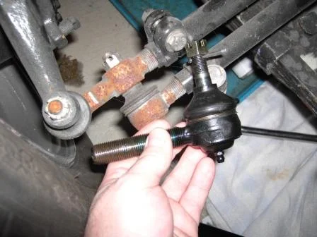

Question: My new tie rod ends came with the grease fittings loose/not screwed in. Am I supposed to put grease inside the ends before putting the fittings on, or should I just tighten them on now and make sure I grease the fittings when I've got the whole thing assembled?
Probably a stupid question, but I just want to make sure.

Install fitting and then clean well! then paint black. If not they will RUST!!!!!!!! Then fill with grease, do not over fill.

Are those painted? I can't see that good
The rusted set in the pic have never seen outside, they have been mounted for two years in the garage. The one in my hand is OE and they come painted. my .02
