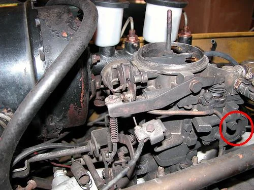

Quote:
Originally Posted by PabloCruise
At some point you could send the distributor to Jim Chenoweth for a rebuild, and probably work out a swap with the '75 cab for a '78...
He doesn't have a '75 carb.* If he did, then there would be an AAP in the red circle instead of an empty housing for an AAP. The AAP appeared only on '75 carbs. The housing, however, remained until '78 production began (9/77).
*It could be a carb made in 1975 for the non-California market, since they lost the AAP at that time.
Nice truck, by the way. Mine's got fewer miles, is similarly original, but nowhere near as nice.
