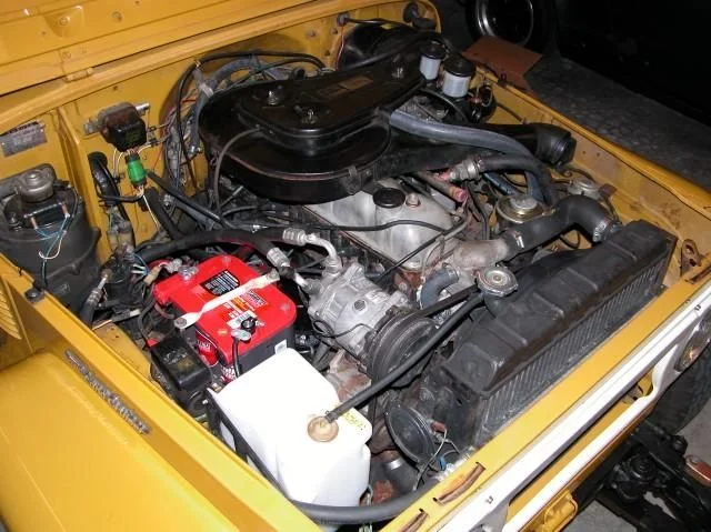

I have more pics and will try to dig them up.
The CA model has a different exhaust manifold than the federal model. I don't think it changes the carb orientation though or they would have had to make a seperate aircleaner for CA only. Maybe the platform ( spacer) that the carb sits on has been changed on yours?
Doesn't look like it would take much to get things to line up.

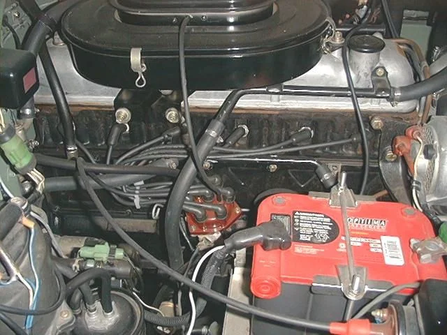

If you need to, you can always come and look at my '78 for questions about stock configuration. I'm the only one that has worked on it since new and I know every bolt that has been disturbed on it. I'm over in Kitsap, if you happen to be passing this way anytime.
Can't tell if your air cleaner is original by the pictures. The passenger-side mount is not adjustable, but the mounts on the front and rear of the air cleaner are adjustable. You may just need to adjust them properly.
The CA/Federal differences are just in smog gear. The CA exhaust manifold was much larger to retain more heat and burn the exhaust more thoroughly. The exhaust head pipes and EGR pipes were also different due to the exhaust manifold differences. The placement of the carbs is the same.

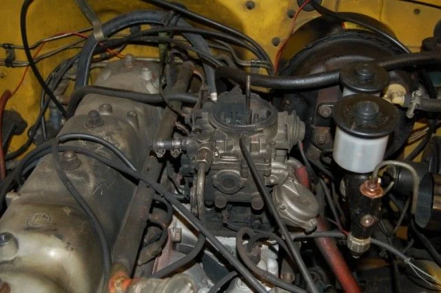

I pulled the air cleaner off tonight and armed with a bit more information, I am one step closer to understanding...and a plan.
The picture below is my carb. This is very clearly a '75 Aisan Federal carb (see this set of photos from SOR).
First, a seemingly stupid question that forum searching did not answer: Were Aisan carbs the OEM equipment on these trucks? People talk about them as though they were aftermarket, but then no-one ever talks about Toyota/TEQ carbs?
Second, seems to me that this carb is going to just cause me headaches. The truck runs ok as-is, but I really don't like the idea of having mis-matched parts. And when it *stops* running OK and *I'm* the one trying to fix it (being generally clue-less) it would be great if the pictures and descriptions in the repair manual made sense an matched what I actually had.
For now, anyway, I'm just trying to understand what I have. I'm not making any decisions. The air-filter is fairly secure sans-bolts, so it'll hold for a while.
My biggest concern is the vacume tubes. There is nothing connected to the nipple on my distributor. This thread indicates it should come from the carb somewhere. I can't find any thing obvious there. On top of that there *is* a tube coming out of the air filter assembly that is not attached to anything (I might have pulled it out removing the air filter assembly last night). I assumed 1+1 = 2 and it connected to the distributor, but after reading that thread I'm not so sure.
On top of that, there are 3 (three) tubes that terminate near the emissions "computer" thingy, but are not conected to anything at that end.
The good news is that this is a blast. My hands are greasy and I'm remembering things about working on engines that I forgot 20 years ago.

Teq,
I'm betting your air filter housing is an earlier type even more now that you have figured out the year of your carb. It makes sense now.
How many ports on your distributor? Mine has two. I believe it is for and advance and retard for the smog equipement. The previous owner may have disconnected yours completely. Take a snapshot of it and post it up.
If i was to make a guess a previous owner tried to do a psuedo de-smog of the 2F that or the original carb crapped out and they replaced it with an earlier model.
Lets get our 78s together and compare them side to side and get it sorted out. I'm also planning on doing a complete de-smog of my 78 so there will be parts availble for you to make it right. Lets chat about it later..

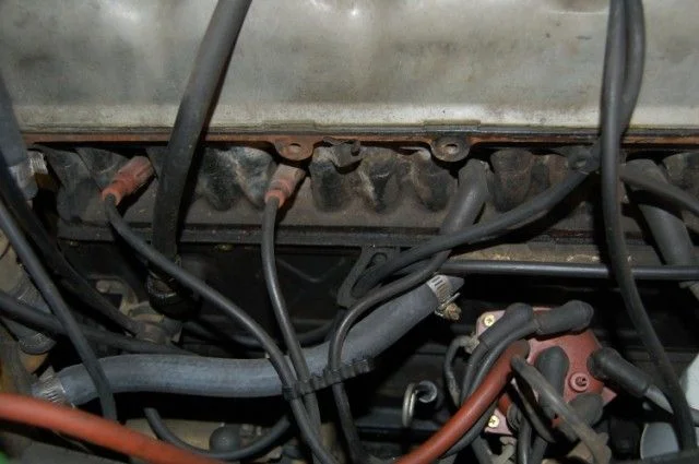

Here's a pic of the engine bay from the passenger side. You can see where that vacuum line from the top of the distributer attaches to the aircleaner.
I failed CA emissions last year because I forgot to re-install the hot air tube when I was doing carb work .
There are numbers embossed on the computer next to each nipple. If you post the numbers I can tell you where they should go.
I would suggest getting the factory emmissions manual. Has lots of good info that you won't find anywhere else.
TEQ,
I think you figured this out, but the Aisan carb is the factory Toyota carb. The trouble you seem to be having is when the PO went back to a stock carb they found a different one, which is very easy to do in this time frame. When Toyota was trying to keep up with all the emissions requirements during the seventies, they changed the carb like every year after '74 and had separate models for California. You have a factory carb - just figure out which you have, and what emissions need to be in place for that carb.
Tucker

With the exception of taking my son to his Lacrosse game and sign the papers selling my BMW I was able to spend all day wrenching on my cruiser. For a complete noob like myself, I'm quite proud of what I got done...
I started by warming up the engine and getting my tools ready. Then I drained the oil, took off the old oil filter, the air filter housing, the battery, a bunch of ancient hoses, and the distributor & rotor.
By the end of the day (about an hour ago) I had
New oil filter.
New fuel filter and fuel lines.
New spark plugs & wires.
New distributor cap & rotor.
New Optima battery.
Several new, re-routed, vaccum lines.
A new washer fluid & coolant overflow tank.
The 1" heater hose from the air pump to the air filter.
Several other hoses (not the cooling system).
New stainless steel bolts holding the bezel.
The pics below are:
- The engine after I was done.
- No more rusty screws on the bezel, and a fresh coat of wax
- My '95 BMW 540i M-Sport leaving my driveway for the last time... I'm going to miss that car...

I drove her for a few weeks and really got to know her. She really drove well with the exception of sloppy steering. Clutch, gearbox, power, all fine.
During this time, with the help of Bull, I checked the compression and vaccume. Good.
I also did the major portions of a standard tuneup:
Oil change, oil filter, distributor cap, new plugs & wires, air filter, and fuel filter. I didn't flush the coolant or replace the belts because it wasn't obvious to me how I'd get the lower hoses off and I was anxious to get back on the road. I'd do that another time...
I degreased and power washed the engine and undercarraige. During the process of cleaning the engine I realized the exterior of the carb was really dirty:
Running the engine with the air filter housing off, I discovered why. The carb (from a '75) had one of it's ports plugged in a half-ass way (see the little hose section on the left of the pic below?) and was leaking gas. I'm sure this contributed to the overall stench of the truck.
The fix was simple. I just took the fitting off, cut about 1/2" off each end and re-fitted it, making sure the clamps were on tight.

Here's some pics I took during the tune up. A PO had attached the fuel filter to the + power lead using a zip tie. I fixed that by attaching it where it belongs under the battery tray.
I also decided at this point my battery tray deserved to be replaced given it was rusted through.
Replacing the plugs, plug wires, and distributor cap was a snap. I did notice that my distributor is pretty ugly looking inside. Seems to work fine, so I'm not going to sweat it, but maybe someday when I'm bored I relplace it.
