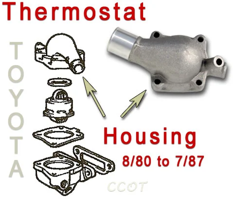

Dug into my coolant leak tonight. Discovered it was leaking out from between the two halves of the waterhouse.
When Bull & I were getting the rig started for the first time the thermostat was stuck. I whacked the waterhouse with a hammer and cracked the lower part. Oops. So Bull put another on that he had lying around (from a 73 I think). It leaks.
So I set about taking the top half off and putting a new gasket in.
Of course both bolts broke off right away. Sigh.
So now the lower part needed to come off. Fortunately those bolts didn't break (they were just put on).
I got one of the broken studs out with vice grips, but the other just broke again.
Easy-out to the rescue? No. I actually saw Bull use an easy-out successfully once. But for me I'm like 0 for 5. I keep breaking them. Now I've got a broken bolt with a broken easy-out in it. Frack.
Well, I didn't like the fact that we had to leave the temperature sensors disconnected with this housing (it's from a 73 and this is a 78 and still has smog gear), so I'm going to give up on this housing and source a proper one. PM already sent to cdan.
No driving the rig until I fix this... Sigh.

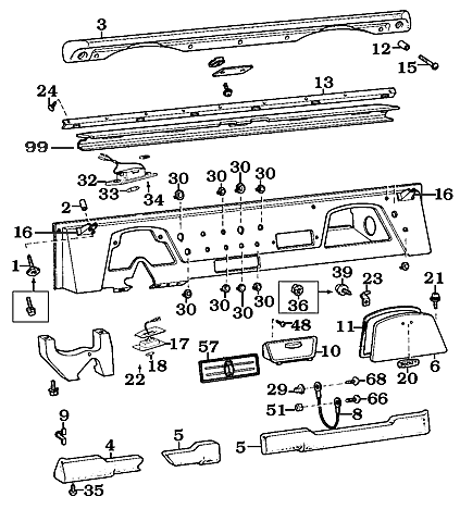

Anyone know what this "spacer" is for?
It fell out of my dashboard when I was replacing it the other night (along with a miniature glass giraffe...I'm not kidding).
It looks important, but for the life of me I can't figure out where it goes. It may have just fallen into the dash in a prior life (along with the giraffe).
Pictured next to a bolt (and the giraffe) to show scale.

Quote:
Keep the little fella!

If no love from dan I have a spare. BUT the later stronger 4 bolt is available still.
#2
And #12? Shouldn't there have been 2 of them?

I was in such despair over not being able to drive her tomorrow I dove into drilling out the easy-out. I did it without ruining the cover. Then I tapped the bolt hole.
I didn't have a replacement gasket, but the upper from my original still had a ton of paper gasket left. So I put some high-temp gasket seal on it for good measure, put some anti-seize on the bolts after cleaning them with a wire wheel and put her back together. Then I used the same rtv stuff between the housing and the block and bolted the whole thing back on.
I'm sure it's still going to leak without proper gaskets, and I really want to find a correct lower half, but I'll be driving it tomorrow!

Behind the snorkle defrost duct there is a 4.5 inch bolt that should go through that dowl and into the windshield frame. Yes one each side. peek in there and see if they are in place.
Shane
No, they are not there. When I put it back together I did not put them on because I didn't know they existed. I wonder where the other one went? I'll put 'em in asap.
Thanks.

Tonight I installed the thermostat housing from Melloj123 (thanks!). It contained a 190 degree thermostat that was in far better condition than the two I had here (both 180s). I hope I don't have a problem with it running too hot now (but a mud search found several threads where folks say it should be fine).
I got new gaskets and seals from SOR and am now 99% positive I no longer will have coolant leaks. We'll see
