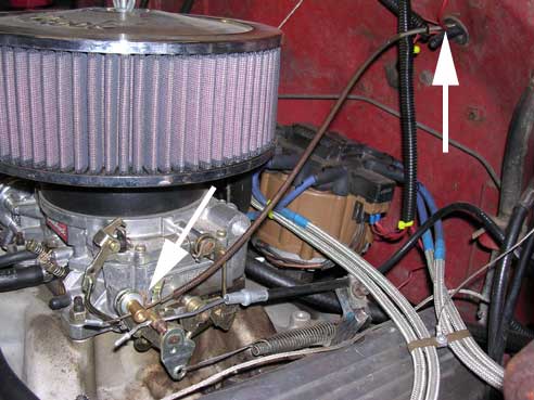

My FJ40 hand throttle + crusie(r) control
My rig had a choke that was not being used. cable was just tied out of the way (as it is not needed on my engine/carb setup) and knob just sat dormant. So, I rigged up the choke to attach to the Edlebrock carb at the throttle arm.
Now, I have a hand throttle that allows me to increase RPM's (up to well over 3000 if I wanted) - which I used yesterday wheelin up some hill climbs - without the gas pedal and it has the side effect of being a cruise control on the road (except, obviously, when you hit the brake it does not terminate the cruise control).

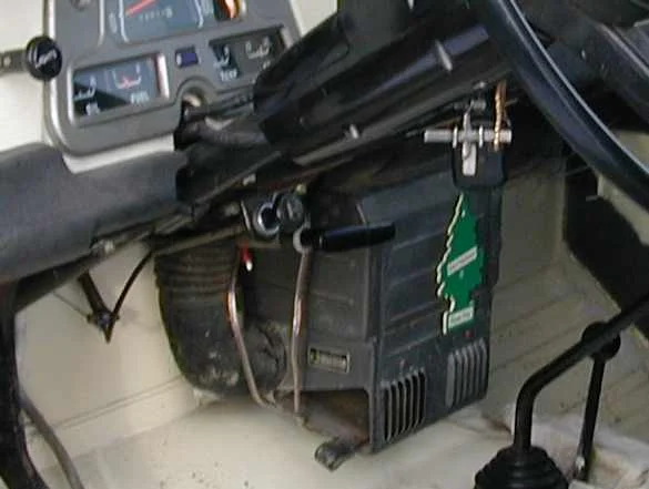

seen here. i thought it was stock? attaches to the gas pedal itself, scary to use at speed because as mentioned you have to reach down to turn it off
interesting... not seen that before. mine is the CHOKE knob right on the dash right in front of me.

i couldn't tell you for sure but its got a little picture of a butterfly opening (like in a carb, can't really explain it too well) so really you could call it a choke knob. maybe its just been relocated but its a pretty clean setup so i assumed it was stock. i do still have the manual choke hooked up on my dash
