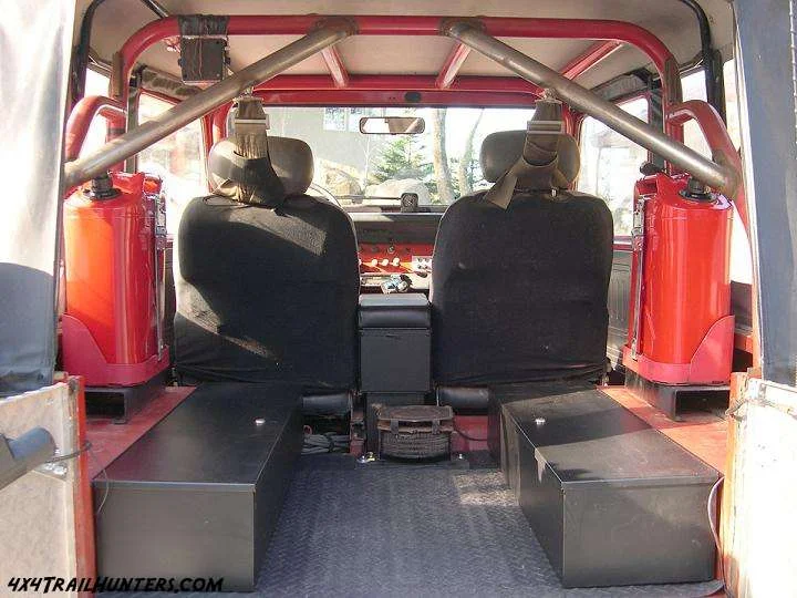

I got these boxes from Conn-Fer about 10 years ago. Don't know if they still make them though.

You're carrying gas inside??
Those are similar to the boxes I have in the '79.

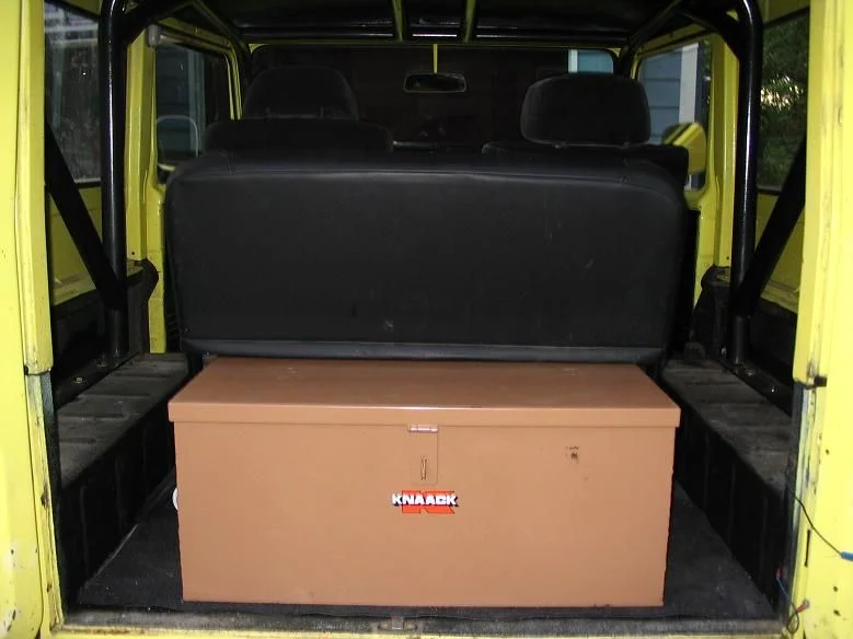

this is what i used, www.knaackbox.com they have different lenghts and hieghts but it was about $105.00 with tax. fairly thick steel will keep the ohnest people out and slow down others

Originally Posted by tfdcruiser
here is my homemade under seat (3rd row seat from 93 suburban) drawer. I used 100# drawer slides from home depot and welded up a drawer out of steel mesh and 4'"flat stock. The slides are bolted to the sides of the wheel wells and the lacth is a window security lock. It works great, stores alot and only cost about 30.00 in material. the removal suburban seat acts as a lid and pivots up if I don't want to slide the drawer out.
That is freakin smooth man, nice work.
I will try to post more pics tonight with it full of gear. It is very light empty maybe 15 lbs ?
More pics please.

here is a few shots of the drawer full of gear and of how it is attached to the inner fender wall. the other image is of the suburban seat folded in the up position.It is kind of like the stadium seating in a land rover; gives good visibility to the rear passengers. the middle pic also shows the quick connect attachment point to the suburban seat.
