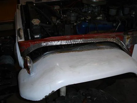

I run 37" MTR's on the street and 38.5 SX's on the trail.
2F, SM420, 3 spd case, 4" BDS SUA, '78 front axle, '77 rear and it took me a year to break an axle with these heavy SOB's. Friday I'll order the new Poly Performance rear axles and if the wife hasn't killed me by the 30th I'm ordering Long's 27 spline chromo's for the front. My front springs are flipped so the fenders really must be cut. You'll need to cut the back too, but you can put a TJ flare on it and it looks good.

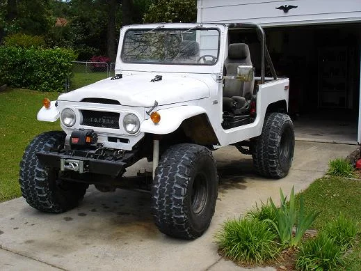

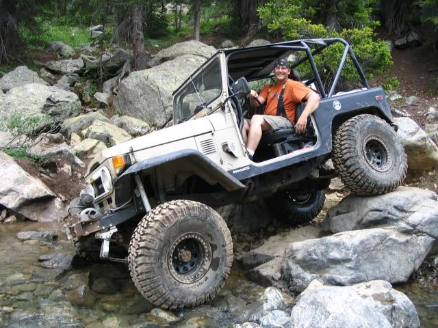

37x12.5 MTRs, 4" SUA, flipped springs, sheet metal....
stock axels with longfields...
http://www.root45.com/gallery3/main....edec73959d58aa

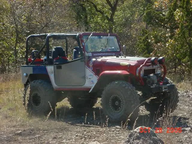

the fronts will rub (SR will help). I have metal-tech fenders in the garage, just need to weld them up.

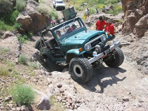

Mine is a 71 w/ a 351w and a NP435 and 3 speed case. SOA front, shackle reversal w/ stock 40 springs that have the short side forward (flipped). Chromo front axles w/ Aussie locker. The rear springs are flipped with a welded stock 3rd w/ stock axles. I moved my front fenders up about 4 inches and forward about as much. The rear is trimed up as far as I could go without raising the wheel wells. 2" BS wheels 15x10 to keep the tires out of the inner wheel well. I am curently runing 36x14.50s but I am going to get some 38.5 SXs or some 37" PitBulls in the neer future.
I have beat on it a few times out with absolutly no problems.
Can you say poser shot? These are the only current pictures that I have on this computer.

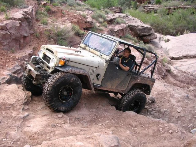

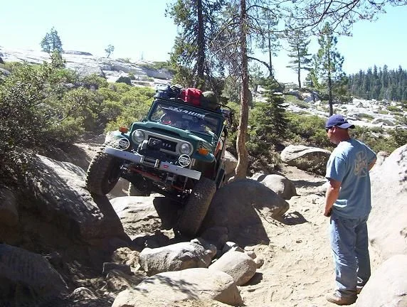

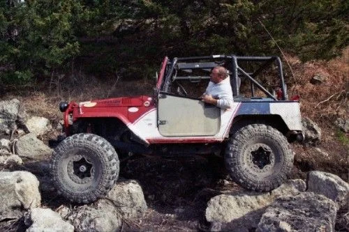

37 mtr's , trailready beadlocks w/2 inch back spacing, cruiser axles soa'ed w/ ringless Longfields, alcan centered springs w/ anti wrap leaves 1 inch taller than stock.....Had to trim a little off the rear quarter panel to center the tire in the wheel well using TJ flares..........Barely touched the front fenders at full stuff with 35's.......Had to add bump stops to keep the 37's from hitting .....
Top shot at gatekeeper w/37's
Bottom at Calico w/35's
