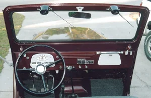

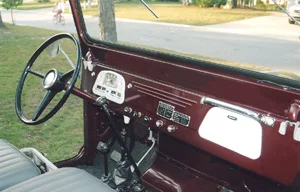

Originally Posted by 77TLCFJ40
Great write-up. Please give us a little more detail on repainting your dash knobs and pictures if possible.
Thanks, 77.
Some slightly off-white paint for the knobs. Over-painted the grooves for the lettering. After it dried, real fine steel wool over the whole face of the knob. That leaves the recessed white lettering intact and polishes my knob at the same time. (Did I really say that? )

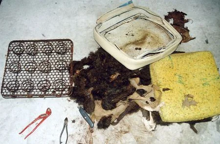

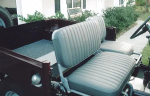

Some more interior and a good reason to re-do 50 year old seats.
If anyone's interested, Foxfab and I did a step-by-step seat recovering post in the FJ25 Forum.
http://forum.ih8mud.com/fj25-owners-group/46314-sors-fj25-seat-covers.html
