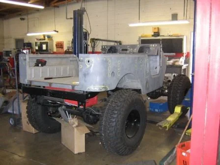

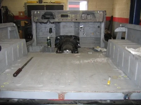

Well here is a photo of some progress. Pretty High!
Will post more soon
John

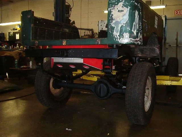

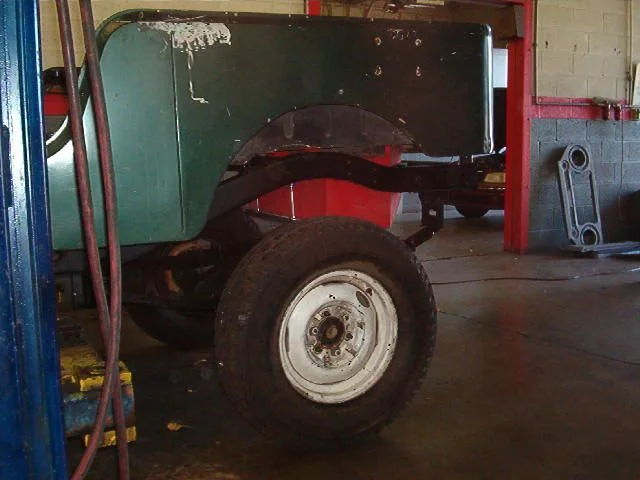

photo 2
Another

what kind of gas tank is that? why are you using castor shims in the rear? if you can get your shackle angle near 45' you'll have a much better ride.
everything looks clean i like it.
looks good your gonna need bigger meats..

Downey fuel cell
Spring perches are not painted, no shims. Waiting to weld them after all the "weight" is added.
Original plan was 35" tires, may need to go bigger!
Thanks,
John
PS
Body is off again. Motor and tranny are in. Will send more photos after the
T-case is on.
MandMAutomotive is offline   Reply With Quote

That's going to be quite the lift when it's back on the road. Looks good...

Quote:
I never thought I'd hear myself agreeing with this for a fellow FJ25'er, but yep . . . you're now gonna have to fill all that space with some tall rubber.
Let's see what the front looks like.

Give it a good couple outtings out on the trail and those springs should settle some.

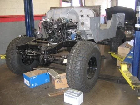

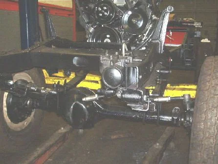

Front

thats a nice build... Get some better pics so we actually know how clean your work is...
Good luck to your sweet rig!

get some pics of your motor mounts for me, looking pretty good. go with some 37 and itll look good. as far as backspacing i run 2.5 on 15x8 rims i like the added width and they look better.

Wow, someone isnt scared are they?? Looks good, and quit eunique, wow a 25 wow!

just a comment, I have the same tank, you may want to paint it silver. It sounds crazy but it makes a HUGE differene in keeping your fuel cool. On a hot highway that tank will soak up heat from the road. I am in SO CA though where it can get pretty hot in the summer. Also, I painted mine black, so red may not be an issue, I got vapor lock though.
Noah

more photos
PS, Trans case and motor mounts
Hopefully we can get the fuel and brake lines done today. Body is out getting blasted.

Food for thought, or something to watch out for.. A lot of the PS mounts are done with 2 scab plates on either side of the frame. Take a look at this for an example.
http://www.root45.com/PowerSteering/
I have a really nice one that Butch Lewis did, but have no good pics of it. This becomes more critical as tire size goes up.

Spy pics of M&M's project from Living in the Past:

Is it just me or does the cut-out for the steering box in the crossmember look scary.....
Quote:
JP
