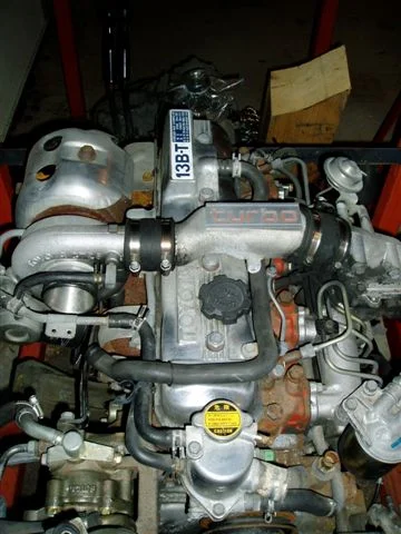

cleaning
Not to my standards of clean yet, but without all the coolant and vacuum lines running all over the top, it's getting better. I also plan to flip the throttle cable down the bottom side so that it doesn't cross over the top of the motor, so that bracketry is removed. The coolant lines and vac stuff will be figured out once I get the motor in and see how well things line up. It also depends on whether I go to a standard alt or if I keep the vacuum style. Putting a seperate vacuum pump on the intake side will eliminate the over or around the engine lines.

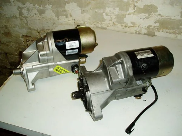

2LT parts
I picked up some reman 2LT parts off of a 1986 toyota pickup diesel.
Close but not quite a perfect match. The starter lower body is quite a bit different, but the upper half is almost identical. The post on one side is moved around a bit and the drain hole is handled differently, but that's about it. The lower base must be swapped out.

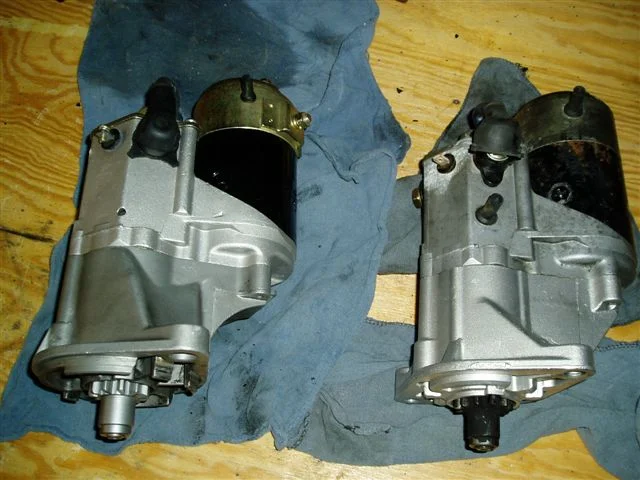

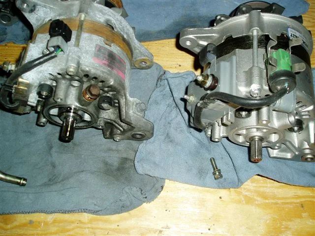

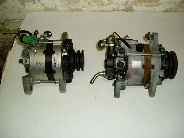

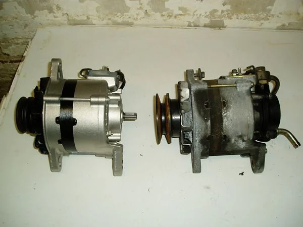

2LT alternator
This is darn near perfect. The only two real differences are the adjuster ear and the pulley itself. It appears that I will need to order a slightly longer belt so that the alternator can swing wider than the original configuration. Not a problem. The pully looks like it can easily be swapped over, although the larger pulley will make it turn slower....and less amps produced at idle. Oh well.

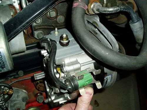

alt installed
It's not really installed here, but you can see where the adjuster ear bottoms out against the power steering pump. As I said, a longer belt will be needed.
One thing I'm pretty positive about though, you could swap the internals of the 2LT into the 13BT 24V alt. I bet you could order the rotor and the regulator, but the starter/alt rebuild guy was unable to find the Denso part numbers to do so.

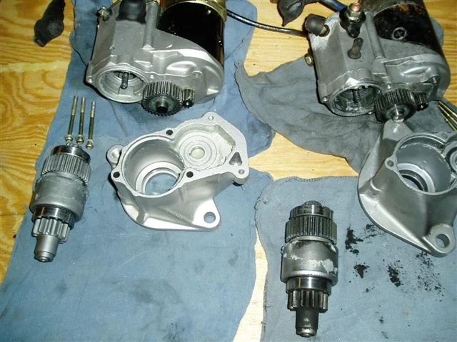

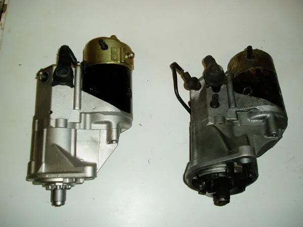

Starter swap
The starter swap was easy. Just disassemble the nosecone and swap over to the 13bt aluminum housing. Perfect match!

alt swap
The alt was NOT so straightforward. I thought the 13bt would be the later fine spline vacuum pump, but it's not. You can see here that my orange block doesn't match. The good news, is the blue block 13bt does. Perfect match. I just have to use the later model one. Interesting.

Starter did not work as planned, and I don't really understand it. The 12v starter, although new, would barely turn the B over, definitely not fast enough to start. The 24v fires it right up....I warmed the motor up, then swapped the 12v back in. No go, even from warm. Since the 12v starter motor came from a 4cyl diesel, and I'm putting it in a 4cyl diesel, I have to think my compression is either MUCH higher than the 12v B's and 2LT's, or I have bummed remanufactured starter. I always thought direct injected turbo compression specs were lower than indirect NA though?
I haven't made up my mind yet, but I may be taking the starter back and getting another or just go with a marine series/parallel switch and be done with it.

No, I actually used the entire remanufactured 12V diesel starter....except the aluminum nose housing. If you look in the picture above, you can see where I pulled the two aluminum lower housings and just swapped that so the angle would be right.
Yeah, I don't get it. The motor was struggling so hard to turn the engine over. It would even turn then pause, then keep turning....like there was a dead spot in the electric motor.
The solenoid is fine, but it seems like the starter was only getting half power or something, but it still got warm from use.
BTW, the 12v starter motor has a small bolt spot welded onto the gold plated section. Any idea what that's for? It's not heavy enough for a ground lead...

A 12V manufactured starter we supply to customers turns over the 13BT in my BJ60 quite well.
You do have a solinoid activating a straight feed right from the battery to the starter...correct?
