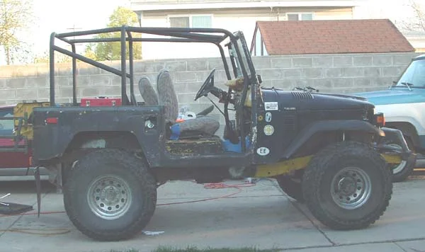

Well this snuck up on me quickly!
My Toyota Land Cruiser is a May 1976 FJ40.
I bought the truck in June of 2000.
It's the first (and only) vehicle I have ever financed.
When I got it, it was mostly stock, but it had a 2" lift from some BIG-A@#$ add a leafs and some 2.5" long extended shackles. It was running some 33" Remington Mud Brutes that were nearly bald. It also had a soft top. Little did I know what I was in for!
A few months after purchase, I bought a hard top on E-bay. I had had a few issues with blown heater hoses, and other General MAintenance items. When I got the hard top, I was speaking with the person I had bought it from, and he was telling me I needed a valve adjustment. So I got the truck home, and pulled the valve cover, and I Found no oil in the head.
I made the decision to pull the head, and what I found was that the head gasket was installed upside down. Further more the cylinders were rough, and the engine was in need of a rebuild.
The engine came out, and I had it rebuilt.
The engine was rebuilt by a machine shop that was WELL versed in F and 2F motors. Cruiser Outfitters used the shop and I figured it was good enough for me! The motor was punched out .030 and a rv cam was installed. Oiling system was upgraded and the head was decked a bit.
After the motor was rebuilt, I had Jim C rebuild the carb, and I installed a non-USA distributor. THe PO had installed a Man-A-Fre header and I Decided to keep it.
I've done a number of other upgrades to the truck.
-OME suspension with extended shackles.
-35" Goodyear Wrangler MT/R's
-SM420 transmssion witha Mike Smythe Adapter plate.
-Saginaw Power Steering With UltraBeefy tie rod and relay rod
-Anarchy Offroad Roll Cage.
-$10 special Yard Sale seats.
-Lock RIght
-CO2 tank
This Land Cruiser is my daily driver. IT's also the only vehicle I own.
I drive it to and from work every day. I drive it to the trail heads.
It isn't the prettiest truck in the world, but it's mine, and I love driving it every day.
In the future, I will be installing a dual redundant air system, and a front locker. I plan on doing a spring over this winter.

sweet rig, did ya put the roll cage in yourself?

Anarchy Offroad built the cage.
It's 1.75" .120 DOM tubing tied to the frame in 4 places.

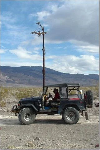

L O V E the priscope! or is it an anti tip over doo-hicky(pic3) James...You are a braver man than I, I didnt even consider doing the ROTW.

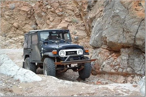

Those pictures posted by Dianna sure don't look like any of the canyouns I've seen in Ohio!

So where and what in the hell is that bat thing at?
Those are the biggest maybe even the only mudflaps I've seen on a 40.

Oh no you di-nt.....
My Poser pic-O-the day
About the bat...I will lest James tell about that, Could be a cave or su-um
