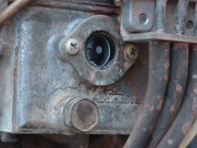

my carb
This is off subject kind of but I have a question for my own personal gain. How do I tell if I have an Asian carb or some aftermarket one? I have looked all over it and I can't find any identifying marks.
JC39232 is offline   Reply With Quote
Old 09-15-05, 10:24 AM   #6 (permalink)
Forum Lifer
PabloCruise's Avatar
Join Date: Jun 2004
Location: Northern Colorado
TLCA# 10713
Posts: 6,048
It will say "Aisan" on the front, under the sight glass...
