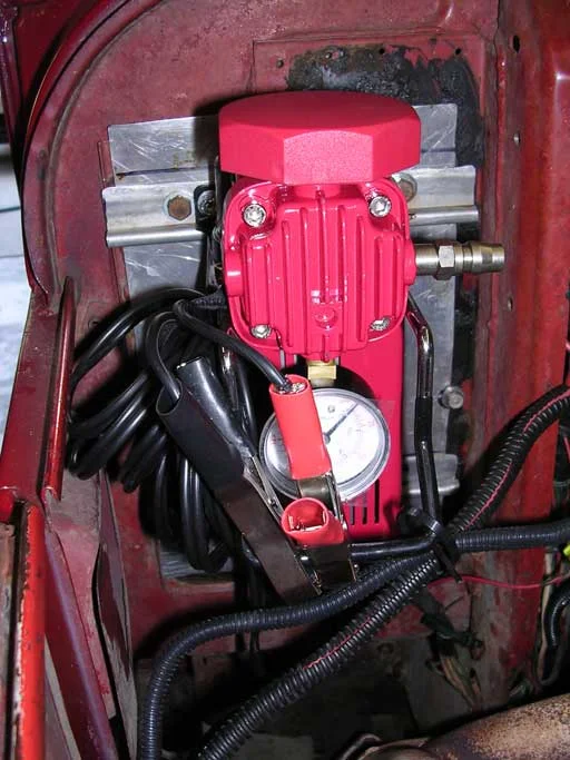

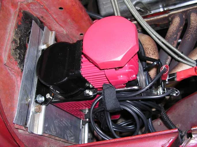

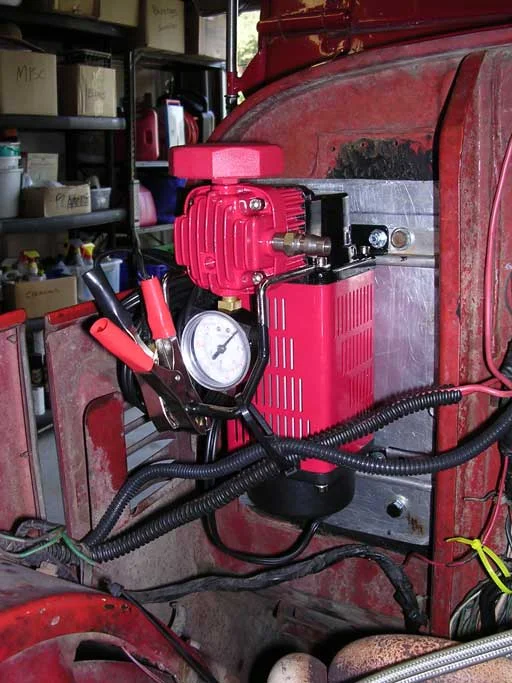

1 cookie pan + 1 air pump - 1 old heater = on board air!
here is the outcome of my on board air mod.
remove old heater from 1974 FJ40. take 1 old cookie sheet of aluminum and fabricated into a bracket for the pump. 1 MF-1050 pump from Pep boys (got great ratings from other websites on pump speed, quality, construction, value). I matched the cookie pan bracket I made up to the bolt pattern of the pump bracket I made to the heater bolt pattern. mounted pump to bracket. bolted into place where heater was. I used the cookie pan edges as further reinforcment for the bracket to take the weight and allow the pump to purchase down onto them.
now, it is within reach of the battery. on board air for under $65.00.

That pump will produce enough heat of its own without your hot engine compartment overheating it. I would move it out of the engine compartment. It may work fine but I bet it will trip any heat safety much quicker under the hot hood.

Yeah, I though of that. So, not only is it removable with 4 screws if I need to take it out and set it on the ground or something, BUT I do not really intend to run it with the engine running, pump running, WITH the hood closed. I would think (and I have tested it a little bit) that I would have engine running and hood open, and it is not so bad. either way, more of the point was to be able to have a good place to carry it out of the way, not have to put it in the rig to take up space, and have it if I need it. I mounted it up and out of the way from the headers and engne about as far as I could to accomodate this. good thing is that it has a heat trip swtich just in case.
