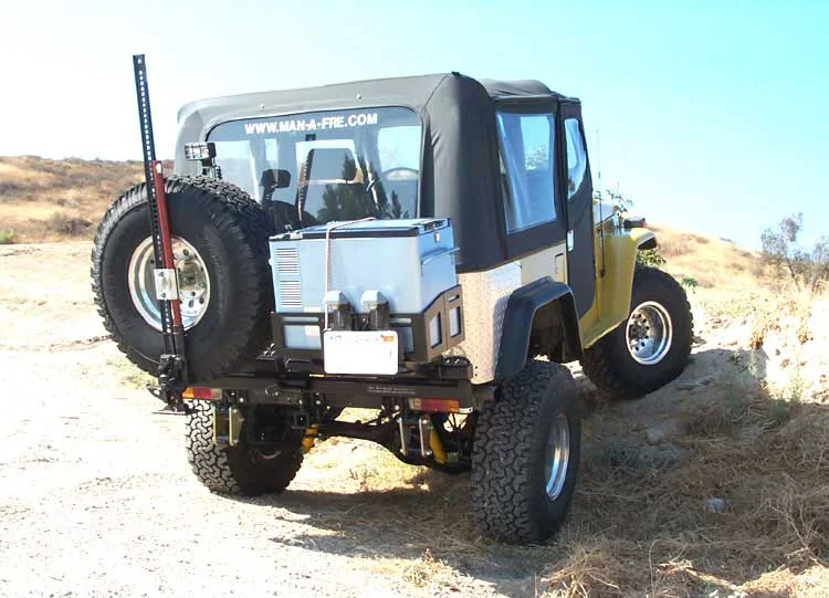

Is anyone on the board running this style carrier? I have seen a few with the older style ones but haven't seen the new style on any rigs yet. My question is whether or not a standard size cooler will fit in it like the ad says. I called man-a-fre and the internal dimensions of the basket are 24 1/8" x 13 3/4". All of my coolers are 14 1/2" deep. The ARB freezer fridge that they mention fit 42 quart shows an external dimension of H20 x W24 7/8 x D14 1/8"....even that appears to be too deep to fit so I am confused. Is it adjustable maybe?

I have heard the older style with the tube style cooler carrier limits the departure angle. Per the page, the newer design moved both the tire and the cooler up higher to improve the angles. Only problem is the design changed and now Man-a-fre is telling me two different things. First guy said the new design had a bigger cooler rack, second guy went out and measured for me the inside dimensions and they are not big enough to put a cooler in there.
Last thing he said was that he would call the manufacturer and call me back...no call back yet...

I have the older style rack with the round tubes, a 54 quart metal coleman cooler DOES NOT FIT. when I bought the rack the IDIOTS told me that a coleman would fit. I was able to cram a plastic cooler in there.

I've got the older one with the tube basket. I found a cooler that fits.
I hit the pivots and the trailer hitch square box thing when I come off of a rock sometimes. Doesn't look like they raised any of that.

Sorry I didnt see this sooner. That is the MAF-1046 bumper. It is the same as the old tube style rack, but it has a larger basket on it. The basket is not adjustable, but can be removed if you wanted to. I have seen all sorts of different coolers fit both bumpers, there really arent any that I would reccomend over another. ARB has a few different sized coolers, which one is everyone here trying to fit?
65-fj45, that idiot that told you a cooler would fit probably had a cooler in his rack. Did he say that every cooler in the world would fit? I doubt it, and no, we dont see metal coolers here very often.

no call back from Man-a-fre.....I do not believe their cooler carriers can actually hold a cooler. I do not believe they can even hold the cooler that is pictured on their web site (same pic above). I'll send a PM to Steve and see what he says.
No they cant hold a cooler.... here is a link showing that same carrier with the cooler in it not holding a cooler. No cooler? It was all a haux, see I'm a magician by trade, now you see the cooler, now you dont. Wait, its still there, in the rack, the one that cant hold it.

The measurements of the 42 quart ARB cooler are the same as my cooler. The one pictured is a 42 quart cooler and it is in the rack. According to the measurements I have from Danny? that cooler will not fit in the cooler rack. He measured it at 13 3/4" deep. To fit the cooler shown in the rack, the internal dimension (depth) would have to be more than 14 1/8". I don't have an ARB 42 quart to measure so I am going off the dimensions listed on the ARB site. A standard Coleman cooler, plastic, metal, etc. are 14+ deep.
If the actual dimensions of an ARB are less than 13 3/4" then I understand. If that is true, my next question is can I order a cooler rack that is larger from Man-a-fre? One that will fit the cooler I have. If not, can I order a rack that hasn't been powder coated so I can cut and reweld the cooler rack an inch larger?
The best part is it looks like that cooler is floating around in there if you look at the shadows. Seems like there is almost an inch all the way around it. That would make the internal dimension 16 or so, not 13 3/4. I hope that is true because all I need is 14+ inches to make it work.
Unfortunately I dont have a cooler to measure here also. Call me here some time if you want to talk about the custom rack a little more. We may be able to do it, but it takes time to complete, and payment is done up front. Because 4+ is almost a one man operation, we have to prioritize what products are coming through. I also think that ARB changed the their cooler line a while back. I am not 100% sure, but I think they started with different sizes than they have right now. I'll have to look into it.

http://www.arb.com.au/default.htm?main.htm&1
go to products---> ARB freezer fridge. (can't link directy to it)
IMO your cooler rack will not hold an ARB cooler anymore

I have the older style and there is no differnce in the height according to the pictures posted. It is the same height and will be the same for departure angle. I like the bumper but hated the bushings. My bushings go so hard to move that I had to use my whole body weight to swing it open. So I modified the bumper. I cut of the bushings and replaced them with the heavy duty hinges from 4x4 labs. while I was cutting and welding I modified the basket to take a bigger cooler. If you want to look at it I can take some pictures or if you are in Parker stop by and see it. I think it is sweet now. My basket now measures 15" x 25". Let me know if you want pics.
