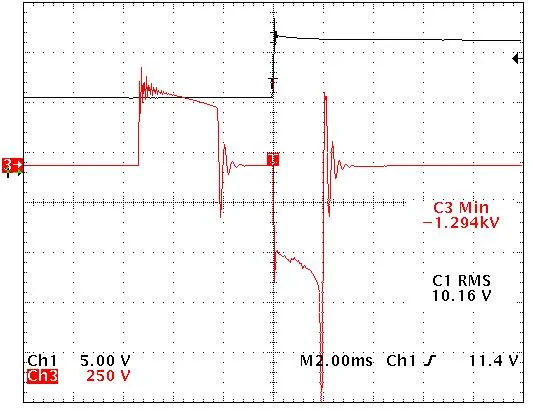

Hi,
I've been sitting on this for a long time. A long time ago, some of us on the LCML were talking about putting a book together on LC electronics. I was going to do a chapter on ignitions. But that is not going to happen. I see often people wanting to know about which ignition to put in their LC, including a recent thread, which made remember I had this stuff, and now that I'm on a forum that I can put pictures on...
Now, I'm not claiming to be an expert, but I did take some automechanics in High school 30 years ago, and spent a year analyzing ignitions on a Sun scope. Ignitions back then are very different from ignitions today, but the basics is still the same. So here is some info, take it or ignore it as you see fit...
To start, in this pucture you will see two traces, the lower one is the primary ignition circuit: battery, ballast, + side of the coil, points, condensor. You will see the points open, higher voltage, and the points close, lower voltage. The upper trace is the secondary circuit: coil high tension lead to spark plug.
Focusing on the part of the traces that we are most interested in, the spark... You will see at the instant the points open, there is a spike in the secondary circuit. This is the energy dumped to the spark plug to bridge the gap with an arc. The larger (higher voltage rating) the coil, the larger this spike will be. Then you will see a changing (fading)voltage level, this is the energy depleting across the spark in the plug gap. Then you will see another spike. When the fuel actually ignites, the blast will "blow out" the spark making the plug gap an open again. The length of this second spike is an indication of the energy remaining in the coil after ignition has occured. My contension is that the length of that second spike is a valid measure of the ignition. If there is no second spike, then we don't know if the fuel ignited, or if the energy ran out, and there was a miss fire.

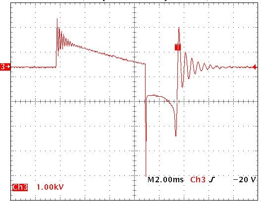

The above picture was of the stock '76 points ignition without the Toyota ignitor.
Below is the secondary trace of the HEI ignition. You will note the large initial spike, but the second spike actually varied quite a bit in length.

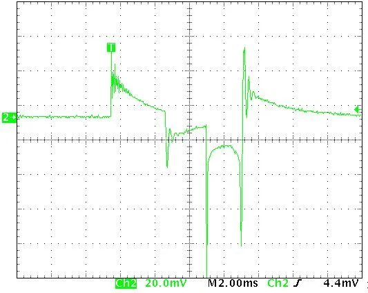

This is a Jacobs Omni Pak on the stock '76 LC distributer.
You will note that the first spike is as long as necessary to establish the spark, and there is plenty of energy remaining after fuel ignition.
Got to go see the PT for my should... I'll be back with an other trace or two, but you got the stock points, stock points with Jacobs, and the HEI.

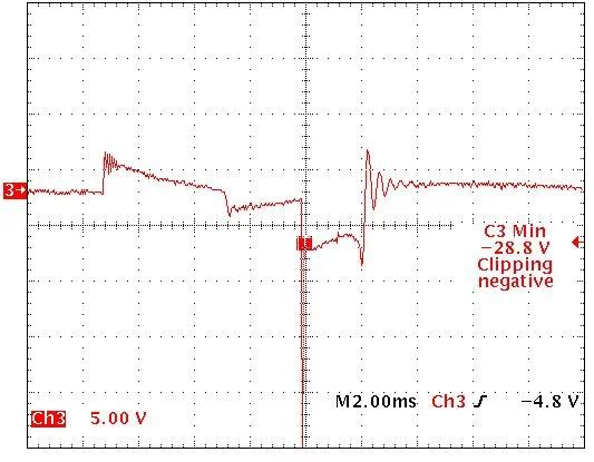

Here is another shot from the Jacobs on the stock '76 distributer, you will see that even when it has to dump more energy into the initial spark to establish the arc, there is still plenty of energy left when the fuel ignites.

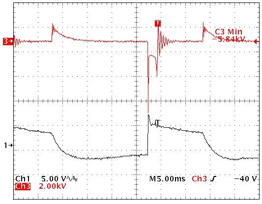

Here is a standard electronic ignition from a Dodge Lancer

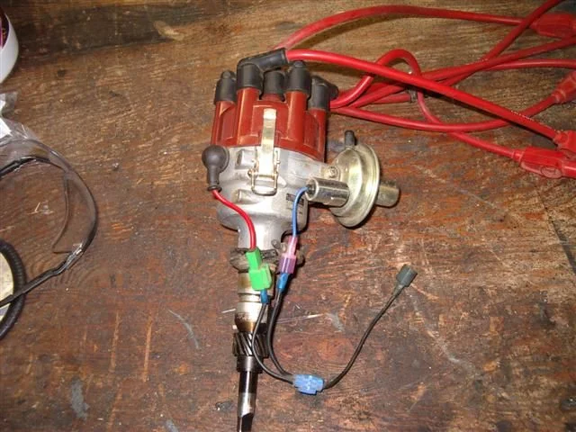

Gary, thats some great info. I'm glad you posted it. When you were talking about a stock 76 ignition, how did you take care of not having a condensor?
Is it the same distributor that came with the ignitor setup?
-Duane
Yes, this is the original that came with an ignitor and no condensor. My ignitor died about 23 years ago. Looking at old receipts, I have two Toyota part numbers for condensors: 90099-52050 and 90099-52060. One of these if not both of these was made to work.
These condensors should have a tab with a hole on the body, and a connecting wire out the end. I bend the tab up away from the condensor body, and screw it into the outside of the distributer with the little screw in the side to hold the vacuum advance in position. The wire that comes through the distributer housing, I used crimp on spade connectors and made a small Y cable. One leg goes to the distributer, one leg to the minus (-) terminal on the coil, and one leg to the condensor. I cut the end off the condensor wire and crimped on a spade connector.
