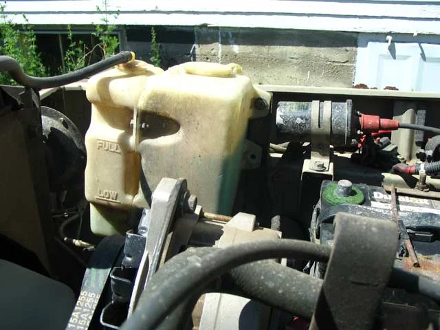

Can I keep my radiator overflow and windsheild washer tank in place and still use the full F250 mount on the passenger side?
I know I'll have to trim the inner fender - no problem there, just want to keep washer and rad tank in place if possible...
Vehicle in question is '78 FJ40.

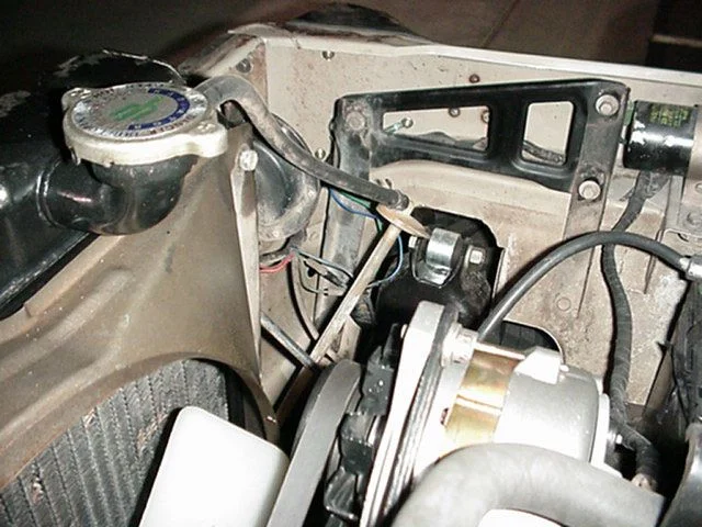

I'll get you a pic as soon as I get home....I have a '78 FJ40 with the F250 mounts and I kept my overflow/washer. My axle is pushed forward a little so it isn't exact but you can see how it fit...
Thanks a lot! I didn't know you have a '78! I saw the one you drove to the RS meeting once...
Axle forward should still tell me what I need to know, as that rad tank is pretty far forward.

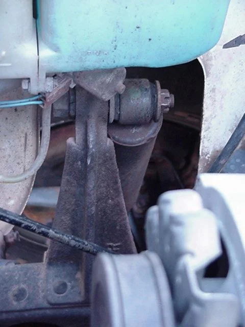

It fits but I might rethink the mounting because it looks like it may rub through if I leave it that way. If you added 3/4 - 1" spacers on the mount I think it would be perfect. You can see in the 1st pic the bottom bolt is missing because the bottle is resting on the shock.

Thank you Mike, these pics are exactly what I needed!

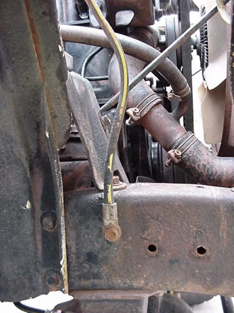

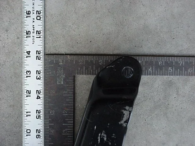

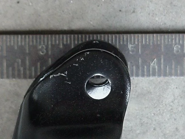

Some set-up shots

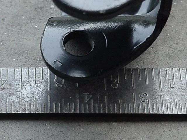

I did some measuring on the F250 mounts to take a look at clearing the washer bottle...
14 inches tall and they reach out from the frame rail just about exactly 4 inches at the center of the eyelet

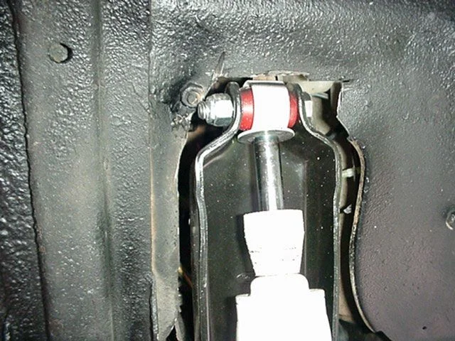

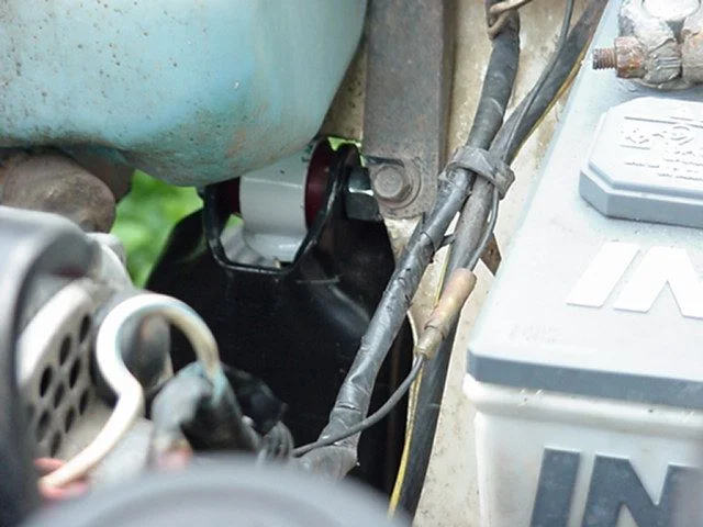

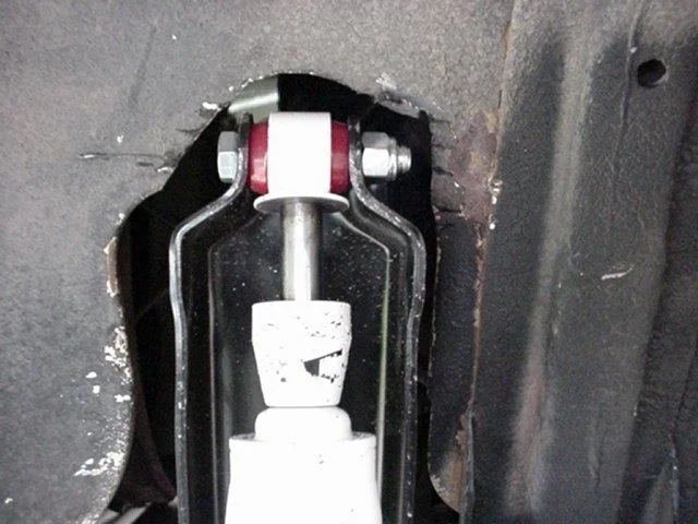

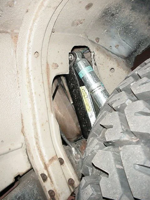

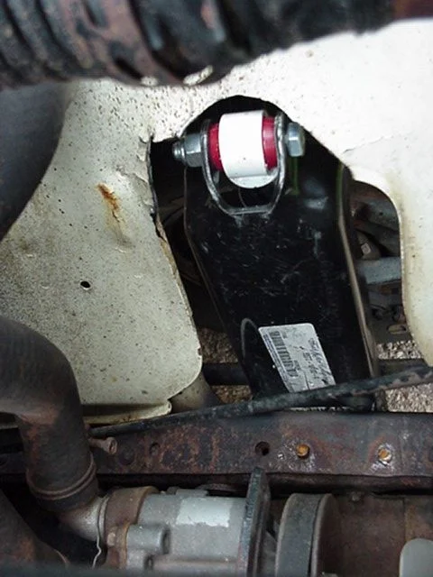

More set up
Move the ground strap...
It was hard to trim the fender apron. At first I just trimmed enough to mount the shock mount. I neglected to realize that I would need space to get the upper eye bolt in and out of the shock mount!
You can see I barely clear the bottom mounting hardware for the washer and coolant reservoir frame...

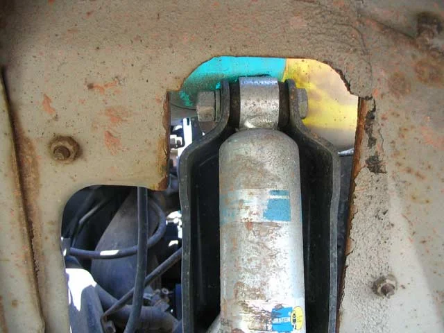

Forgot to mention
I lopped 1/2 inch of the bottom of both mounts so I could clear the washer bottle - just right!
Still have ~19 inch span while static

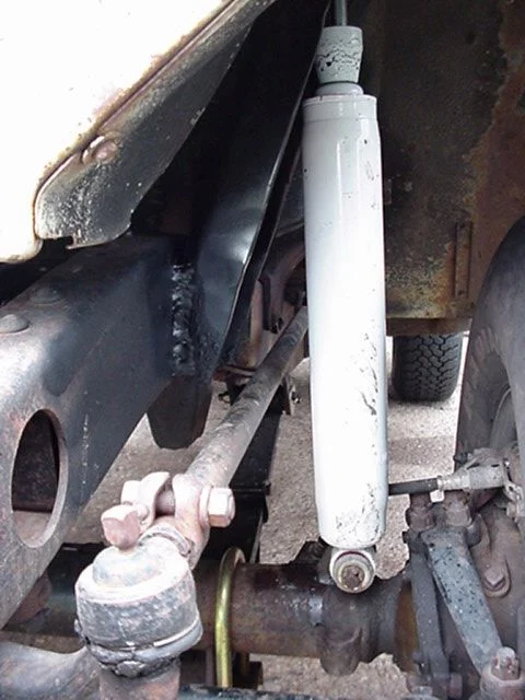

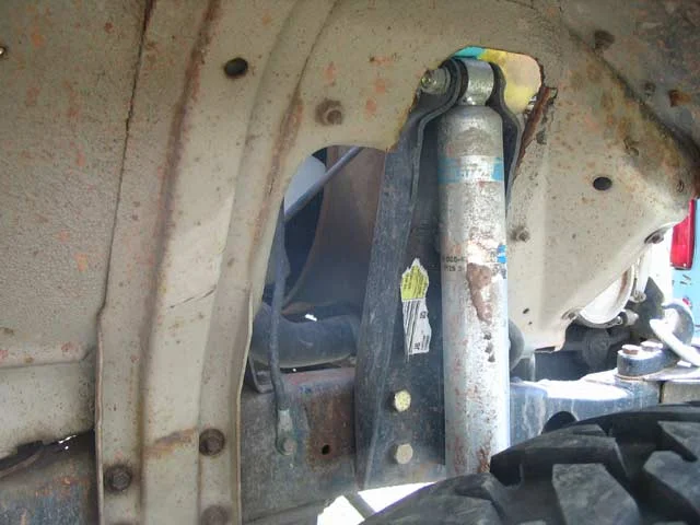

Driver's Side - much easier!
Piece of cake on the driver side.
New shock clears the drag link by a good amount.
Also, makes room for a FJ60 power steering conversion!

How do the Ford shock towers line up with everything if you have flipped the front springs around? I'm guessing it would work just fine, based on the pics I saw. But I just want to make sure.

Math,
They do work just fine... Witness Ige's pic in the other F-250 thread...
http://forum.ih8mud.com/showpost.php...13&postcount=2
Or here is TreeRoot's with front axle moved forward:
I ordered Ford Part Number : E5TZ-18183-A. Said it was for an 80 F250. Trouble is, they are hard to come by now and I'll have to wait a week.
Can you confirm that's the same part you used?
this picture:
Is exactly the info I need to go ahead and order my shocks and get them here in time to continue my build.
