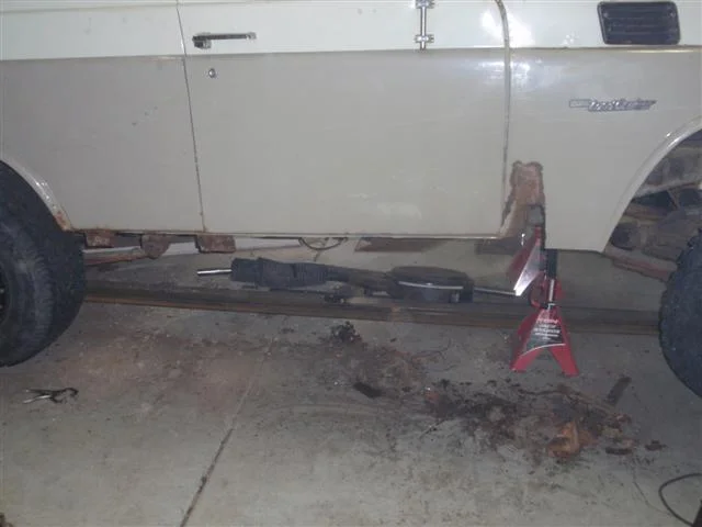

We're looking to run 3" square tube rockers. Any ideas on how to attach them (body/frame). Or any ideas on trim/finish for the body just under the door?

Those are 2x4 tube that is 3/16" thick
Here is how they were cut out:
This is before the inner part was cut off. The black line is where they were cut off.
The 2x4 tubing was welded to that inner part and then welded to the door opening. Mine are not attached to the frame. I don't have a good picture of how they were welded. But my fab guy did a hell of a job blending from door opening to the tube. If the weather co-operates, I'll snap a picture.
Lil'John is offline   Reply With Quote

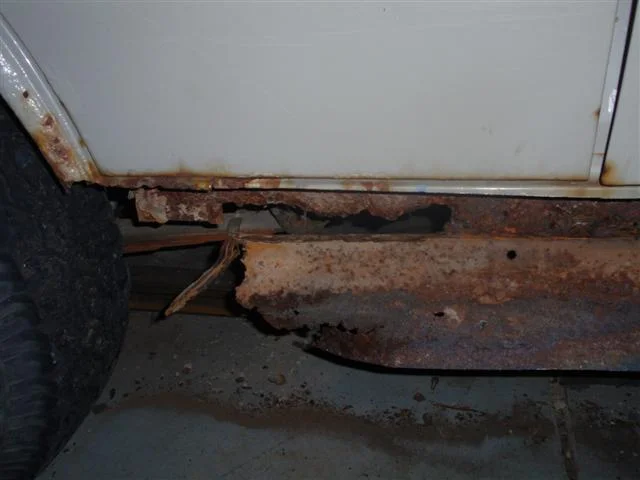

OK, here's a few of the pics that I promised. Thanks for all the help with the resizing.

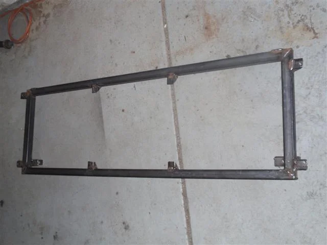

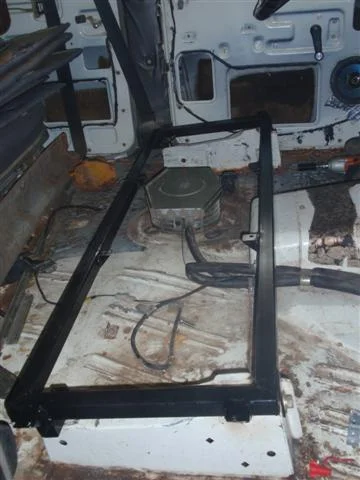

The seat frame!

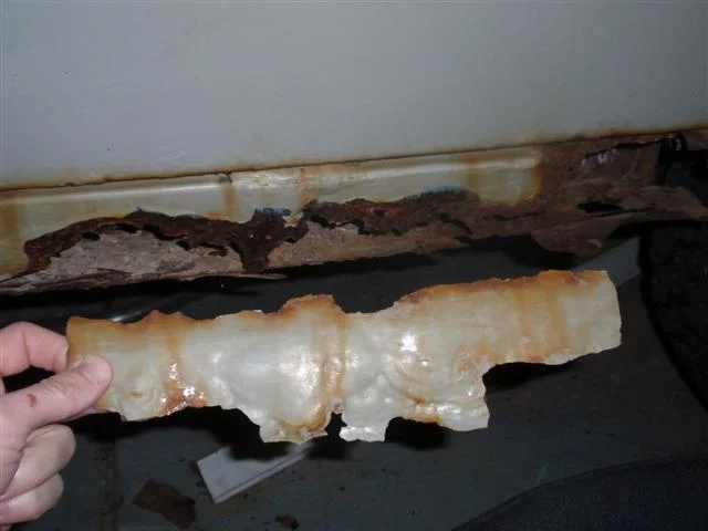

Pass. side rocker rough cut!
Name:  Steves cruiser 031 (Small).jpg
the piece that fell off on the Dr. side while leaning in to work on the seat frame!

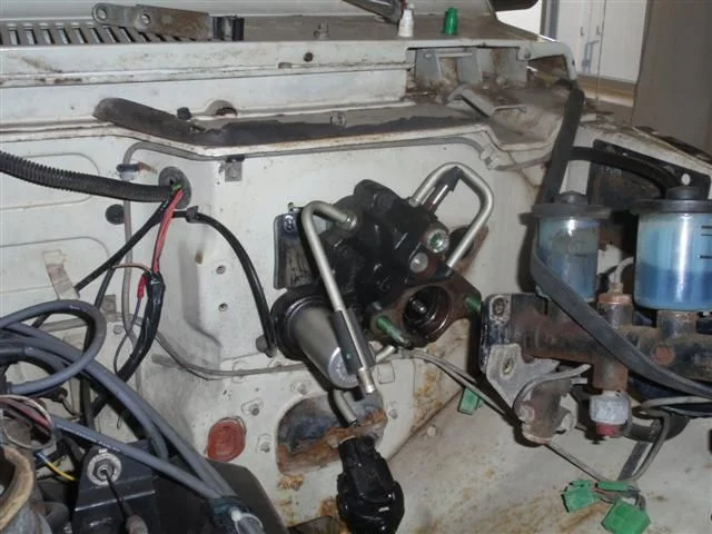

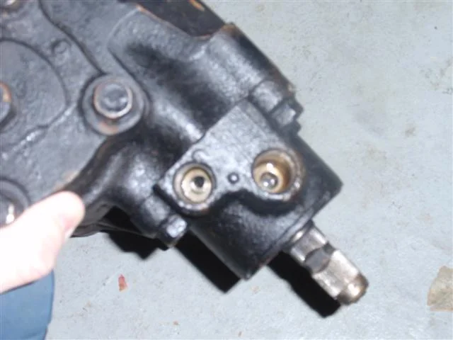

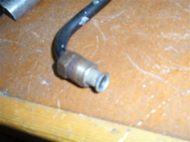

OK. Here's the million dollar question? How are the lines going to seal in this gear box? check out the pics. the gear box is flat in the bottom of the hole, and the line has a buble/flare? WTF?

this may be what you need
Power Steering Pressure Hose Bubble Flare - JTOutfitters

THAT! Is exactly what I'm looking for. Thanks for the help Meat!

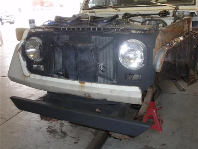

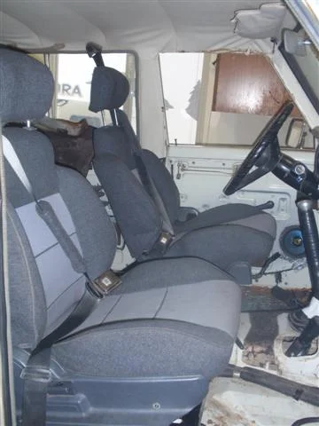

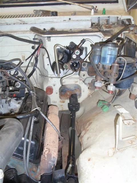

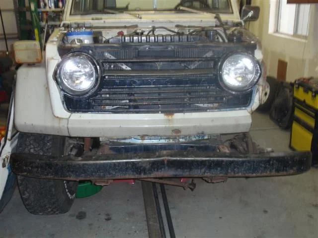

So the Holidays, and the wife were pretty good to me, and allowed me to squeeze in a little garage time. Here's a few pics and the list of what has happened. Front bumper completed. Seat frame and belts 95% complete "still need seat covers". Passenger side rocker trimmed. Front axle removed and being cleaned before delivered to Cruiser Outfitters for the CNT. We still have a long ways to go, but it's nice to see something complete. Even if it's only the front bumper! Thanks again for everyones help. We couldn't make this happen without all of you!
Rick

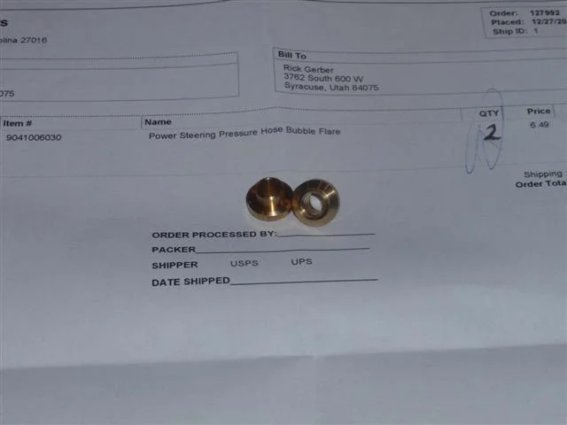

YES! The infamous bubble flare fittings arrived today, and they're exactly what we need to continue with the P/S Conversion. thanks again to meat for the info.

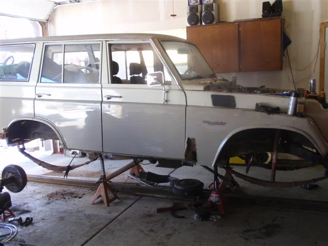

Here's where we're at as of last weekend. Rear axle removed, perches cut-off, ground down and ready to be mocked up for new mounts for the SOA conversion. Hydro-boost and steering gear installed, lines ordered and being built. shock towers shipped thanks to (I Tried). A little more cutting on the Dr. side rokcer panels, But MOST IMPORTANTLY- We got rid of his ghetto a$$ hood latch cable that would cause permanent damage every time you used it. I'll post some pictures of the original frayed cable with the super black-tape handle, and the amazing engineering from Cruiserboy to convert this contraption into a solid lever system. Thanks again to all that have helped. Although we still have a lot left to do, we're starting to see a little light at the end of the tunnel. If anyone has a good deal on a selectable front locker, we may be interested. Depending on our budget as we get closer to the end of this project. I Hope you guys are enjoying the build as much as we are. I would like to give a special thanks to Cruiserboy and SlowerthanU for the countless hours you've dedicated to my brother. It means the world to me, and I'm in debt to you forever!
