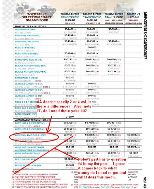

350 sbc, 700R4, 3 speed TC questions: Fairly technical and long I think?
I've got a new project coming down the pipeline right now and I'm working out the details of my game plan right now.
What is in there right now is a tired F with a worn out 3 on the tree. I want to build up a very nice driver that is easy for the wife to drive. I've did some research searching threads and looking at the tech links and have pretty much determined what I want. Most questions were answered by using those sources of info but, I still have a few technical questions that remain.
I will list my questions, although because I am unsure of what I am talking about in some of the questions, they may not make exact sense to some of you (or me?).
I want to install a 350 sbc, GM700R4 automatic transmission, mated to the 3 speed transfer case using Advanced Adapters hardware. I know this has been done many times, but still have some odd questions. I want to install this in a 1965 FJ45lv wagon.
Questions:
1. Headers/Manifolds - AA lists Fenderwell Headers and Inside Frame rail headers. Are the inside the frame rail headers, "Rams Horns Headers", if yes and if this is what I want, do I need additional exhaust hardware to install. Or the exhaust shop will take it from the Headers?
2. 3 speed transfer case, can that be converted to a mechanical lever vs the vacume? AA has some P/N's, 716024 ($20.49) and 715521 (47.81) on page 57. Would this be what I need? If not, do I still need those parts for something?
3. Yoke kits from AA for additional clearence, needed? If yes, I've also heard Downey off-road mentioned in a few threads, anything to that?
4. AA tranny/TC kit # 50-8901, note #1, "this kit uses a 2 wd output shaft, 6" stick out" Anything I need to know about this? Ordering a tranny or from AA?
5. In several threads people have mentioned to tell AA what your doing so you get the right Flexplate? What is this, starter gear right? What do I need to know? Do I get it from AA or autoparts store?
6. Tranny cooler, anything I need to know?
7. I read in a thread recently that someone wrote, "Saddle moutnted V8 outdated". Is this what AA sells, I was planning on getting there mounts, something better or this is it?
This is the order I have figured up out of the AA catalog for things I need to get from them:
Motor Mounts P/N # 713124 - $126.36
Exhaust P/N # 717011 - $232.22
TC X- Member P/N # 726022 - $157.07
Tranny / TC adaptor P/N # 50-8901 - $683.00
Yoke kit P/N # 716370 - $178.00
700R lock up by pass kit P/N # 24-700r - $179.00
8. Now, this maybe is right or wrong based on your answers to my questions listed above. Also, does not include the P/N #'s listed above for the transfer case, assuming I need them? If it looks good, let me know?
9. Also, are there any AA dealers or other outfits I should be looking to get this stuff through. I realize that sometimes the manufacture has a retail price not to undercut there dealers, anyone place out there you guys recomend? Or is ordering directly from AA as good as it gets?
We'll I hope I didn't create more questions here, Thanks, Matt

When I order the 700R4 should I be ordering one that is specific for a 4WD? I'm not sure what AA is implying with that note #1 in there catalog?

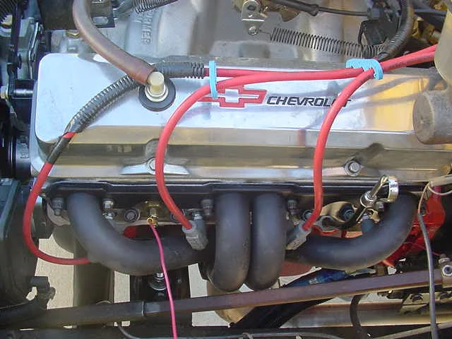

Questions:
Inside the frame rail they use block hugger headers. Exhaust shop will take it from there back. See pic below.
Starter gear ... yes ... that bolts to the crank flange. Flexplate comes in 153 and 168 tooth. You want to be sure you match up the plate you're using with the proper starter and bolt pattern. Up to 1986 bolt patterns are the same. 1987 -up switched to a small pattern.
Yes ... parallel plate coolers are more efficient than tube & fin designs.
Hmmm. I've seen several saddle mounts for H**PS but not for cruisers. I'm not sure "outdated" is quite right but there really is no need to use one. More stuff to get in the way .... axles and exhaust pipe.

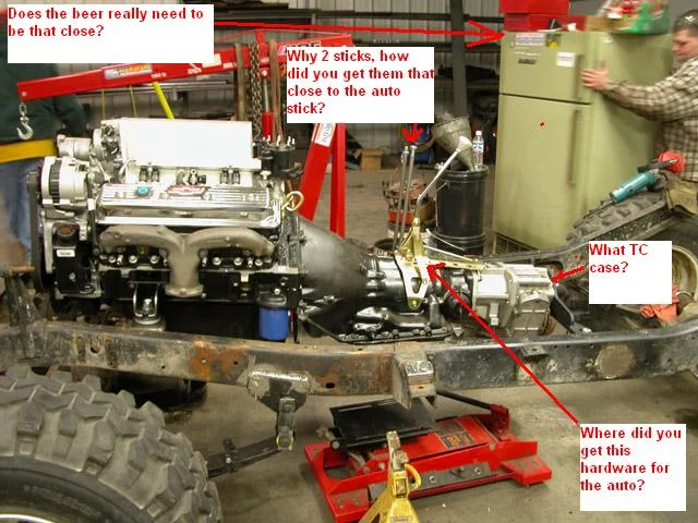

Garage
Pic of AA engine mount...
Rams horn manifold....
This is a little project I have going on at my place...
There are more pics out HERE

Steve,
What TC case? Hardware on top of the auto, Where? What auto? How did you get the TC hardware next to the auto shifter? Why 2?
Looks like your gett'n it done, I like it, nice.

HEY! Poser if you used the mounting point under the AA adapter would the transfer case of fit in with the stock cross member still in the frame ,or would you still have to remove the stock crossmember to fit it in . i would like to put this setup in a 40 also
Jake

AA's tranny kit page.
click here if you can't read it very good.
http://www.advanceadapters.com/catalog/063.html
same page

See if I can answer these.....
That fridge was moved from there, as it did not fit under this...
Twin stick info can be found here...
http://www.advanceadapters.com/catalog/060.html
Why two sticks? If you have to ask....
So that 4WD and range selection can be performed seperately...
I just modified the bracketry for the Lokar shifter, and the AA stuff to make it line up..
T-case is a four speed unit that has been gone through...
Oh, and NO the tube cross member had to be removed, as it was in the way...
LOKAR makes some very, very high quality products. I have recieved nothing but great products and great product support from them over the years...
Hope this helps some...
Good luck!
-Steve

Another question, what motor are you using, looks like an LT1?
Thanks, Matt

RamJet from Fridley Chev...
Can also be seen here...
http://www.paceparts.com/index.asp?P...D&ProdID=17811
