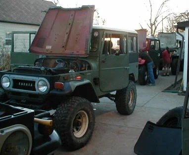

Why don't you post that shot from last week of 4 cruisers (FJ40's) in your driveway all with the hoods up. Oh and your 60 in the back. It was kind of nice watching Treeroot work on his rig instead of him watching you work on his rig!

Quote:
Originally Posted by Romer
Ige,
Why don't you post that shot from last week of 4 cruisers (FJ40's) in your driveway all with the hoods up. Ken
here ya go

nice pic! my junk right in front.
swing down to ige's on a weekend when we are workin on our junk.we can help ya out.

and you can see it peeing in my driveway
shit! was hoping you wouldnt notice
