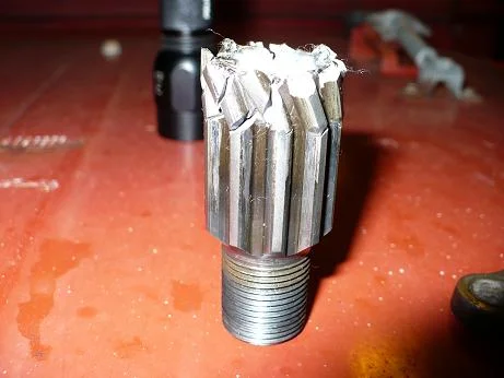

All this talk of upgrading the front, and I break the back. Went to give the neighbor a ride around the block, and I punch it and all hell breaks loose. Best I can tell, the pinion sheared off at the driveshaft, fell into the diff and locked it up. In the process it punched through the case. So I'm skidding down the street dumping fluid. Had to use the jack and 4 neighbors to get it back into my driveway. Time for a beer.

Been there done that, just on a little hill. Do you need the housing/pinion etc? I have some extra but your likely to find them closer than Florida.
There will most likely be a wrap bar in your future!
Pinion look like this?

No wrap bar (isn't learning fun?). I have a line on one here, thanks though. Guess I better do some antiwrap research.
