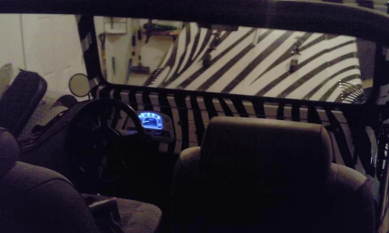

First post here so take it easy on me.
Found this at autozone and thought it would work for speedo lighting. AutoZone.com | Interior Lighted Accessories
Just cut the battery pack and switch off.
This stuff is really thin, I discoverd you can break or cut it to length and it still works.
It also has 3M adhesive on the back.

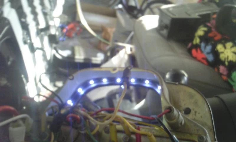

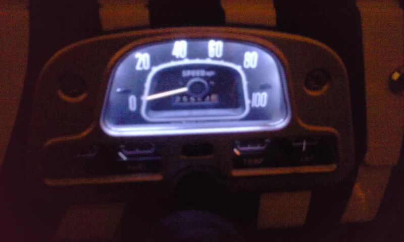

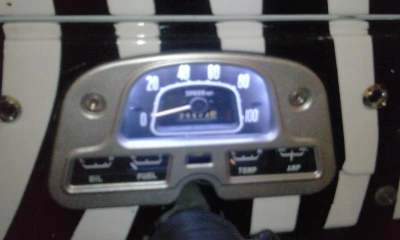

It is very bright at night. I guess you could cover portions with electrical tape to get the desired brightness.
Also the link is to a red version. couldn't find a pic for the white one.
My speedo is stock uncut.
I left the stock bulbs on and pulled power for the l.e.d.s from one of them.
No problems with passenger side glare either!
Might readjust it later to get the lower gages better, my main focus was to light up the speedo.

I broke off about 5", this left 10 of the original 15 l.e.d.s.
Cost was $19.99, expensive I know, but theese have a huge life span probably will never have to replace theese. If anybody can locate theese cheaper let me know I have some more things planned to do with them.

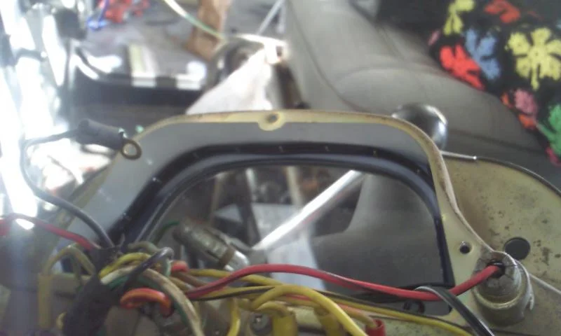

I also recommend warming it up a little before bending.
I found out you can break it if you bend it when it is cold out.
