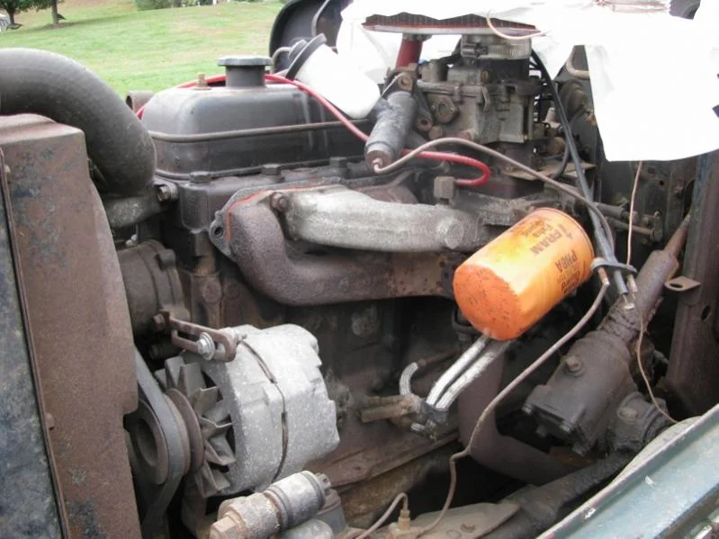

engine identification from 1 picture 1f or 2f?
I have committed to buying an old fj40, I have a picture of the engine. I know the fj40 was originally three on the tree and now is a floor shift. Current owner knows very little about it, does not know if it is a 3 or 4 speed. I am hoping someone can tell me if this is a 1f or 2f motor. It will be a few weeks before I can go pick it up, so it will be a huge surprise as to what I am getting. On my budget I get stuff that has 3 wheels already in the junkyard.

F, it isn't a 2F
Pressed steel valve cover and filter on the driver's side.

Thanks, I knew someone would be able to verify this till I can pick up and see for my self.

its an F, appears to be late 71-late 73 vintage.
what the hell is up with the steering column? its pretty much just a funnel for water into the gearbox like that?

This is a 62 fj40. CO (Current Owner) thinks the engine was swapped, not sure about the trany. Has original axles with the real goofy looking locking hubs, A serious pile of rusty parts, but I will try and bring it back from the almost dead. Once I get it in late November I will post up some pics.

Quote:
Originally Posted by cjgoode View Post
This is a 62 fj40. CO (Current Owner) thinks the engine was swapped, ....goofy looking locking hubs,.....A serious pile of rusty parts, .
the engine was swapped...thats not a 1962 engine...looks more like 70? 71?
as for the goofy hubs...and....box of rust....DO NOT Throw them out it may have quite a few things inthere that fj25 guys are looking for ...if you choose not to keep the stuff....or...it could just be crap

Youi might have a hard time driving it with the master cylinder connected to the carb like that...

Quote:
Rocky
come on now im pretty sure thats stock location .
