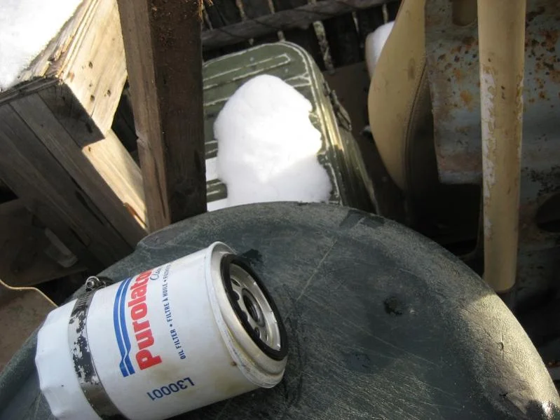

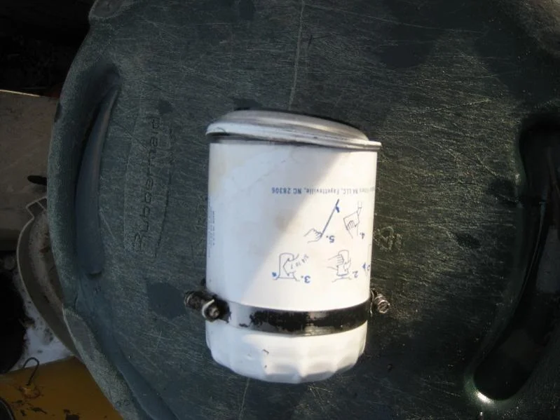

First one was a STP, second was a purolator. Both blew the rubber seal out on different areas of the circle.

Nope. Not it.
I got a perfect remote filter mount from a mud member. It was clean when I mounted it to the intake manifold.
Brand new STP oil filter.
The first second and third time I pulled the filter and cleaned the oil off and reseated the O-ring.
Then I went to another store and used a different book and got the Purolator. It did it with in the first seconds of crank over.
I am kind of thinking on the return line somewhere. The arrows on the mount point the oil flow. I know the pump is pushing oil.

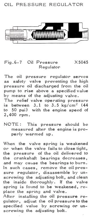

Everything you ever wanted to know about, what I know about, the oil regulator. Oil Pressure Regulator

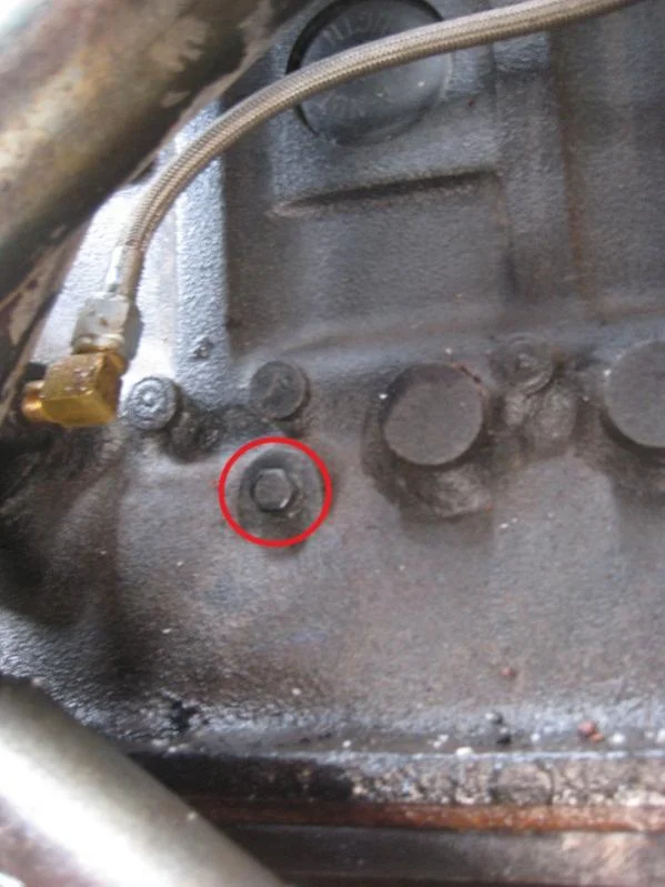

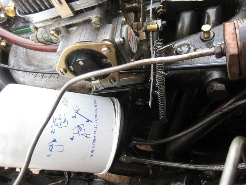

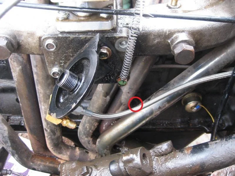

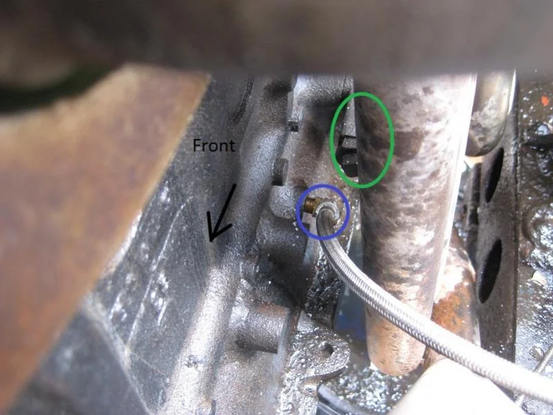

Can someone tell me if the return line is in the wrong port here? Looking at Coolerman's pictures it apears that the oil return line is behind the regulator. Mine is in front (blue). There is a bolt (red) behind the reg (green).

I switched the return line. The hole the line was on still enters the crank case. I checked with a soft thin wire. Checked the other hole with the wire as well.
I pulled the pressure regulator, cleaned it up. Really was not bad the piston slid right out. It did however slide back in easier after cleaning.
I flushed the case with diesel. First I drained the oil. Then I poured some through. Then I filled it with diesel and cranked the motor with just the starter no coil. I then took the return line off the brass angle fitting at the filter mount. As I was cranking the motor with the just the high gear starter I was getting a very slow oil/diesel mix from the return line. I mean slow. My buddy talked me in to thinking that was because without the higher RPM's, pressure and the cold oil that it was just slow.
I then drained the diesel and filled with oil and most of a can of seafoam. Started it up, the auto choke was having a bit of a hard time getting it up to idle (it was 40 degrees today) I was tapping on the throttle for about 10 seconds as it was trying to catch an idle. A second after reaching a good idle,
VVV THIS HAPPENED VVV

So high pressure at the filter slow return???
On the mount inside the threads for the filter is the return flow. That hole in there is tiny. My guess is it needs to be for pressure further along??
For this pressure to affect just the filter and not the dip stick or rear main seal would rule out bad rings.
The flow of oil has to be obstructed hence the engine flush. The pump is pumping and it is reaching the filter. Past the filter seems clear. The FSM tells of how the return showers the crank shaft.
If the splits before or after the split for the oil filter is blocked would that cause a back up of this much pressure?

You haven't mentioned adjusting the pressure relief valve settings on your regulator. Have you tried unscrewing it to reduce the pressure in the system? If it's set too tight, the valve won't open, of course, and you'll have just the problem you're having.
The relief valve operating pressure is supposed to be 44 - 50 psi at 2400 RPM at an engine temp of 176 F.

Quote:
I did not know this could be adjusted. Its the large bolt on the end? It moves so easily seems if it was not set all the way in it could rattle loose.
My understanding of the Pressure regulator is it stays closed to lube the bearings then when the proper oil pressure is reached it opens the flow to the filter. If it is not open it would not reach the filter right?

Yes, it's quite adjustable.
There is a hexagonal lock nut on the end which, yes, should be tight. But the squarehead bolt that goes in from the front can be screwed in and out, which adjusts the spring tension which then determines when the relief valve opens.
Oil coming from the pump goes through the regulator to the oil filter, but if the pressure rises above the spring tension the relief valve opens up to dump oil back into the oil pan.
Unscrew the bolt after loosening the lock nut and you'll reduce the pressure in the system. The best way to know it is right is to attach a real pressure gauge in the hole for the pressure sensor and adjust to the settings specified.
But yours is almost surely set too high.
From the book:

I suppose it's also possible that the relief valve cap/plug thing (on the right side of the spring in the figure) is simply stuck or glued in place, but if you had it all apart and it wasn't, then maybe that's your answer.

I did not know the square bolt and the hex were separate. They are flush since I've had it.
Where can I get a gauger to check it with? Is this something I can rent from autozone? Is it going to have the right thread to attach to the reg?

Are you absolutely certain you have the return line in the correct port? It is making me wonder if you have it tapped into the oil pressure sender port. It's been so long since I had an F engine I don't remember where the lines went. It is so unlikely the relief valve or oil pump are at fault, I wouldn't waste any time on them until I was certain I had everything plumbed right. Remove the return line from the block & see if you even have any flow out of it. At the same time, you can see what's happening at the block port. Find a running rig for comparison, if you can. If you can't, check out SOR. Maybe their illustrations can help. Another horrible possibility is the engine was not assembled properly & something internal is not kosher, so, rather than spinning the engine with your starter, pull your distributor & get a friend to spin the pump drive, using a drill & a hacked off screwdriver blade. That way you can pull each line off & try to locate where the blockage is without turning the engine.

Quote:
Yes I am now sure the lines are right. I compared to Coolermans pics and the mount has arrows of flow casted in to it.
I do not see a need to spin the pump without the starter as it only has two external lines.
Blockage is my worst fear. The FSM describes the oil flow from the pump to a split one to the "oil hole" and one to the filter. The "oil hole" splits it to the crank and cam, it then splits again to the rods and rockers. If there is blockage further along the first split would that increase the PSI at the reg and the filter??
I think I am going to NAPA to get a test gauge and a few filters. I will start by backing the regulator adjusting screw 1/4 of the way out?? Too much? Too little? Is this just going to be trial and error till I get a working PSI?? Any other tips for adjusting the regulator?

The return line is not clogged. I held the tube to the light and could see right through it. I pulled both brass fittings and checked them. I poked the port on the block with a wire and it was clear and the wire went in to the block 3-4 inches. Seeing the tiny hole in the very center of the filter mount that the oil returns through it is unlikely that anythng passed that point to block return flow.
The problem resides in a build up of pressure before the filter. So the regulator is not adjusted right or further up the other splits is blocked. Right? ? ?
