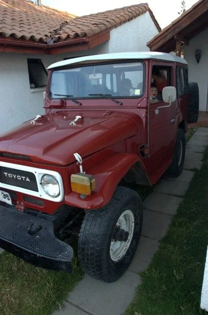

For those who have restored vehicles, what are the primary points of interest that I should look at? My goal for this truck is to restore it to a great degree of trustworthyness/asthetics while at the same time modernizing key points such as putting OME suspension on it, upgrading seats to Paradrive Rally or similar, new paint, redo all rubber seals, upgrade the instrument display, put some thermal shielding between the engine/tranny and flooring, etc.
Here are some pics of the truck as is in my driveway.

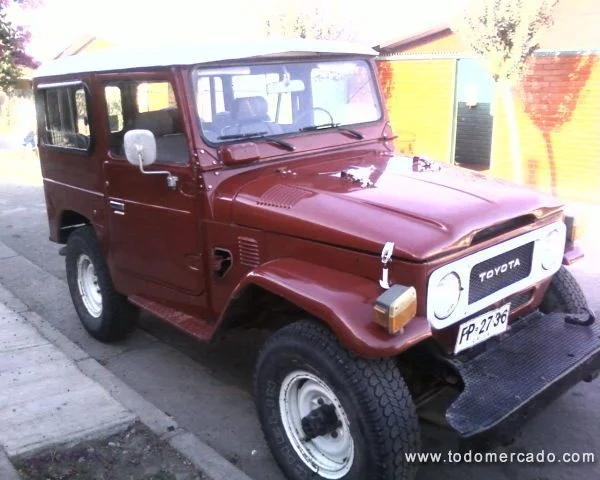

More pics as taken by the previous owner prior to sale.

Looking at this picture. If you hadn't said Chile I would have place the truck in the desert east of Palm Springs. Extremely similar.
I'm not sure you need to "restore" this truck. It's fine. Just do preventative maintenance on it, upgrade as your heart desires, and enjoy. Very nice rig.

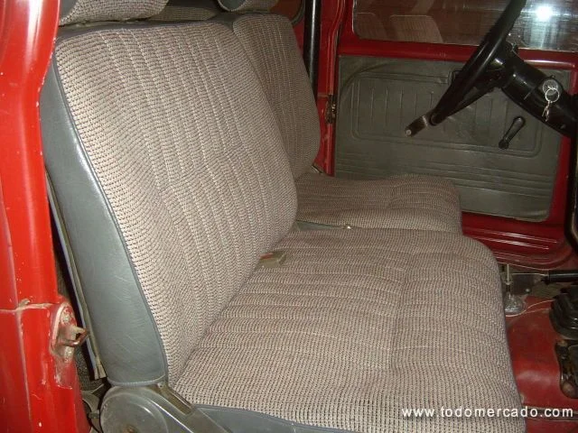

in that part of the world they did get cloth covers in some models ,covers could be oem
Quote:
Originally Posted by 77cruiser77 View Post
You have great seats aside from them not being stock covers. Put stock covers on them and they'll look great.

Love your cruiser. It is very original (unmolested) considering its age too.

Looks like you've discovered how much kids like the FJ40's! Mine too.
Also looks like you have factory power steering which is very desireable.
I agree with the above comments that you should make it mechanically sound and then drive it a while before you start making "upgrades." If you do swap out the seats, let me know, I'd love to have them.....

I would assume this is a South American production FJ40.
Something funky about the way those fenders are sitting.

Yeah, I think there's some fender damage.....and maybe some minor dents on the front side of the hood, too.
