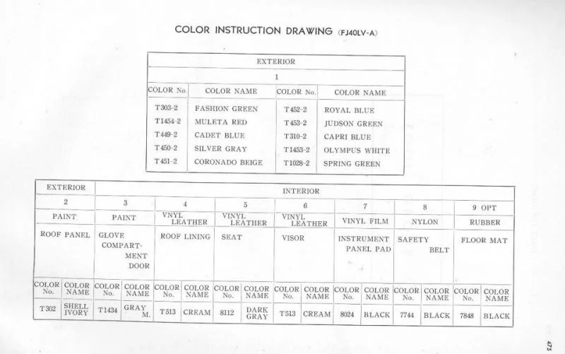

there is a color code chart posted here somewhere from 1969 found it
and it says the code for the glove compartment door is
T1434 grey M.

"T1434 grey M." is apparently unobtainium, but someone here on mud said that T145 is somehow related (crosses to Sherwin Williams Ash Gray Metallic)- so I've got a can of that en route.

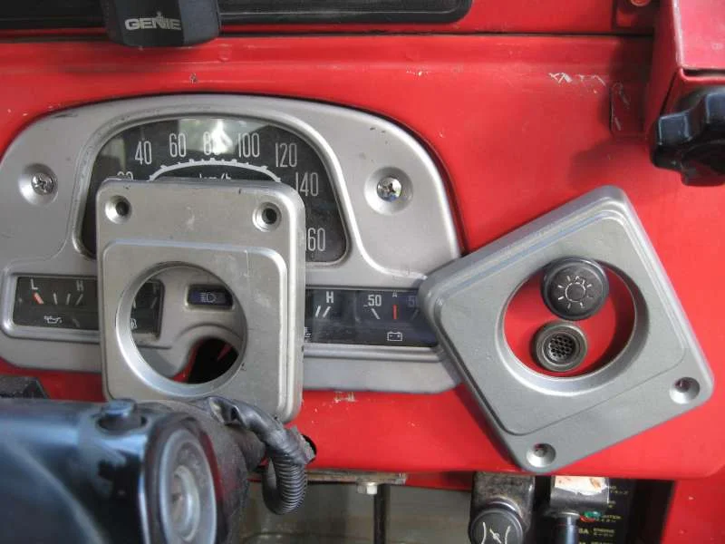

I just went through this and quickly gave up trying to get the original colour mixed up as no one had heard of it or could get any info on it. Took a sample and got it matched by a paint business that deals only in car paints and does matching on a daily basis and here is the result. Ashtray cover is the matched paint, glovebox is original.
By the way bare metal is a very close match to it shade wise, metal is just slightly brighter.

rockcrawler.....very nice match.....looks great!

Well, I got my can of T145, Ash Gray Metallic. Its pretty damn close, but not a slam dunk - part of the prob is that I sprayed it so thick and there is so much orange peel, but it might be slightly too dark. I'll respray and see.
The painted part is on the right, hanging off the headlight knob.
