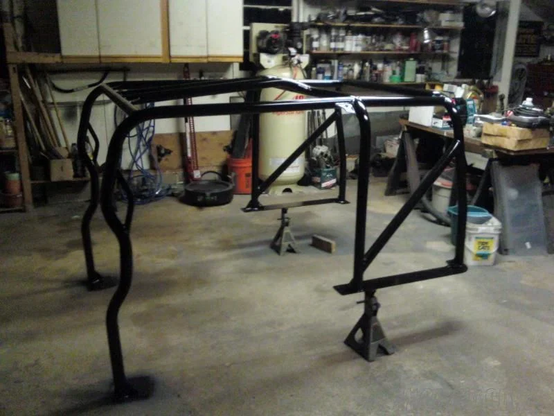

Couldn't find the answer about how much paint when I did a search, but figured it out last night. I used two cans of Industrial Rustoleum gray primer and two cans of Industrial Rustoleum glossy black. Each can was just under 16 oz. There are certainly more abrasion (tree limbs, birds, etc.) resistant coatings, but for the initial cost and touch up factor, I thought these cans worked really nicely.
This thread also delves into installing a Metaltech Cage into an Aqualu Tub. I altered the title to reflect the content a bit better.....and help others down the road.

Looks nice. I'm painting my stock rollcage the exact same color this weekend. Going to POR-15 it first, though (if I have any left from painting the tub).

the nice thing is that you can touch it up, just a little quick spray

Did you weld it together yourself or did you buy it pre assembled?

welded it myself.
I have read about the pre-assembled units as well as some critiques of Metaltech for not sending out directions with their kits. The truth is that a pre-assembled unit or directions would not have helped me at all. I am running a Aqualu tub and the rear sill differs a bit from the stock tub. My friends and I had to abandon our use of the stock mounting holes and placement of the base plates. Everything fits, but within 1/2 inch of door frames, rear quarters, etc. Anyway...Took a day to tack everything in and another half day for gusseting, cleaning the weld areas, degreasing...final welding took 90 minutes.

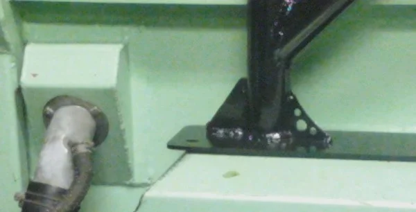

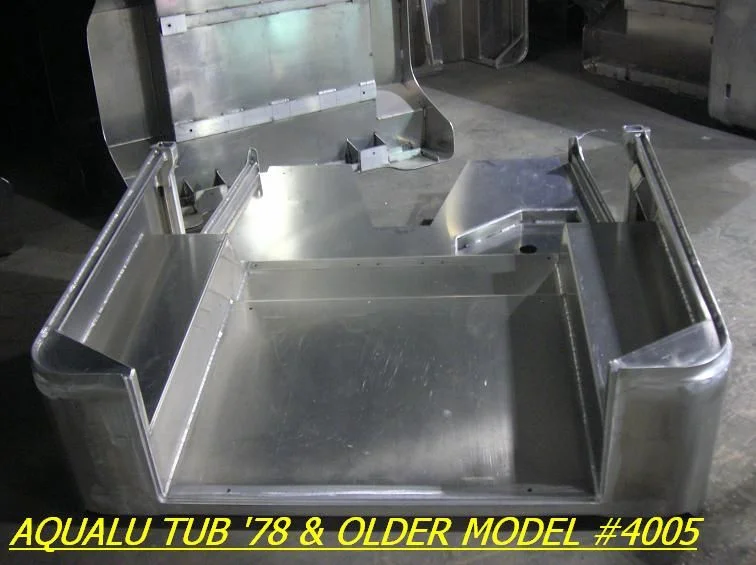

As for fitment...the Metaltech family cage will fit an Aqualu aluminum tub, but the rear sill plates cannot be used with the stock holes as designed. Well, they can, but you may not be able to remove the cage if you weld it in place. The rear quarter panel on an Aqualu tub has a triangular edge on the inner panel. This overhangs the wheel well by approximately 4 inches, and causes an overhang over the MT mounting plate by about two inches. To mount the cage you need to move the mounting plate forward towards the firewall and overhang the wheel well by an inch or so. This area of the mounting plate can be cut back to the edge of the wheel well.
The overhang is shown in the pic. And before someone notices...the dissimilar gussets are just that. The one on the left is for strength, the one on the right is for tie downs. I have also attached a stock photo of an Aqualu tub showing the overhangs.
