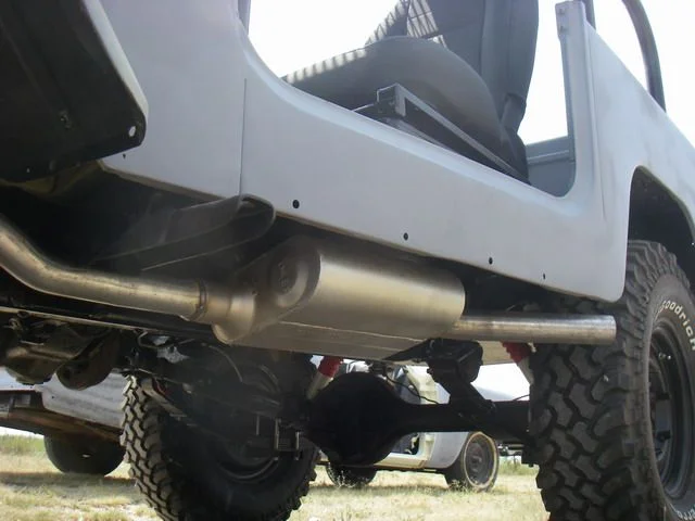

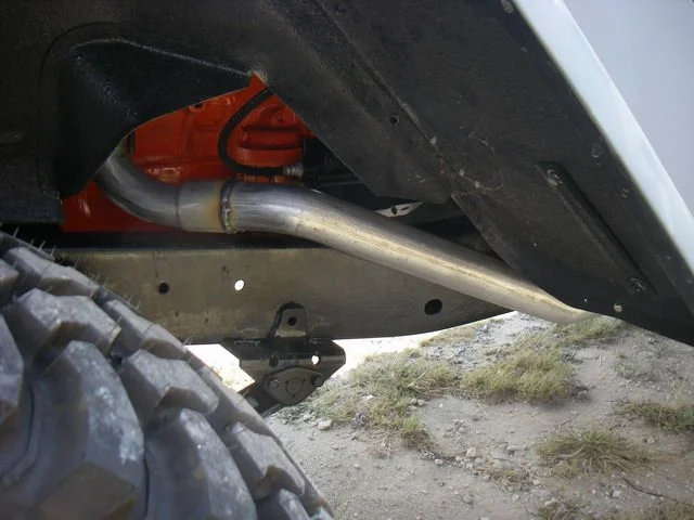

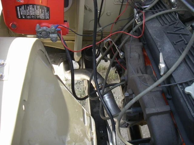

PO had already hacked the frame step brackets. Cleaned it up by using 3" pipe ripped in half. Might not be the best design for rock krawling but works well for me.

Your gonna have problems with the battery that way and not really a fan of those post conectors,however it is a clever way to mount it at least turn it around so if it falls it wont short out on the fender.
