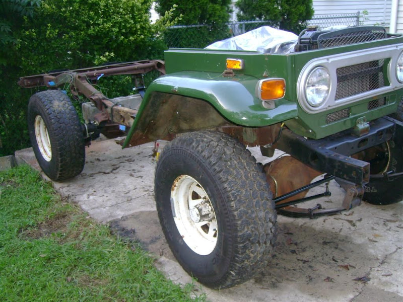

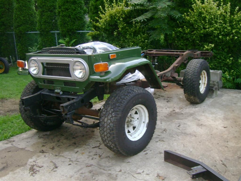

this is what i started with..

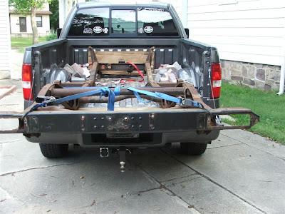

got them serperated today...
here is the body all wrapped up on my little trailer.
__________________
74 FJ 40 - just starting............

well i pulled the front fenders and grill off of the frame the other night, thanks to aaron for lending me a hand.
also over the weekend i tore apart the 78 front axle i got for the disk brake parts. now i just have to clean it up and paint the stuff.
that is it for now.... just waiting for my headers to get here so i can fit them and then i will pull the motor and axles off of the frame and send it to get blasted.

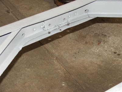

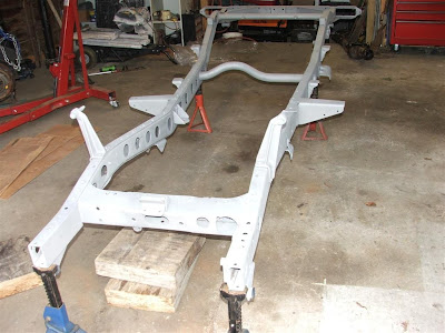

well i was able to get the frame stripped down and off to the blaster. he got it back to me the same day. WOW that was quick work..
anyway I got it all sprayed with etching primer for now while i do my welding and fabrication on it.
waiting for my 4 speed bellhousing and rear cross member to come in. once i get those i can drop the motor in and get that all finished up, then pull it back out and paint the engine and tranny.
still need to get new bushings for the front motor mounts. i also need toget new bushings for the front and rear shackle mounts.
i pulled out the rear frame support that connects to the side framerails and rear cross member, it was messed up so i am gonna replace it with thicker steel. need to make a run saturday and pickup what i need.

off to the sandblaster
frame all blasted..
rear cross member i pulled out.

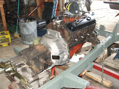

well i got the frame set level in the garage and also got the front motor mounts bolted in temporarly.
waiting for some parts..
also got the engine cleaned up pretty good.

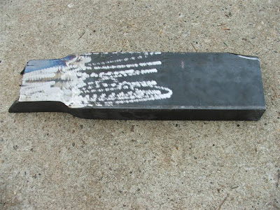

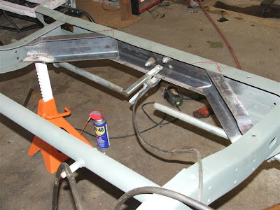

went and picked up the steel for the rear cross member and my bumper build. got the rear cross member all fabbed up and welded in. actually looks better then factory and def much stronger. also got the motor and tranny mocked in place. rear cross member bolted on and also got the tranny and t-case and bell housing bolted up to the motor. rear cross member is all welded in place also and the scab plates for the AA rear cross member are welded in also.
part of the rear cross member.
new rear cross member.
motor and tranny sitting in place.
Sun:
on sunday we just finished up the welding. now i need to grind down all of the welds and primer all of the bare metal. oh wel also got the axle back under it to make it a roller again.
plan on putting the body back on to make sure everything clears before i paint the frame. only thing i am relaly worried about in the sterring shaft clearance on the header.

well this weekend we got the body put back on the frame to make sure everything fit..
had plenty of clearance for the steering shaft by the header which is what i was really worried about...
shift is a little close to the heater but we may heat and bend the handle and also maybe get creative with the bottom of the heater... not sure yet...
front motor mounts were welded in place now onto the rear mounts. drive line angles look goo so far..
took the body back off and put it to the side for now. once the rear mounts are welded in place it will be time to paint the frame and motor and trans...
