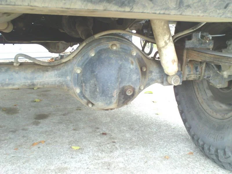

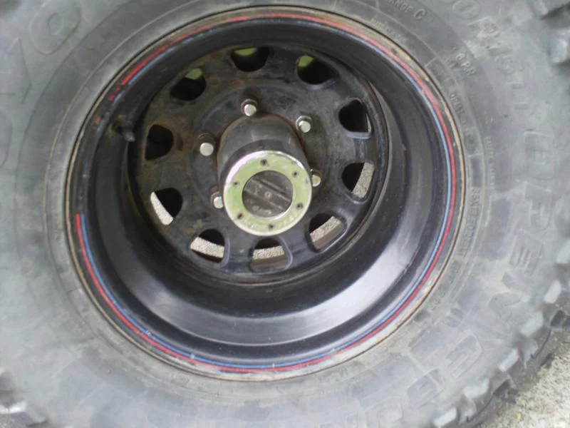

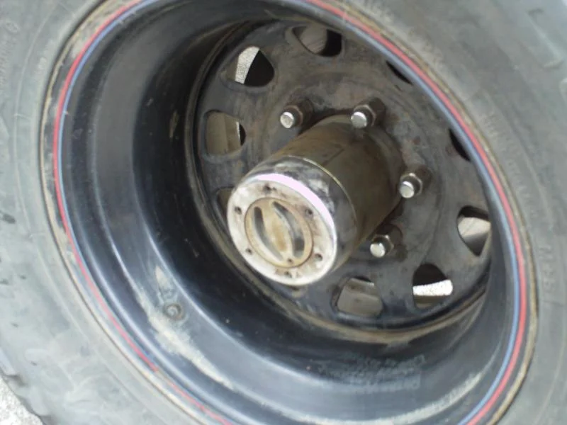

Pictures speak louder that words do. And my terminology in this case is lacking.
The two hubs are different since I broke one on Rubithon. In the market for another single hub to match the premier warn hub. Then I will just keep the other as a spare.

From those pics it sure looks like a Warn rear full-floater conversion.
I've read of guy with the factory Toyota full-floating rear axles having trouble with the hubs while running autolockers like the Lockrite, Aussie, etc.
Head on over to the "Diesel & 24 Volt" or "70 Series" section and look for Wayne from Ontario (aka Crushers) He can explain these problems a bit more in-depth than I.

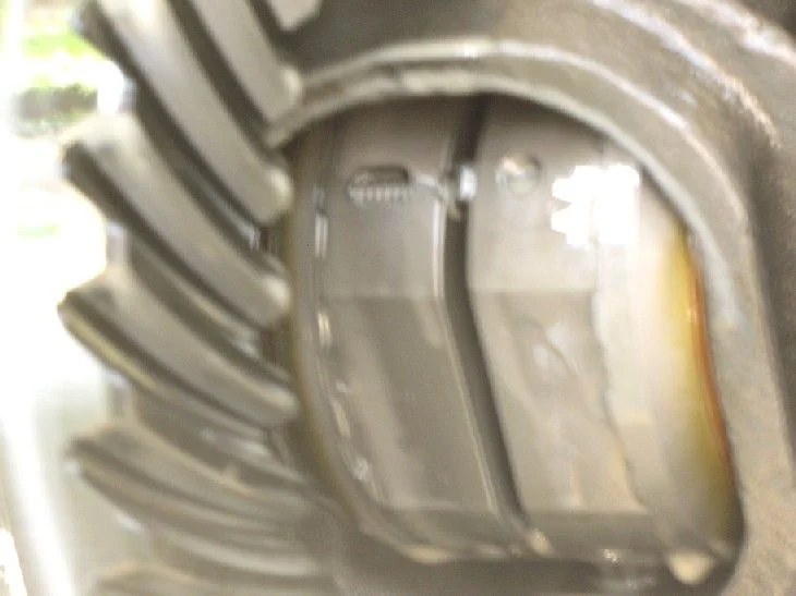

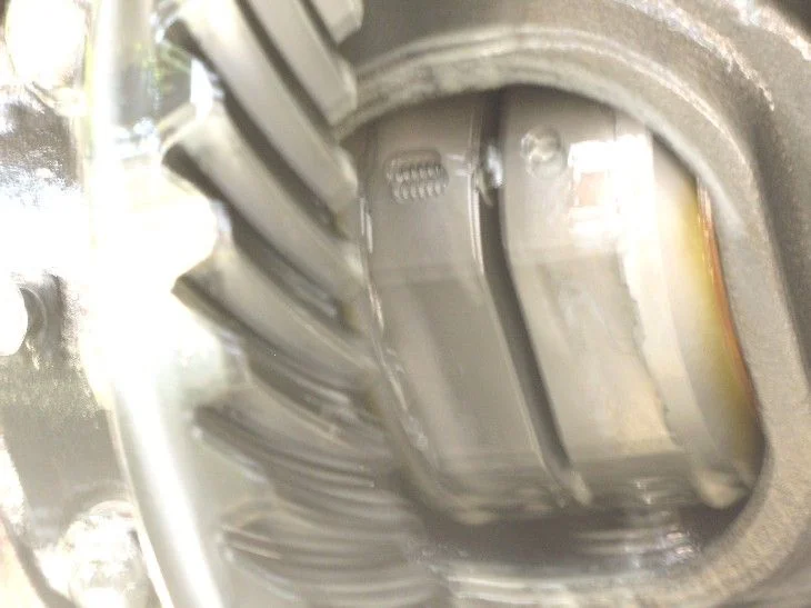

So, I found the culprit. As you can see one of the pins has broken off and wedged itself sideways preventing the locker to release. Hopefully the locker isn't trashed on the other side as well.
There are some small scaring on the left edge of the pin. Will that matter? Sorry the pics are a bit blurry.
also where is the best place to get additional springs and pins. I guess i should change them all and keep the old for backup. Comments?
Just curious...what are the reasons for this to happen? The locker is about 7 years old and has seen some heavy wheeling.
When I remove the locker I will take some better pics...

Looks like junk to me...
Time to upgrade.

Yep, that locker is toast. Mine died in a similar fashion after breaking one of those little pins. I replaced it with an ARB and am so much happier.

Glad you found it its toast get another one or up grade.
