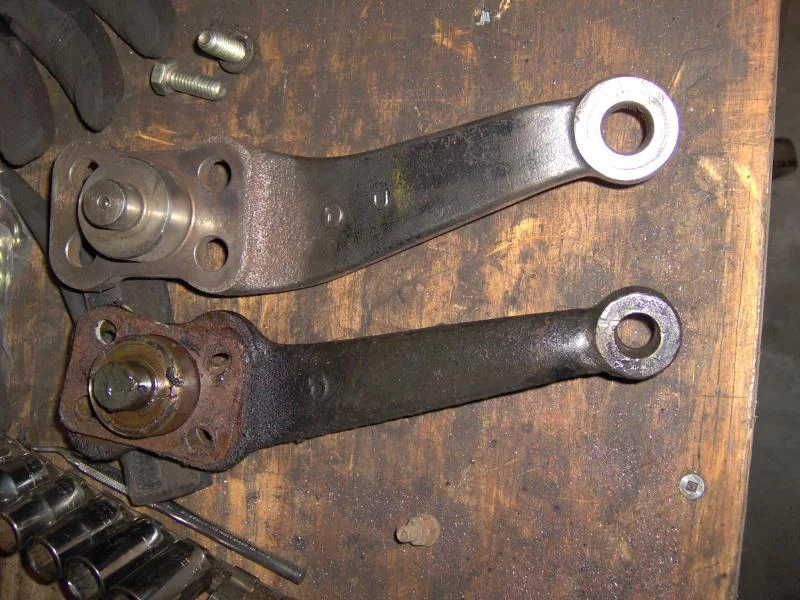

I just installed my new used fj62 steering arm on my 40 and it looks good. My problem is that with my wheels back spacing it rubs on the tre boot and destroys it.
Question is...should I heat and bend the arm in a bit or get some of the wheel spacers(1") and install that and not bugger up the steering arm. I already have a 1/4" spacer on currently.
Are the wheel spacers that we see on adverts. any good? Strength? If the spacers are the way to go do I need 4 and include the rears or just have the front done?
Just a tid bit...when I installed the new arm the toe in was out by 2+ inches.

Check the cast marks under the arms again, on mine they are marked L and R. If you had them reversed it might make more room for the tire but your steering would most likely be whacked.
I am running 10" wheels with 1/4" spacers and it's close, I think my rims have 3.75-4" BS
It sounds like you have two left arms from your first post, and I don't think they are interchangeable from left to right, from 60 to 62 probably.
