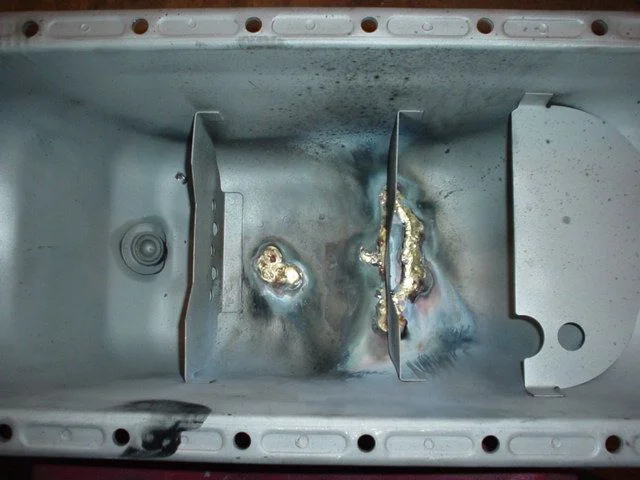

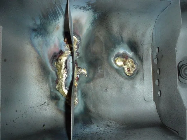

I brazed mine. It has worked out really well, so far. Then I filled up the "seam" between the skid and the pan with some RTV-type stuff so mud and dirt cannot get in there.
