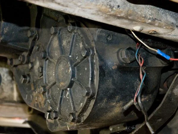

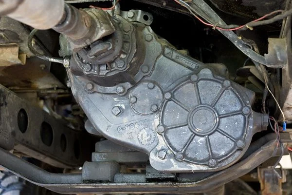

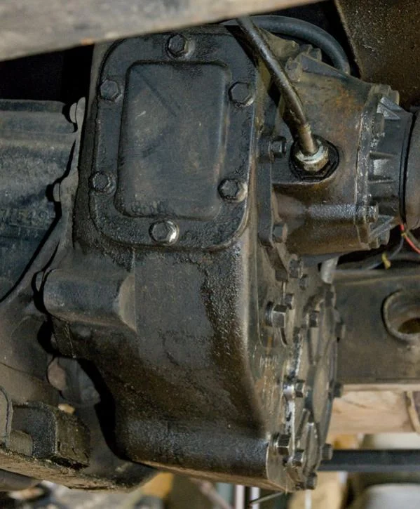

| Help ID my transfercase I am looking for some help with ID on the transfercase that is in my fj40, it has a 1967 283 SBC with a SM465 tranny, T case ???
the shift pattern is in line with 4H all the way back then 2H, N then 4L all the way foward. Anny ideas? |

| Im not sure but I think thats a chev 205.The crossmember is definatly chev. |

| X2- NP205 case

| I am 100% sure that is a New Process 205, the best factory T-case ever put in a light truck. The only problem is it only has a 1.96 low range. They are indestructable.
How does that line up with your rear diff ?

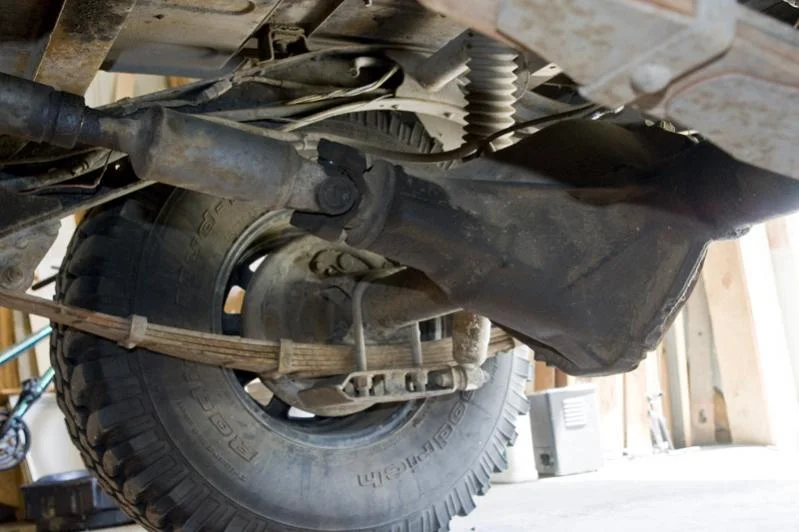

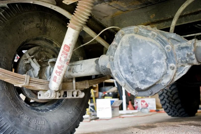

| Thanks for the help, It does not have the orig rear axel in it so it lines up perfect, my next post is to try to figure out just what axel is in it. PO did not know. after that its putting in a parking break every now and then I wish I had one? |

| the 205 has that 3 bolt cover in the middle and the speedo cable is on the left side like yours .if you want more info just google chevy transfer case or np 205 and there will be more than you need to know good luck

| The rear end is 100% Chevy 12 bolt out of a 1970's to early 80's 1/2 ton truck. Preety solid rear end, c-clip axles like the FJ40 had in the rear originaly. Looks like the Toyota brake drums are still on it?
I suppose they put that in so the transfer case would work.
What do you have in the front?
