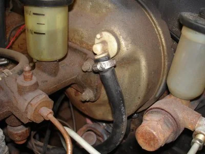

fj hunter's Avatar
Join Date: Feb 2009
Location: South Bend, Washignton
Posts: 337
is this the hose ...
and where is the flapping piece???

Old 06-27-09, 07:51 PM   #4 (permalink)
Site Addict
bsmith123's Avatar
Join Date: Oct 2007
Location: panhandle florida
Posts: 2,251
hose
No, that is the vacuum hose--- he is talking about the fluid hose down near the brake.
The most common thing for the brakes locking up after a few pumps is the master cylinder rod being out of adjustment--messed with that lately?
