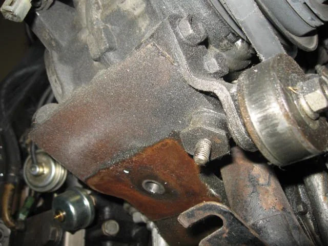

Hi All,

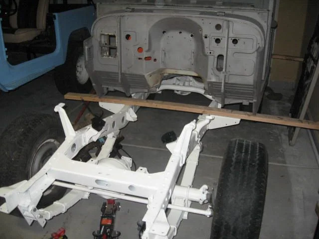

I figure I'd post some pictures up of this little project. I have a 1969 FJ40 I bought, tore down and am rebuilding.
It had an old Chevy 235 engine in it that I gave away to a Chevy truck guy for cheap. I found a 2F here on mud from Mule and am putting that in.
In order to get the motor in, I decided to keep the 3 speed and transfer case. Another mudder had a 3 speed bellhousing and motor brackets here in Phoenix (thanks John!)

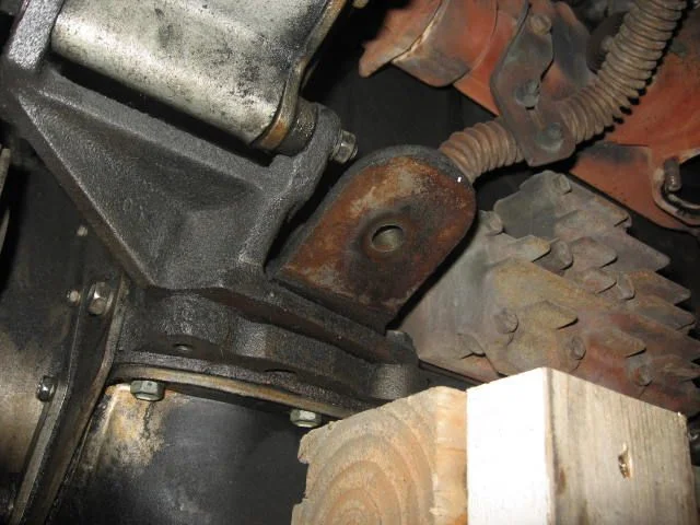

The front brackets from the 1984 seem to be in the same spot, but there is a difference in the motor mounts. The newer motors don't have the threaded hole on top and threaded post on the bottom. They have a flat top with threaded post and flat bottom with threaded post.
The picture below shows the comparison.

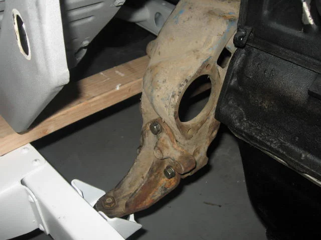

The 1984 FJ-60 Front Brackets

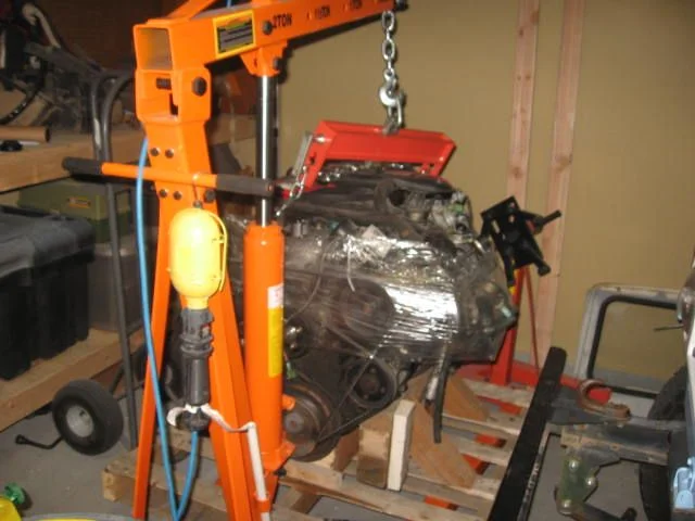

The motor (holding my hoist captive! )

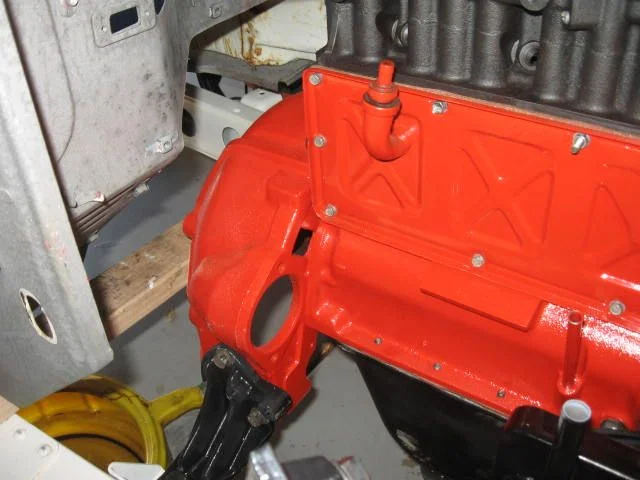

The bottom shot of the front brackets

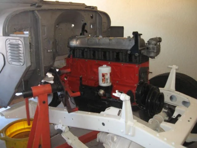

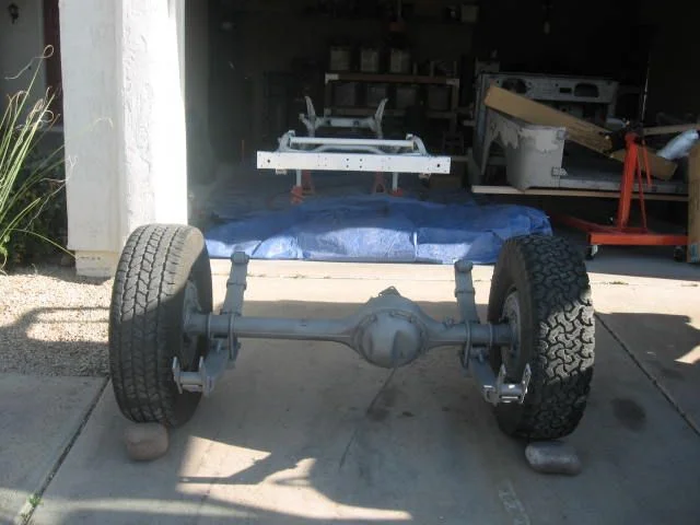

More Pictures
The frame after tear down, sand blast, and repaint.

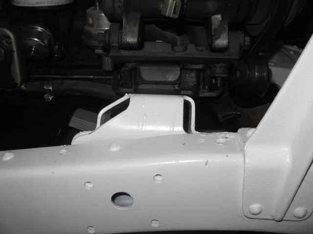

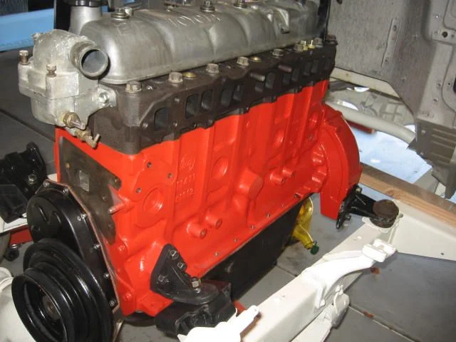

Found some of the new motor mounts for the front
It fits like a glove. (Thanks for the mounts Dave!)

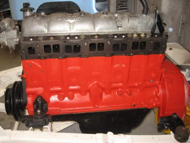

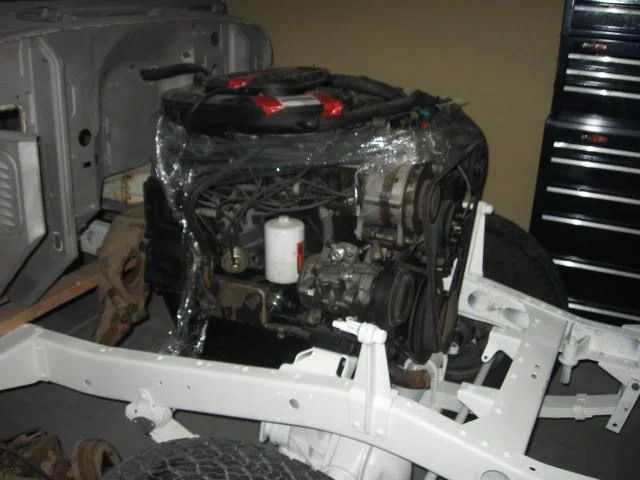

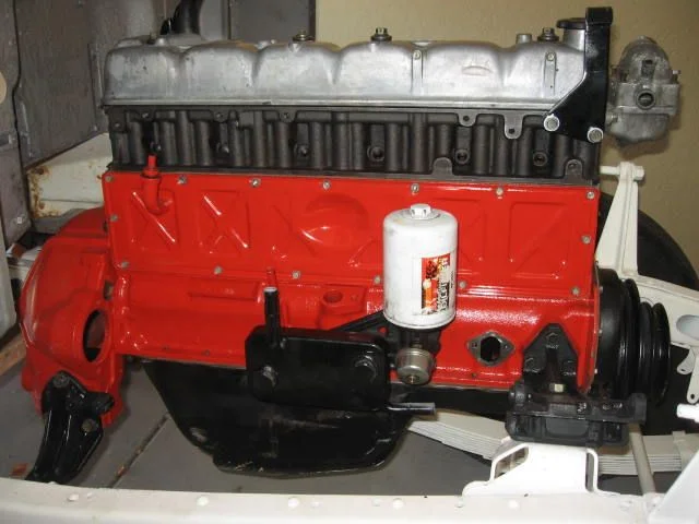

An update
Well it isn't 9 million degrees in my garage anymore, so I put this motor back together. I need a radiator, fan, and fan clutch. I'll be looking classifieds if anyone has parts and are in southwest, that would be cool.

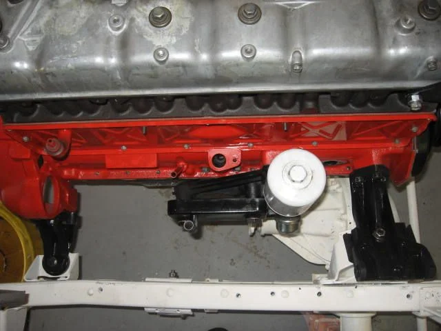

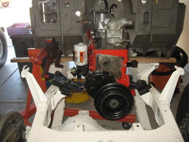

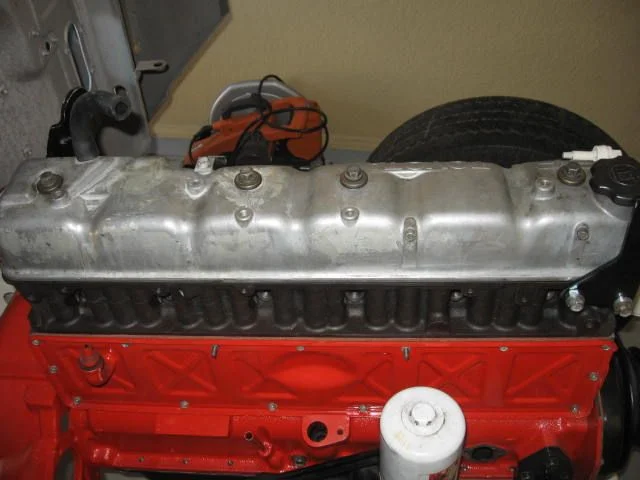

more
pictures

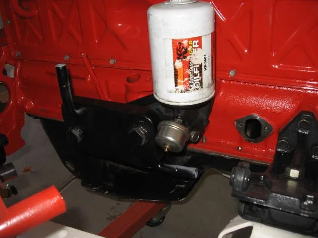

and more
pictures
