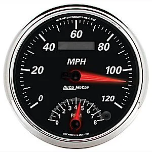

How about....

Thats exactly the idea, but somehow worked into the original speedo face. I've got some parts on the way to try things out - its a tough chore though, there isn't much free real estate on the stock face.

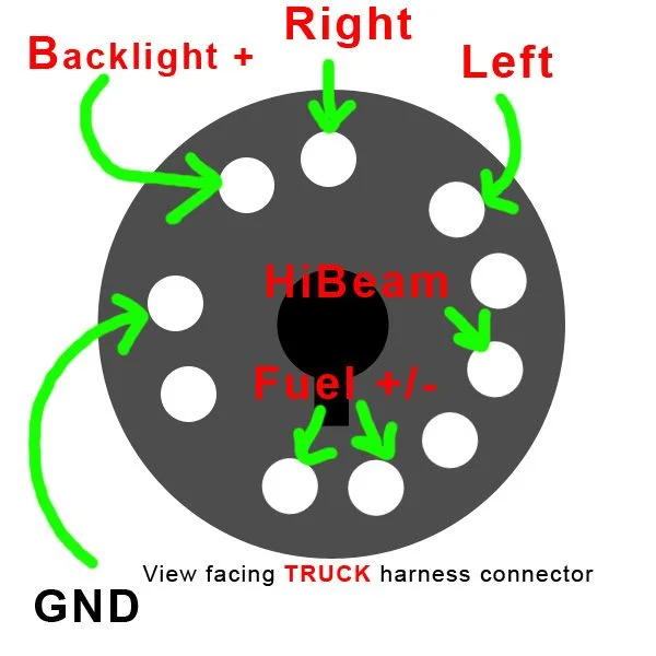

Are you Nick? I haven't sent many electrical sets to Australia recently, so I'm guessing so, which means you have a late-model truck with the three-post fuel gauge?
The three post fuel gauges are a funny little thing - they contain their own cheapo voltage regulator which grounds through a little copper tab poking out of the back of the gauge, which was designed to just press against the circuit board in the original cluster. On p12 of my instructions, there is a note to make sure that you bend this tab outwards a little bit so that it is pressing against the bracket when its installed - this gives it a ground path.
The behavior you describe is what would be expected if the gauge was not grounding properly. I'd correct that ASAP, as you risk burning the gauge or the sender as they're presently being overvolted.
Of course, for that tab to ground properly, you need to ensure the bracket itself is grounded as well - ensure that you connected the "Ground" terminal in the harness to one of the bracket screws.
If you did both of those, maybe sand the copper tab a bit, or the bracket, so ensure they're not oxidized and failing to make contact.
Nothing else it could be, really...

Any update on the speedo/tach combo? I need to redo my gauges (oil and temp don't work) and have already decided this is the route I want to go, but would like to add a tach at the same time.

No update, I'm afraid, and honestly it'll be a while yet. Pesky life/career have gotten in the way of my R&D efforts .
That said, if I can get the paint color nailed down, I'll have reproduction OEM tacho bezels with aftermarket gasser tachs available sometime before year end, though this will require the ever-unpopular cutting of the dash.

Got my kit the other day. VERY nice! One question though: Do you have a pin-out diagram for the wire cluster? I couldn't locate one in the instructions.
Cheers!
J

I'm not sure I know exactly what you mean... the barrel connector?
