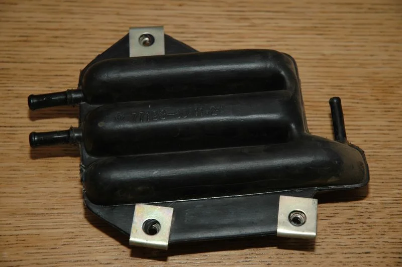

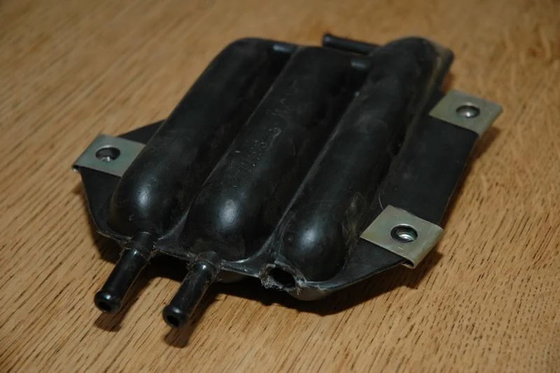

Does anyone know what this is and where i can get a new one?
Hey guys,
it's been a while since my last post but i just chased down a fuel leak and i have no idea what this thing is. See pics. i tried googling what appears to be a part number that you can see in pic 2 but nothing. any help would be much appreciated.
thanks guys,
db

I believe it helps with venting and overflow...I know this because when the hoses aren't connected and you fill up fuel spills on the ground. Technically...not a clue what its called

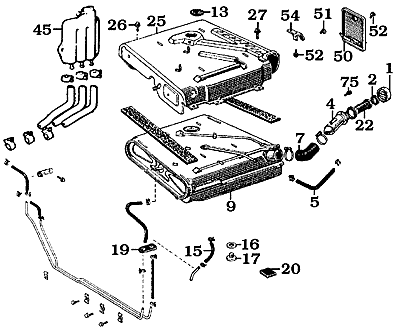

fuel vapor separator # 45
Specter Off-Road Land Cruiser Parts - Page 168 Gas Tanks

Looks like a part of the evaporative emissions control for the gas tank. I had a very similar part in my '69, although made of metal. It was attached to the back of the bench seat.
Pulled the below from SOR, looks like #45 to me.
EDIT: Looks like KY beat me to it ;-)
