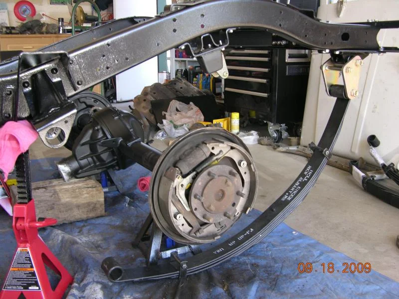

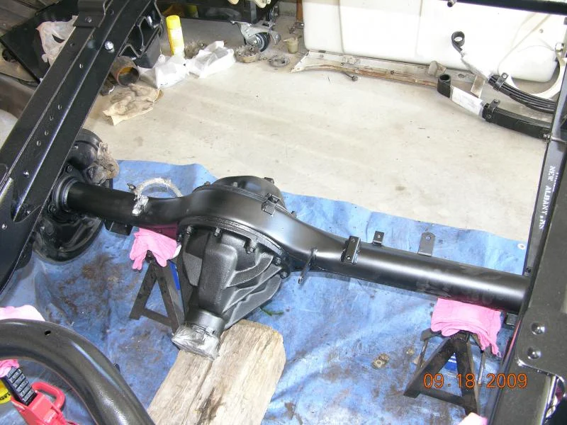

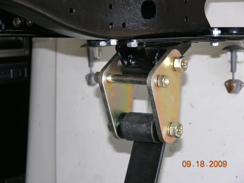

Ok it's been a while. Have the frame back after being powdercoated. Installed the new Man-A-Fre rear crossmember and diagonal gussets. Cleaned up the rear axle and painted and now I'm trying to put the rear axle back on to get it off the ground to do the brake work. I'm installing a Hell Creek 4" lift and anti-inversion shackles but Hell Creek only sent me 16 new bushings which I'm assuming are for the shackles. What is everyone using for bushings where the leaf spring re-attaches to the spring hanger and the frame? Thanks.
RattSki is offline   Reply With Quote

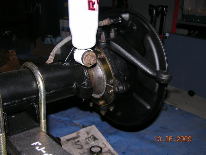

Old 10-26-09, 09:10 PM   #50 (permalink)
Forum Regular
Join Date: Apr 2009
Location: Boise Idaho
Posts: 40

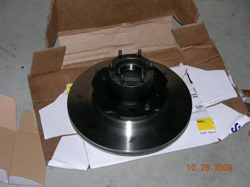

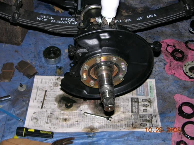

Putt Putt Puttin along. Almost finished with the front axle and disc brakes.
