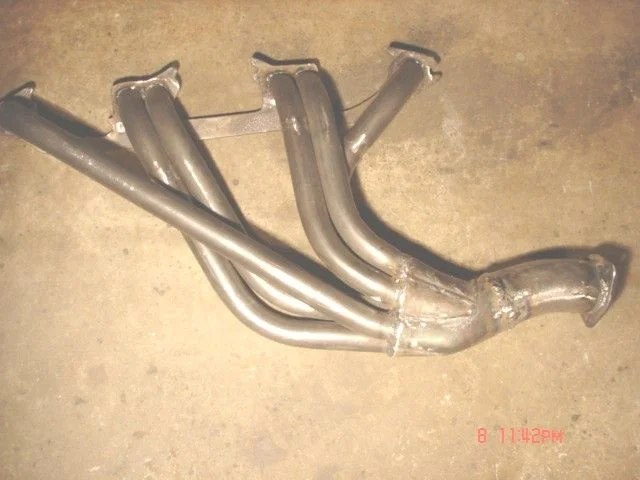

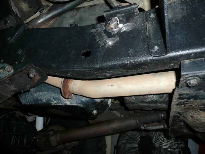

All the aftermarket headers set below the framerails, so you'll need to cut off the old tubes & bend up some like I did for my These set about 2" below the TOP of the framerails. Good enough for front link suspension placement.

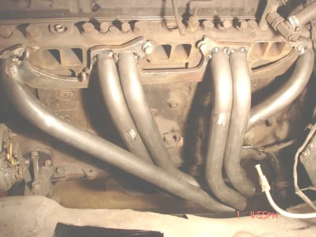

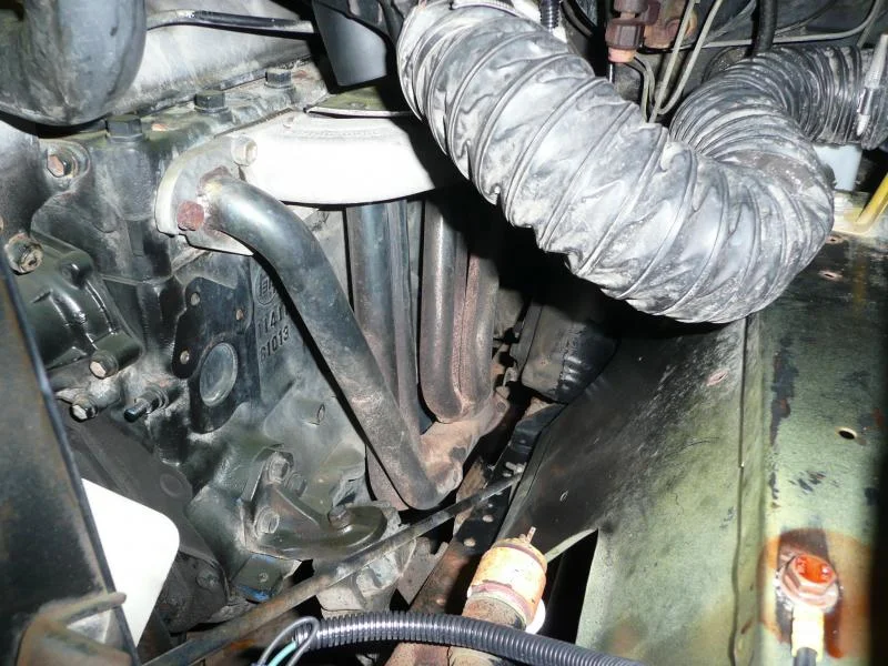

I don't know the brand of my headers,its came with my 76..but they run all the tube inside the chassis.
