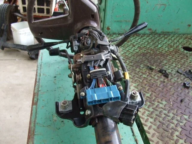

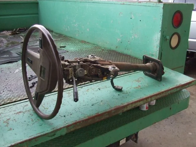

I have a tilt column from an FJ60 for which includes the wheel.
$75.00 plus shipping.

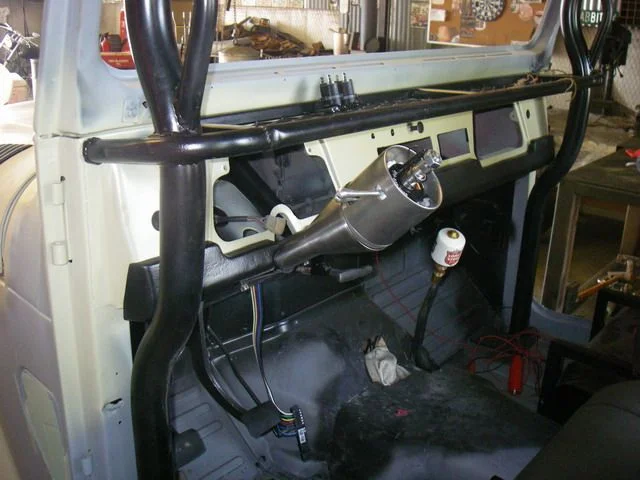

You might also consider a stainless column from Flaming River. They have several length available with and without shifter with a similar diameter. Its also nice since the wiring matches most GM aftermarket harnesses that are available.
