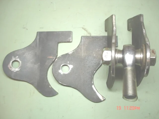

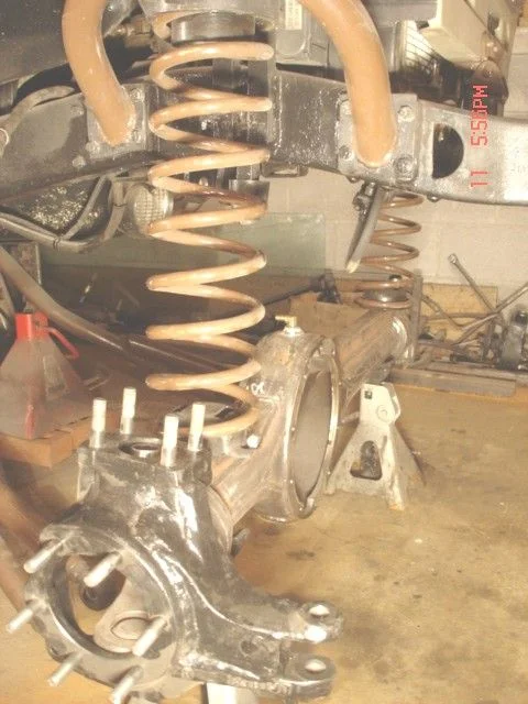

I switched over to the 40 until my new 35 splined axle shafts arrive from being cut & splined for the So, I've already started fabbin up the hybrid axle & the lower brackets for the links. The brackets will be fully boxed & yes, they're bent to match the angle of my lowers. You can see how one bracket is longer than the other. It's a redesigned y-link suspension.

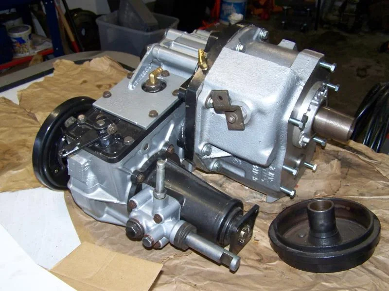

Got the new (to me) SM465 prepped for installation. Assembled the NP203 GRB to the LC T-case, and finished detaching the body in preparation to measure for the lift I am going to need to clear the new drive-train.
Also started cleaning up the garage now that I am starting to use up the parts that were scattered everywhere

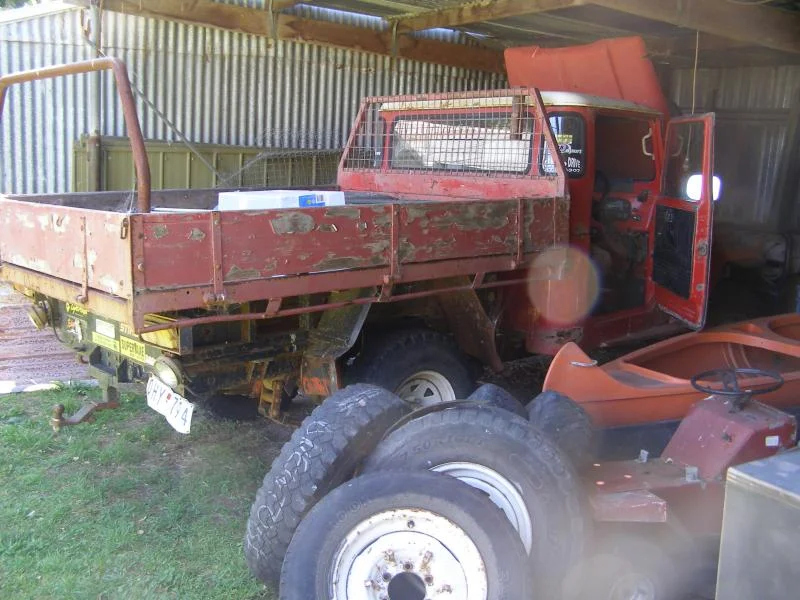

well i put my 45 up for sale,had interest,went out to get some pics this morning and couldnt go through with it,so back to the drawing board with what to move on

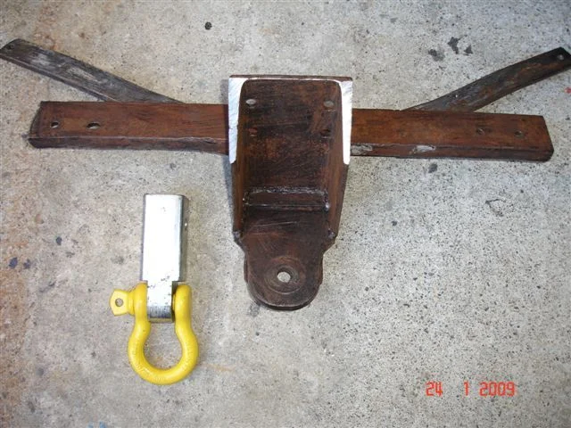

Anyway here's my bit............... Decided to modify my towbar. Here it is before modifications: (Well - Actually I have already hacksawed some steel off the top of the channel section.)

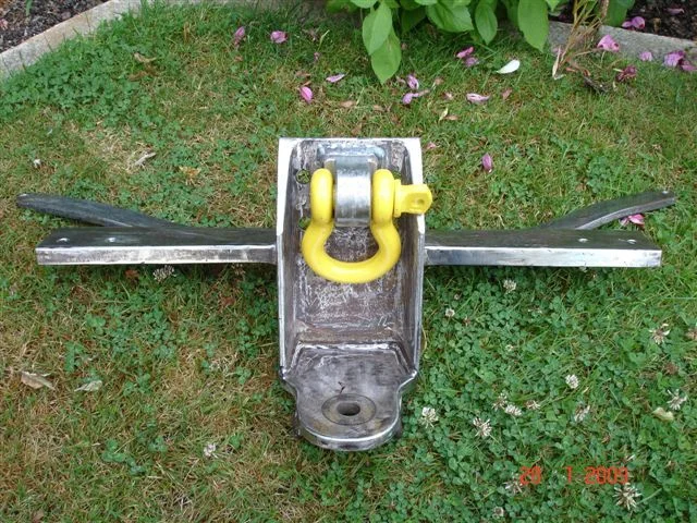

Here it is with a "bow shackle receiver" fitted:

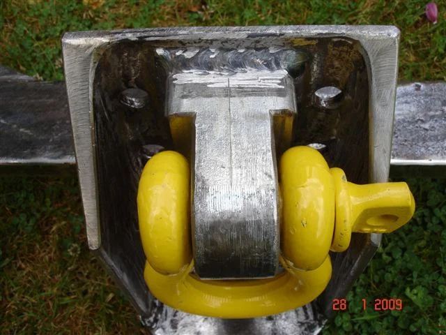

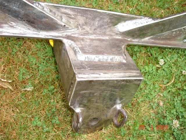

At the same time I ground out all the "bird**** welds" and rewelded them myself:

The "bow shackle receiver" was inserted right through the channel-section and then I welded BOTH sides:

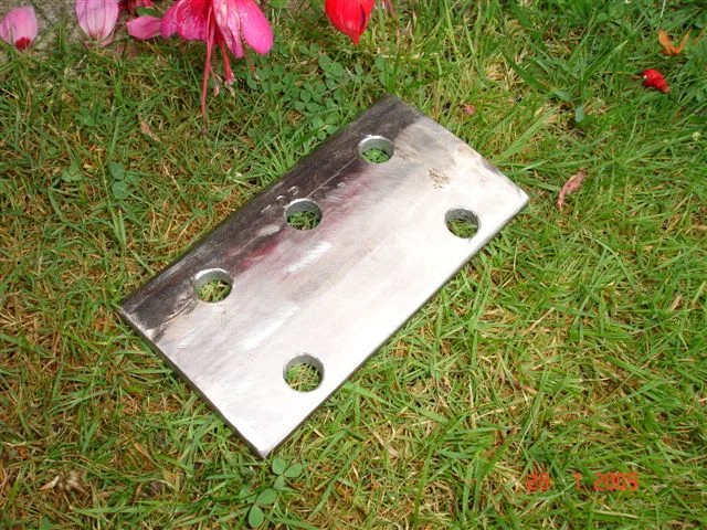

But in case that isn't strong enough, I'm fitting a thick backing-plate behind the rear bumper/crossmember with 5 bolts going right through it to secure the towbar. (And there are another 6 smaller bolts holding it in place too.) One of these 5 bolts threads directly into the "square-section" of the bow-shackle receiver ........and all bolts will be high tensile.

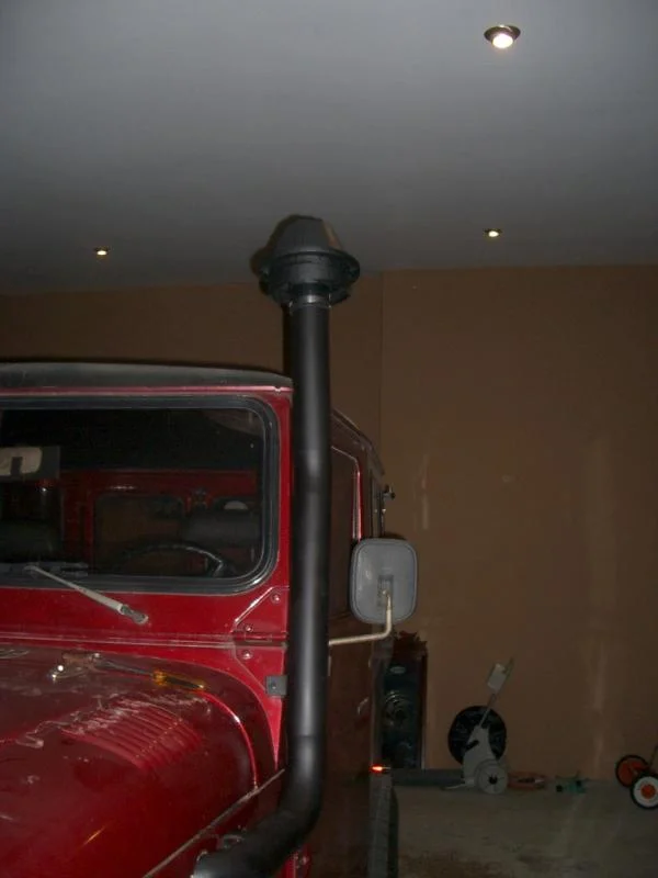

Put on a Zekster inspired Stainless Steel snorkel with and OEM head. Tonight I'm working on the LED mod and two weeks from now 60 series ps. See build thread for details.
