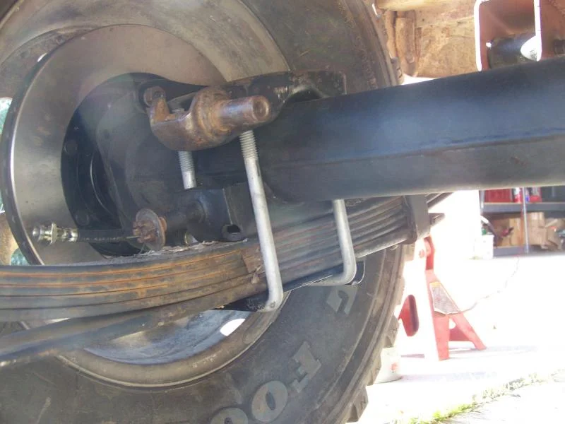

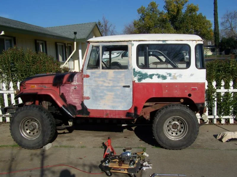

Finally got the rear axle re-installed (moving it back to give me a 99" wheel base), after installing disc brakes and opening up the rear wheel-well.
Installed u-bolt flip kit I fabbed out of 1/4" plate steel + mini-truck u-bolt brackets.
Next step: Rust bullet the frame from the front body mounts back, then get the new drive train installed (SM465 + NP203 GRB + LC t-case.)

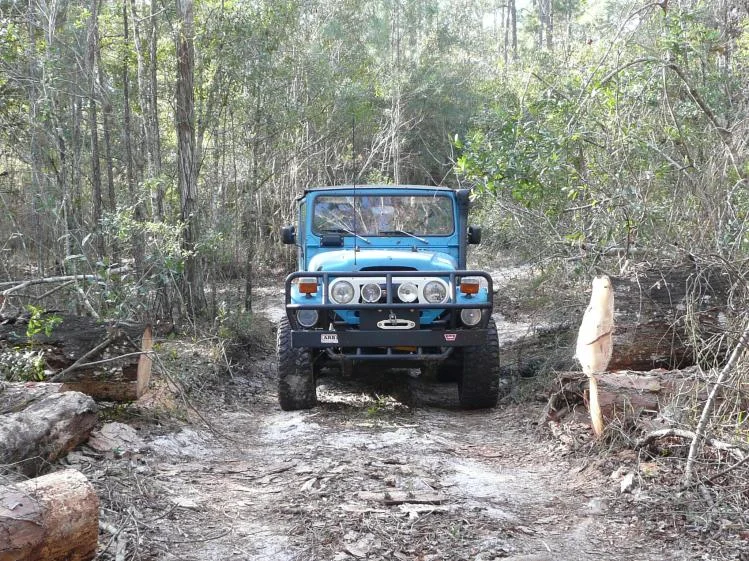

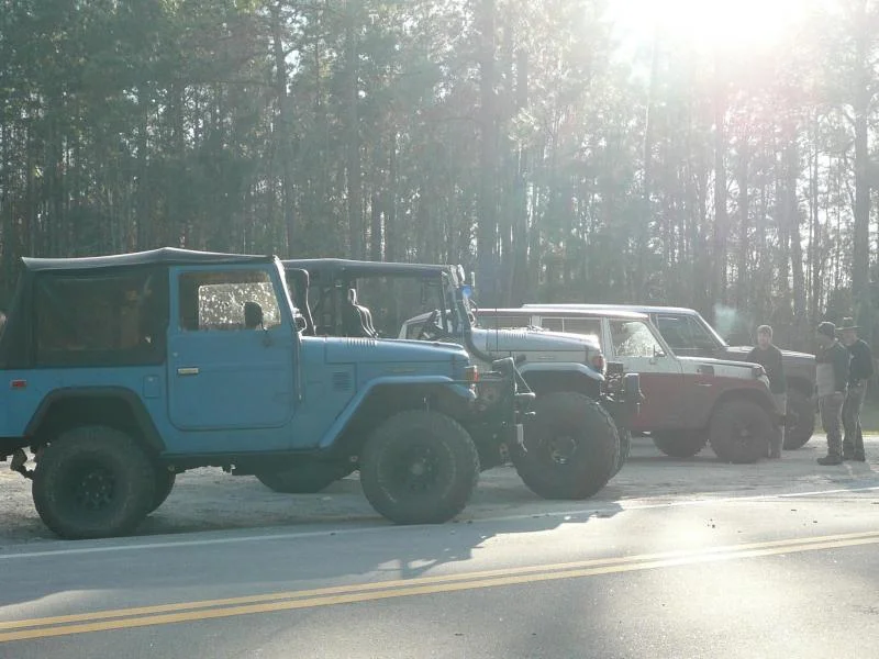

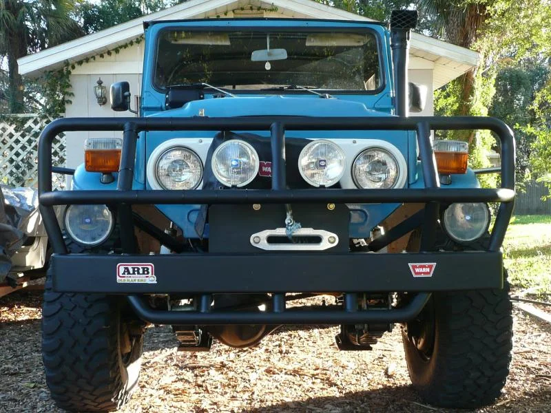

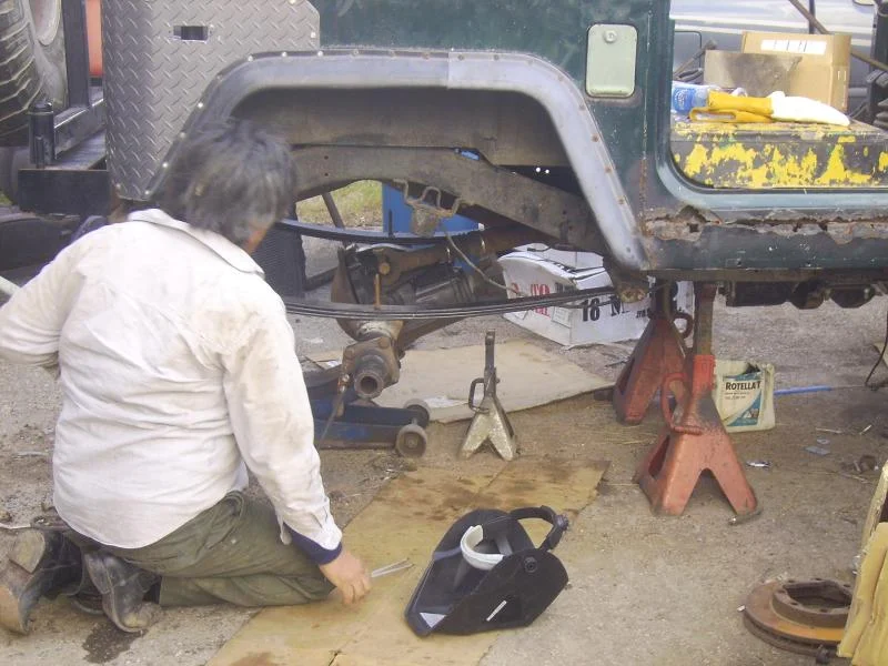

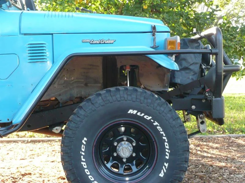

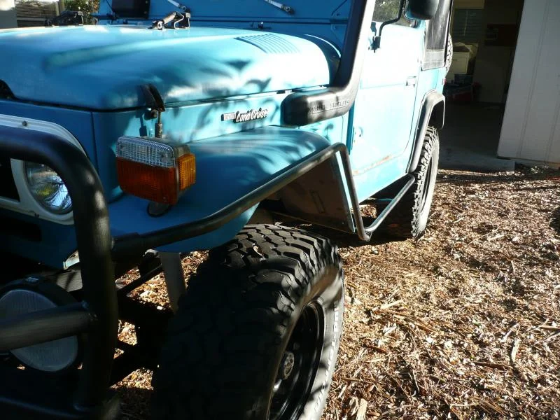

new sliders and fender tubes protection, installs the ARB frame support for the bumper and 2 Hella Rally 1000 Drivings lights

Hi All:
Seth, nice job on the u-bolt flip!
When you did the front shackle reversal, did you move the front axle forward as well?

Alan,
Tks for the props . The shackle reversal did move the front axle forward several inches. It was a combined effort to stretch the WB. To be honest I wanted to go a couple inches longer, but couldn't do it without really cutting into the rear qtr's.

Seth, so what wheelbase does your rig have?
With the front axle move/longer springs I did this winter the wheelbase of my FJ40 is a true 100 inches.

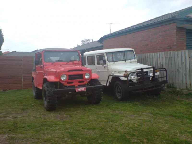

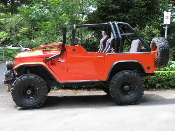

Thanks Mate, She's a great girl & doesn't get between me & my cruisers.
The 40 is really a bitsa - the body is mostly 78, the engine, gearbox, split transfer case, Pwr Str & complete axle assemblies are from an 84 Troopy I had (great mechanicals but totally the body was rusted out). the half doors are from a 72 & the triple wiper windscreen is from an 82 LX. Front ARB, Rear Lockrite, Body lift etc. I'll start a thread when I've done a bit more.
The tyres are actually Simex Jungle trekkers which aren't quite as aggressive as Centepedes but are a better allround tyre in my opinion. That being said it's an off road rig so I'll be getting a set of bead locked 35" Pedes next up.

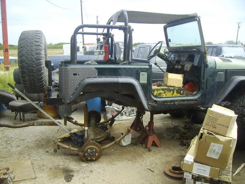

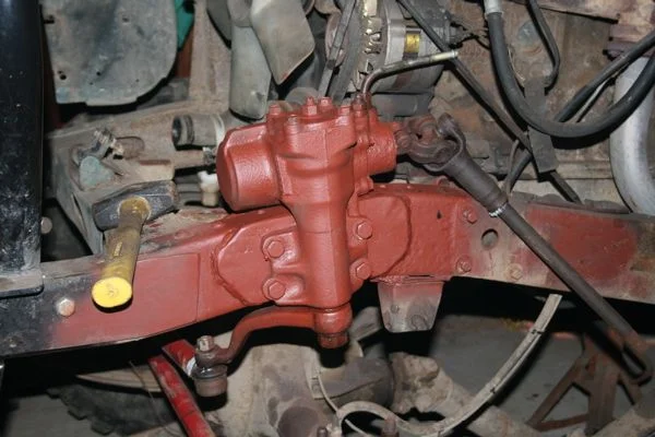

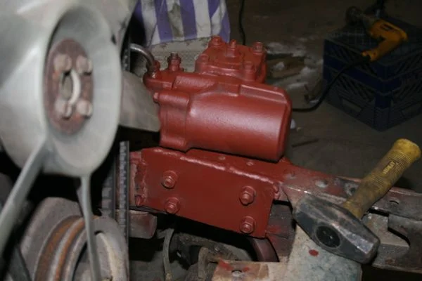

Worked on the steering.

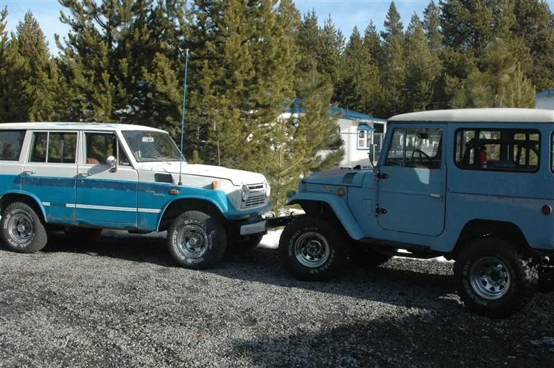

Got it a friend to play with...

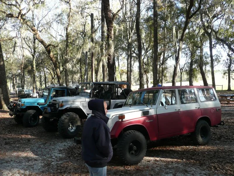

Yesterday a few members of the TLCA went to a trail run...dry trails but was great !!!!

Removed 4in lift along w/ Stock axel
put the F100 springs and the 14 bolt lined up. here's My friend Javier making sure the weld on the perches are good hopefully this will bring my wheel base to a 97" ...and yes the drive shaft will be a short one.
