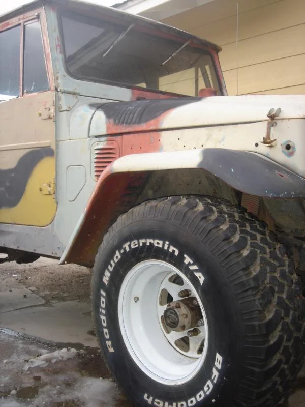

I picked up a set of used white spoke rims with some 33 tires and threw 'em on. I love the classic 4x4 look. Tires are have some age cracks but they'll do for now

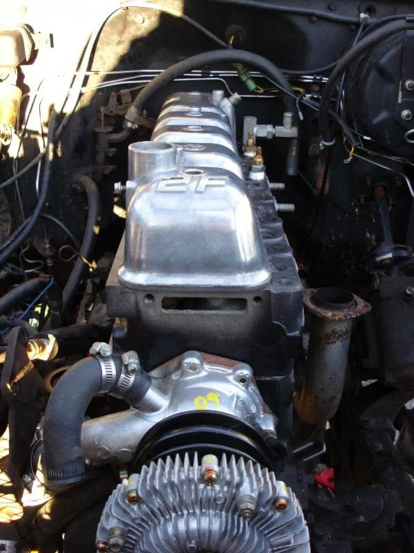

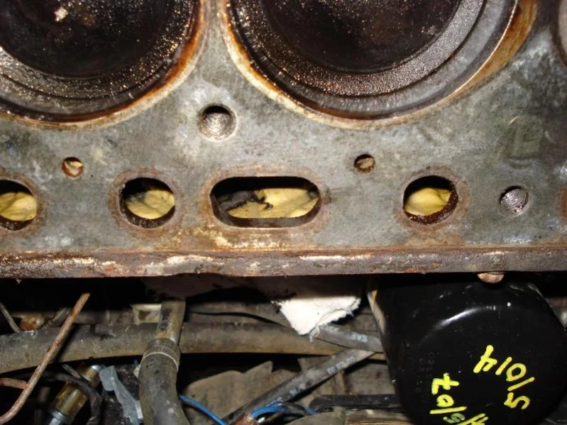

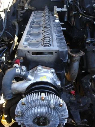

pulled head for head gasket removal and putting on a freshly redone head, 3 angle valve job the works. I now need to pull the side cover off and oil cooler and clean out the milk chocolate covering the inside of the engine. heres a small shot of the inside. the valve cover was coated with this stuff, looking like beeswax over over.

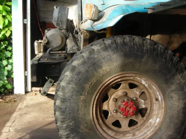

Hi All:

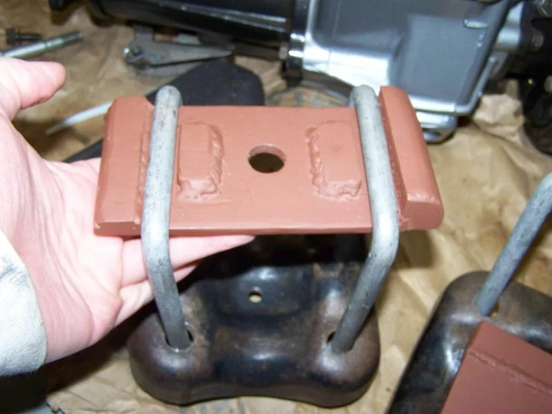

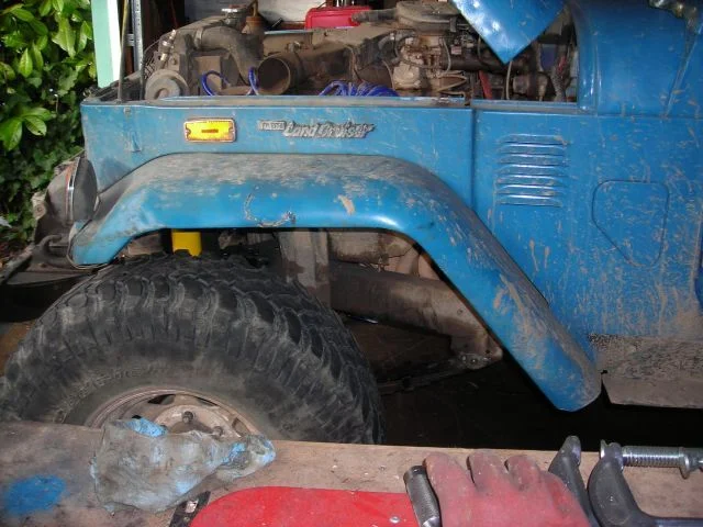

Well, still working on the front suspension mod. How does it look in these photos?
Regards,
Alan

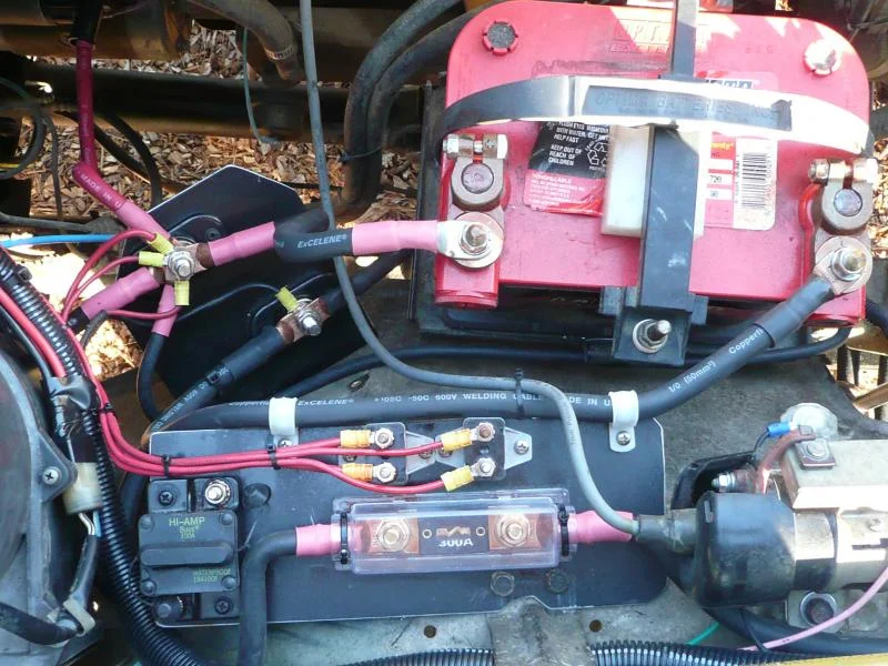

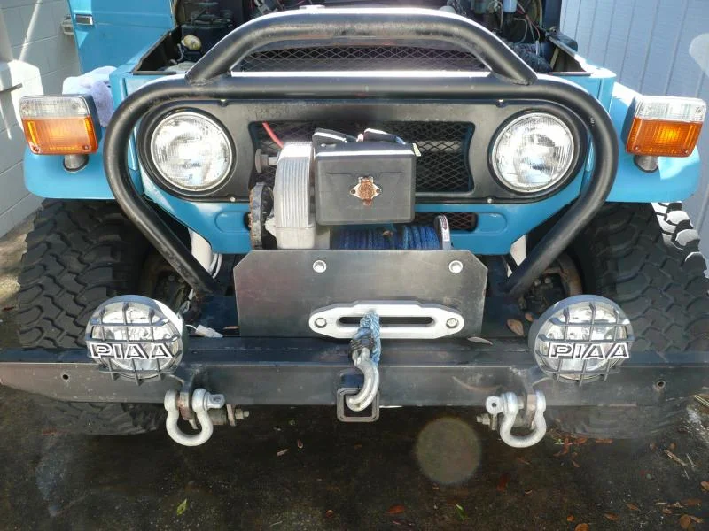

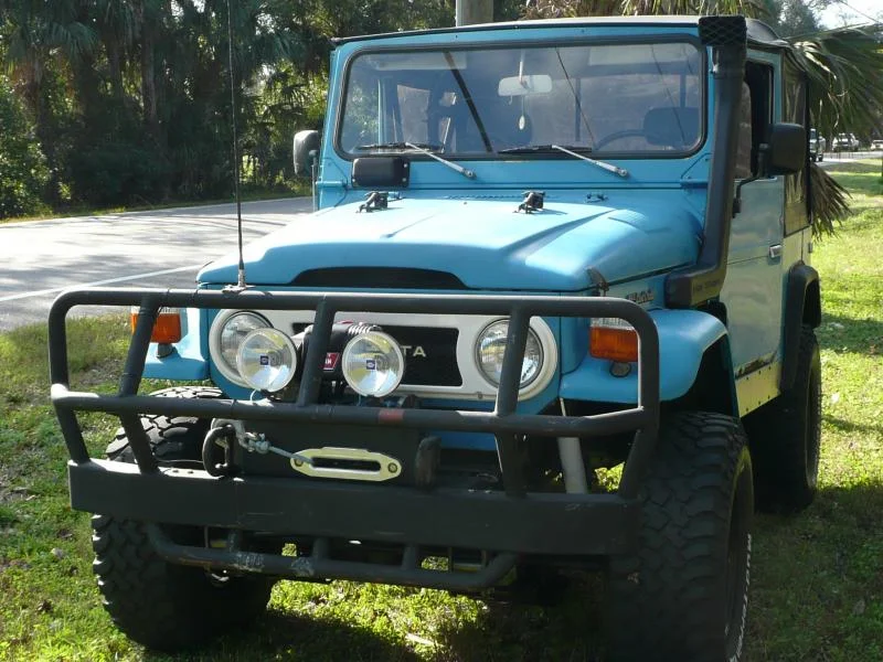

i buy my 1976 dec 20 2008, in 3 1/2 days: i install the front Arb bumper, change the warn 8274 for a fresh serviced by me.. Warn 8274-50, change the battery system to 1/0 ga. , install a fresh rebuilt blower system, fix electricals BUGS and route better the ez wiring,fix the lights,wipers,install the rear marker lights at the rear quarters, made a light holder for the tag,paint the air cleaner,install 2 hella drivings lights and paint the bezel.. The Priceless.....piss off my neighbor 2006 Heep when i turn my sweet 40 with headers... not bad for 3 days...

Built plates for my DIY u-bolt flip kit. Using mid-80's minitruck brackets on top of the axle, and my fab'd plates on the bottom, underneath the spring pack.
Waiting on one more hard-to-find square u-bolt and the rear axle can go back underneath.

work in progress
I've been fooling with the head on the 40. Pulled off the old one, cleaned out the lifter valley, oilpan and oil pump. Replacing all gaskets etc for side cover as I've been too lazy to fool with clearing the old one off, Hell there was nothing wrong with it anyway. Broke off a darn little bolt in the block- extra black goo in there now!
Here is a pick of the new redone head, magnafluxed, milled new valve seats, 3 angle valve job and nice new seals. Unsure of the make on the dual springs, they were on there with the head. I had the machine shop double check the spring pressure as I wanted it on the low side with the old cam and lifters. I pulled the lifters and they are all in pretty decent shape, 2 of the 12 were a little pitted on one edge and 2 or 3 with small crescent moon shaped wear in the face. I think they will be ok for a while as I don't drive this thing too often.
It's been so damn cold I've been to much of a puss to get out there and get the intake on. tomorrow right...
See the garage widow wondering when she can go out to dinner.
