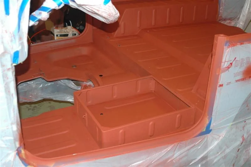

Lots and lots of sanding prior to this. Lots of sanding to go!
Primer round 1.

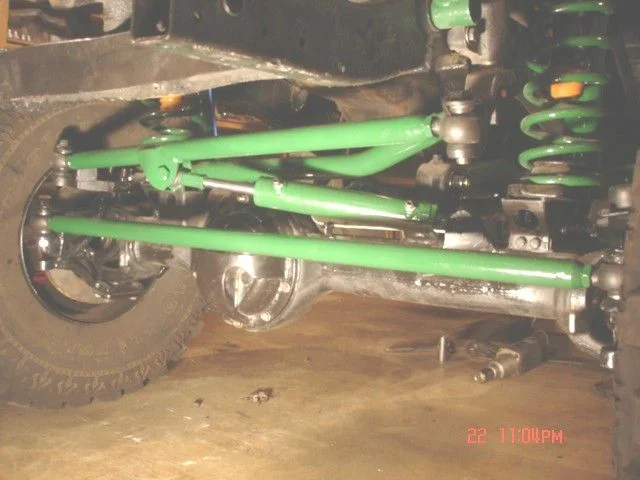

I totally finished bolting up all my steering linkages, ran new brake lines & mounted hydro assist cylinders on both rigs. I'll be measuring for steering lines next & bleeding the brakes.

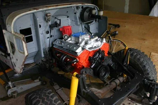

I got the motor in this weekend. I am hoping to get the accessory drives and battery mounted next.

mattolewis,
Engine looks great. Are you planning TBI, or carb?

I will be doing a carb. I would love to fuel inject it, but already have a carb and can not justify buying an injection system.

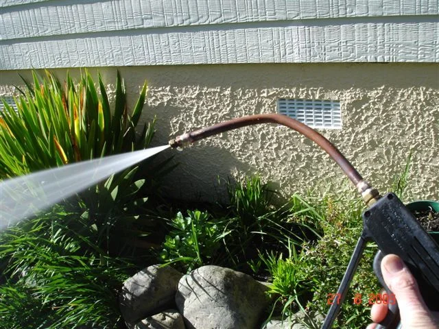

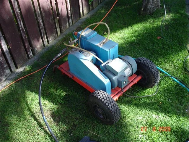

Blew out the stones and mud from inside my chassis rails with my waterblaster using a new "short/bent nozzle-rod" I made:
I was a bit worried about my nozzle-rod because I made it from copper refrigeration tubing. (Bit thicker-wall than water tubing but not much thicker/stronger.)
When I pull the trigger it gives a "bent-barrel-shot-gun-style up-kick" but so far the copper hasn't shown any sign of buckling or bursting under the strain........... Touch wood.
Oh - And it is now far easier than trying to waterblast under the forty with those "standard long straight rods".
PS. Here's a pic of the waterblaster itself. ......................Like my BJ40 (and myself) - it's old and therefore much better than modern versions:

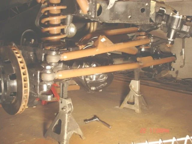

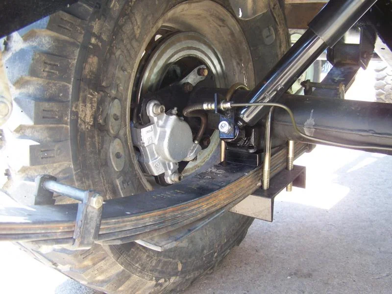

It was actually pretty simple. I cut out the shock pins from the x-member (front and back, both sides) and sleeved the x-member holes with some steel tubing.
Then I cut off the shock pins from the axle. I got 4 bolts that would be the right size to serve as shock pins and cut off the heads. I measured the angle the shocks would be at and cut an angle on the the bolt ends accordingly. Then I mocked up the shocks, and welded the bolts onto the axle. I slid the bolts for the tops of the shocks into the sleeves on the x-member and welded those up.
Cleaned up the welds and painted - turned out nicely. To be honest I'm not sure how well they'll hold up (my welder isn't great), but seeing as the springs hold the weight, these just need to soak up the road vibrations.
Pic's not the best, but it shows how close it comes to stock on the axle.

Seth_O - I notice the wear pattern on your rear discs is 2 narrow stripes. Mine has one narrow stripe in the middle like yours. The outside of the disc shows full contact from that pad. Is this kind of pattern normal for Monte Carlo disc brakes?
Kootenay - no idea to be honest mate, I've only had the Monte Carlos' on for about 2 miles ;-).
My thought was that the pads weren't true, and that with some use they would wear down to be even. That pic is of the d-side disc, the p-side is wearing much more evenly.
Have you been running yours for a while, and still have uneven wear patterns?
