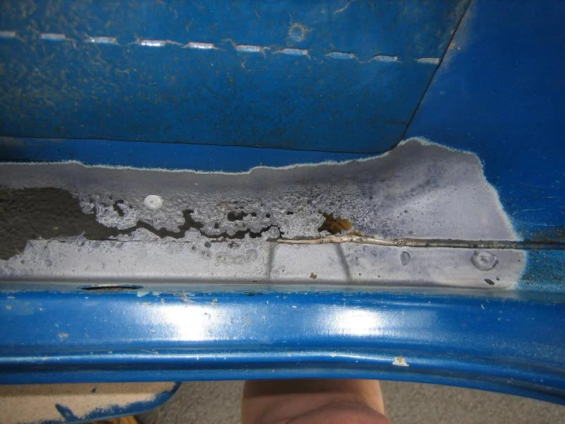

Found the rust on my "rust-free" BJ42. PO hid it with Bondo.
Sand blasted it and painted it with Rustoleum as a temporary fix.
There's some metalwork in my future.

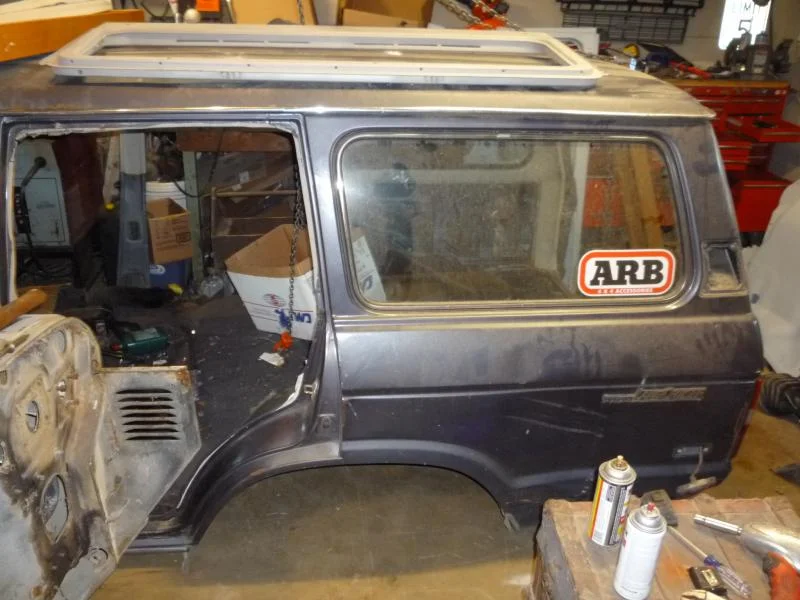

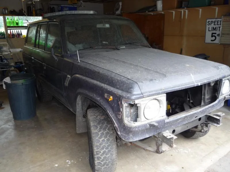

Needed 60 axles... Today I bought a cruiser sight unseen... and deliverd. Wife paid him and gave her the title as I was dropping off my 40 frame at the blasters.
Got home, muscled the 60 in the garage.
2.5 hours later, had the accessories, and body off the frame.... Thats how you get to the axles right? Take everythign off of them first

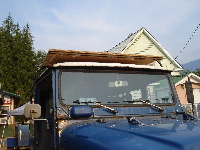

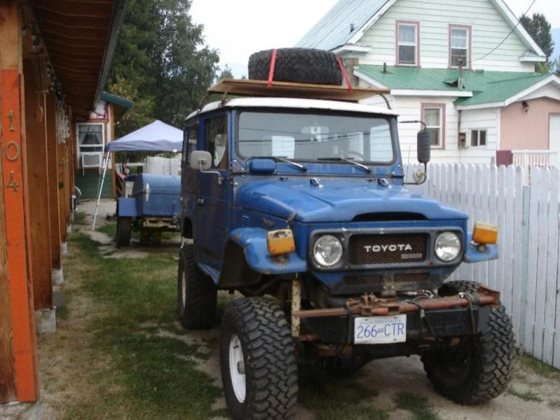

Took the roof racks off the '79 and put them on the '83 with a plywood platform to mount the spare as I need the room inside the truck for a kennel for the cats if we have to evacuate our town.
It's not intended for heavy wheeling, but having said that it seems to me that the spare weighs less than the canoe, if my muscles are an indication, and the canoe has ridden on top of the '79 a whole lot of kilometres both on and off road.

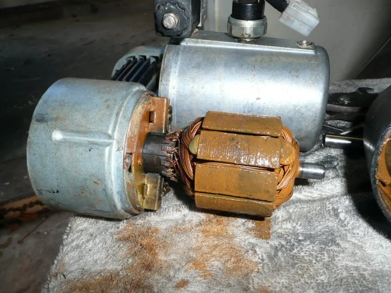

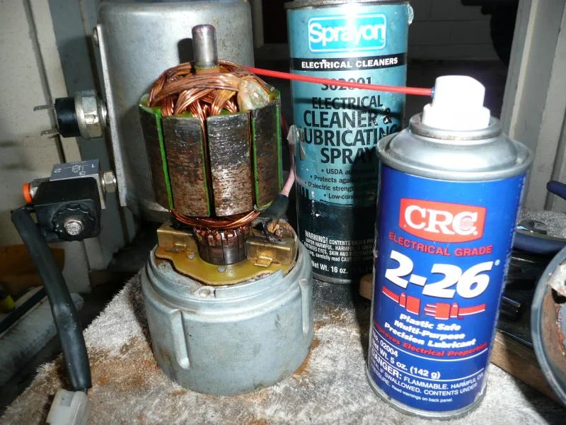

Rebuilt and installed 8274 Warn with MAF bumper and MasterPull XD line with sling hook and Marlin Crawler fairlead (birthday present from wife and Jr.)

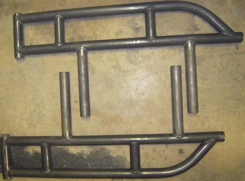

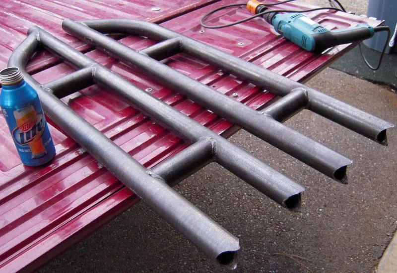

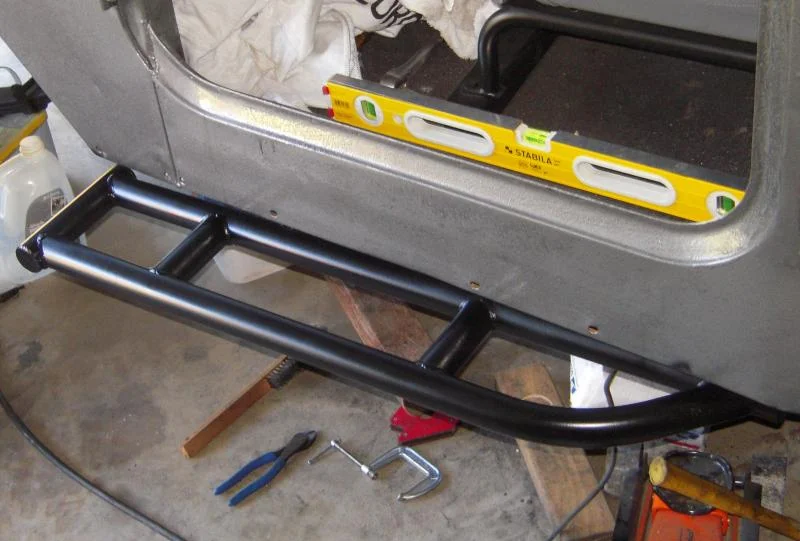

I got my set of sliders from Trail gear this morning and started chopping and grinding so they will fit. Pics to follow soon.

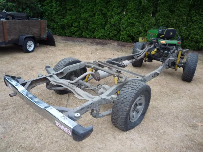

Took a picture of th wifies 60 from the boomtruck

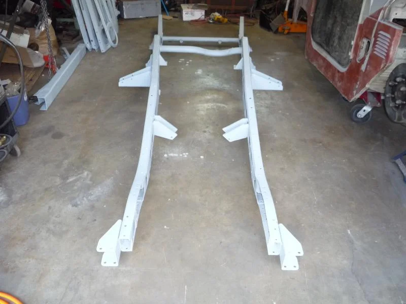

And knocked some crap off the frame and put it in primer.

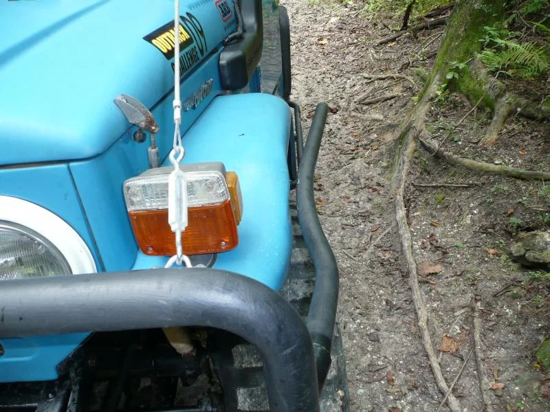

Went saturday 8-15-2009 to a trail run...left tube fender protection gone...snorkel head gone..lot of fun and get back home after driving 90 miles from that trail run..not bad for a FJ40...

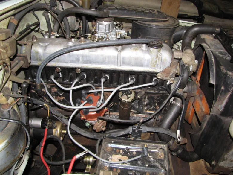

looked at it. A tear hit the ground and I walked away. Getting ready to pull its new SBC powerplant out of the donor vehicle though.

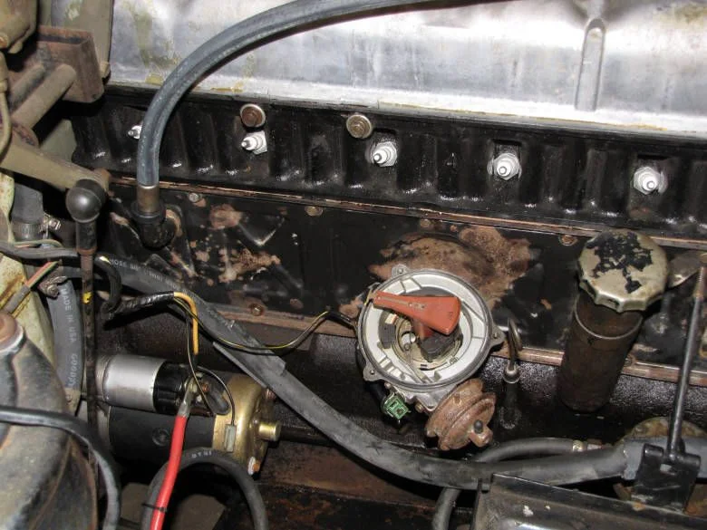

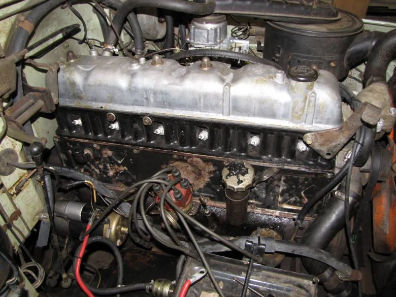

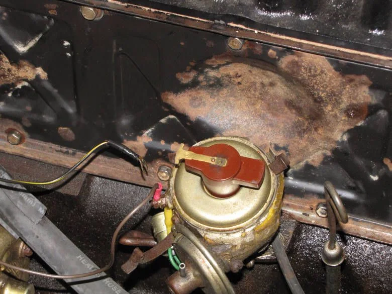

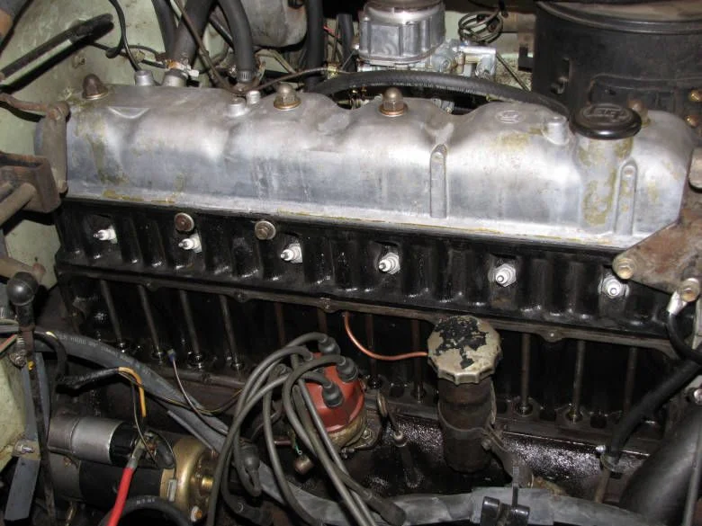

Installed FJ60 Dizzy in my 40
I purchased this a while ago from a guy on mud and finally found time to install it.
First I had to remove and install the new side panel. This seemed to be the hardest part for me or I just was just over thinking it. I was worried about abrading the oil feed line to the valve train. Either against the cover it self or the lifter. I did a few test fits without the gasket, and using a thin layer of grease on it to see if they touched. They did so it reshaped the oil line a little and repeated, they still touch. So I use a body hammer to reshape the bump in the cover until it cleared. It didn't take that much, but I felt better about making sure the oil line had clearance all around.

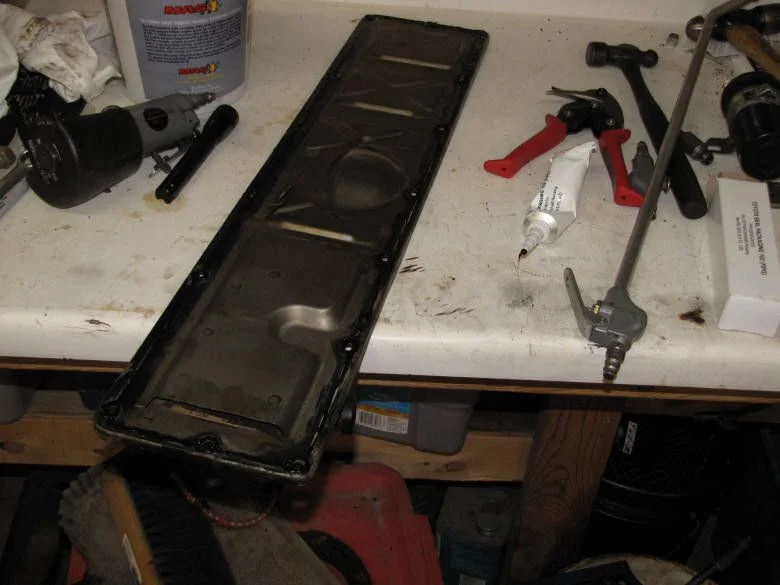

More on the dizz
Here's the new side cover installed.

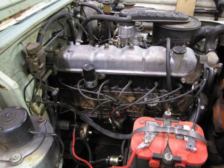

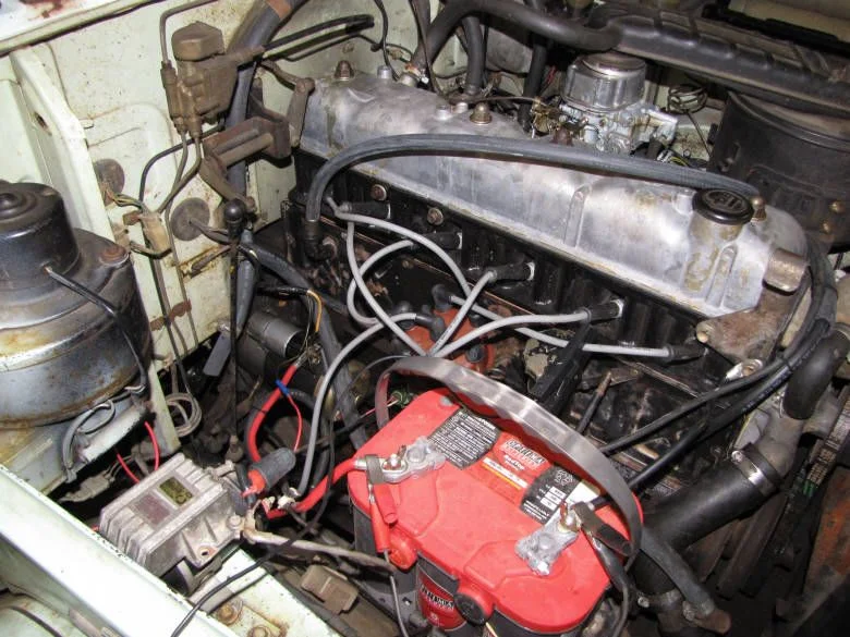

More dizzy pics
Here's the new dizzy installed and wires. I would like to thank Coolerman for his great web site and all the information on this. It's running, I just need to get it dialed in a little bit better.

Looks good Mike.

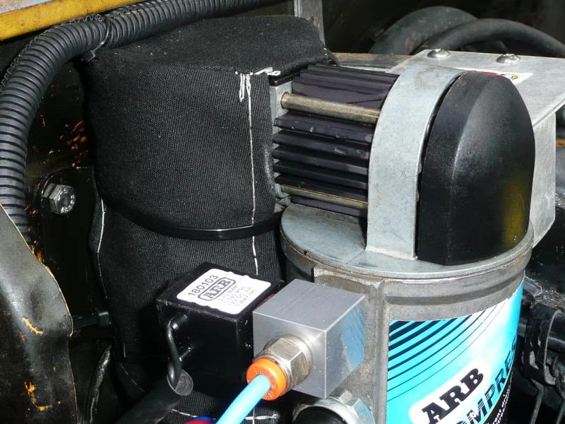

during my last trail run i notice that i lost the arb pump, after check all the connections ,decide to check the pump ...guess what i found.... i have the pump in a high position,so my guess for the water inside the motor its when i clean the engine, clean all the components and a friend made a small cover ,i cant seal all the motor cos its need to cool down in somewhere, but now its ready again and i don't have to buy a new pump for $240.00

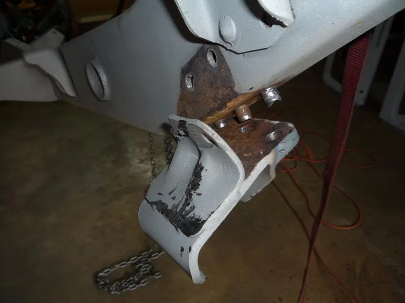

Fab'd up new rear shock mounts since I've moved the rear axle back a ways. Re-bled the disc brake setup (again.) Did the mudrak dual seal on the t-case, hopefully that stops the leak for good. Now that the cruiser is ready to go I got the insurance going again. Should be going to the DMV next week to get it caughtup out of non-op status
Just need to get the exhaust done and it's ready for DD.....
