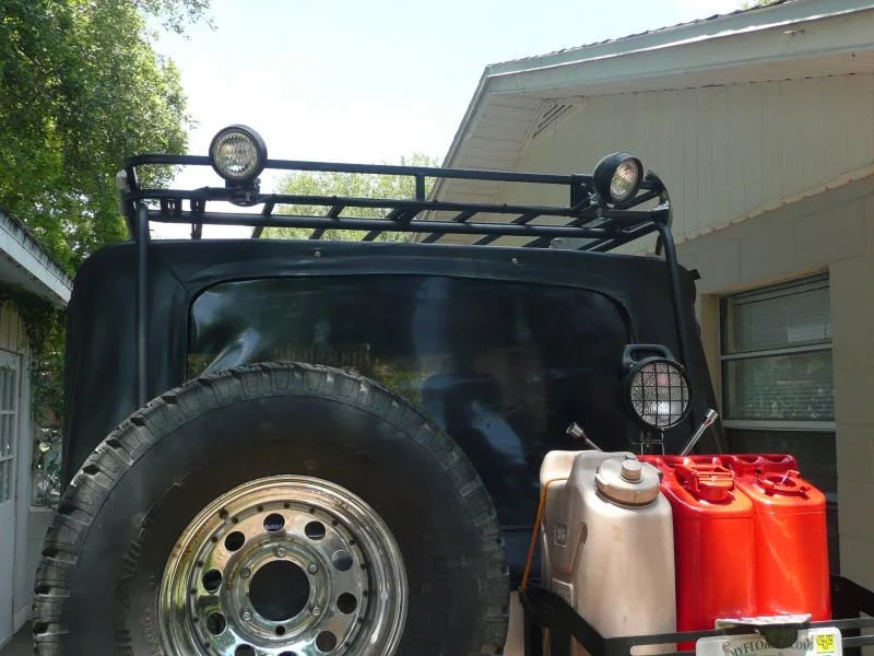

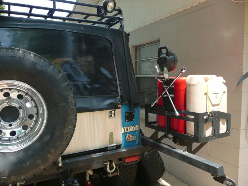

paint 2 military gas tanks, buy a water tank...install a Hella Matador work light and 2 more in the roof rack...

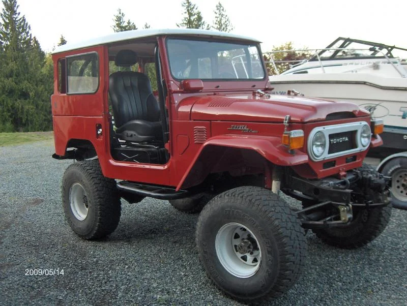

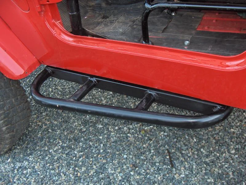

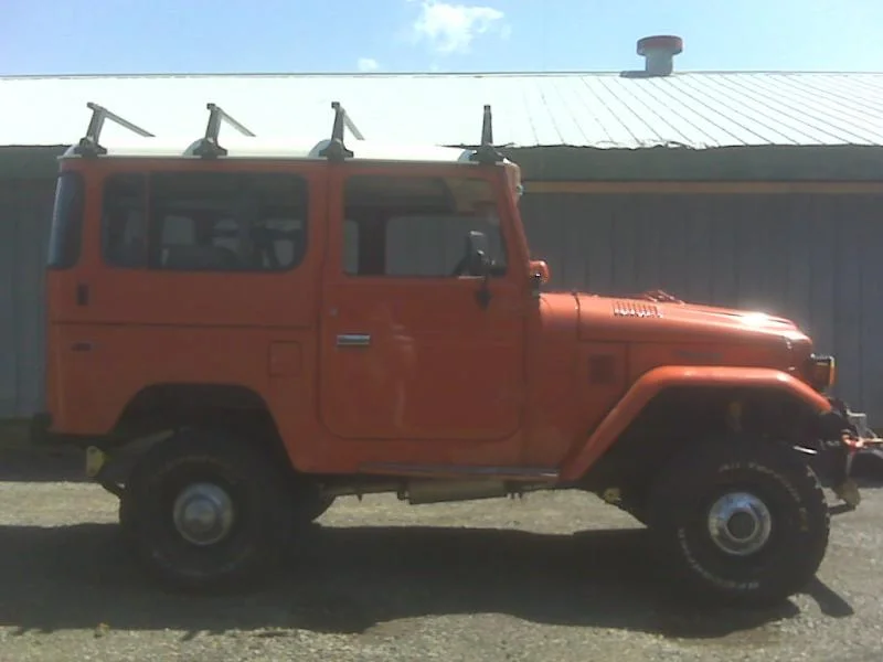

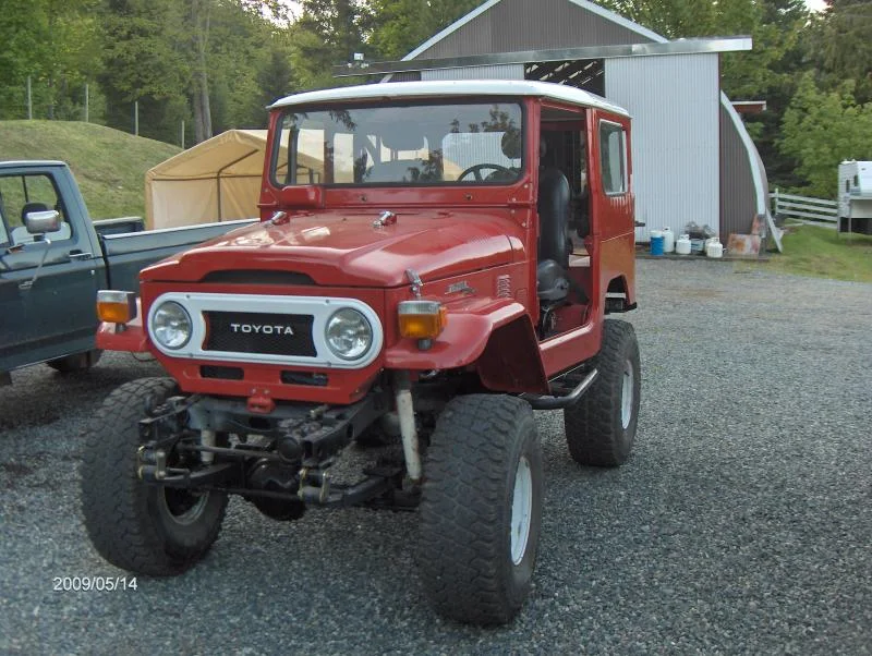

Finally got my girl a turn key.Was my build thread ( 75 40 build) ,installed rock sliders ,will get wheel alignment tomorow.6.2 purrs like a kitten

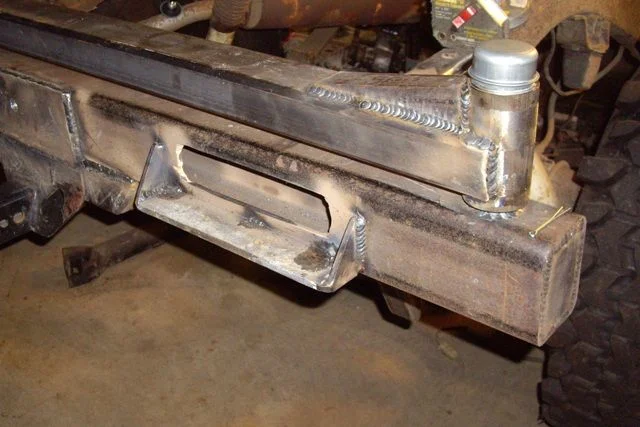

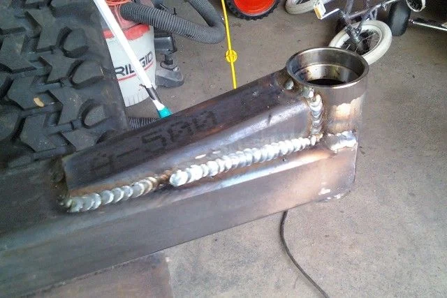

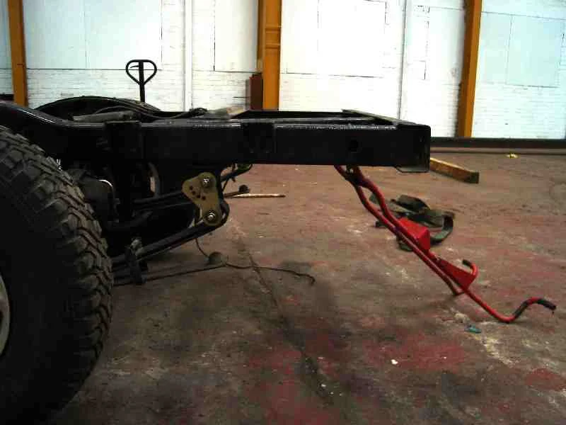

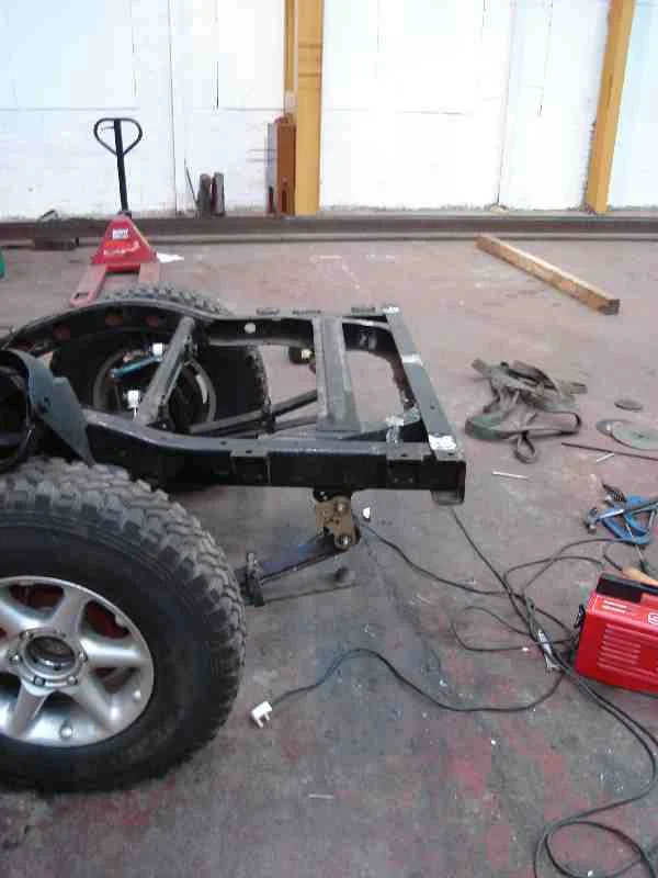

I bought a swing out tire carrier spindle and such from a vendor something like 2 yrs ago. As part of a build up this spring....I finally got the damn carrier installed today. Here is the build thread and pasted below are some pictures.
http://forum.ih8mud.com/ma-nh-yankee...d-much-do.html

"DarGreg," nice!

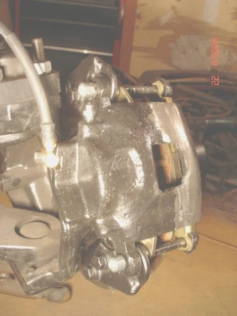

D60 Brake Calipers To Fit 15" Wheels
I modified a pair of stock Dana 60 caliper brackets to fit 15" wheels. I could have bought some but what fun is that Still needed to slightly clearance the calipers though. These are going on my hybrid axle w/LC center & D60 outers

where did u get those sliders ? I like the look..nice an easy/clean

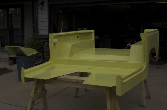

No that's not the final color, it's just aircraft epoxy primer! Whoot!

Today was going to put the bondo on and sand the cruiser down. I hated the idea of covering up crap so I'm cutting the rear fenders off and making new ones. Oh and making a rear sill. Fun stuff.
Went from this today
to this
to this
to finally this all in about 6 hrs.

new 2.5" OME
Installed a new OME Heavy kit. Hmm.... those stock 29's looking a little inadequate now!

Took the driver's door off the '79, cleaned it up and rattle canned it blue and put it on the '83. I guess the '79 is a parts truck now, I can't afford to fully restore 1 truck, let alone 2.

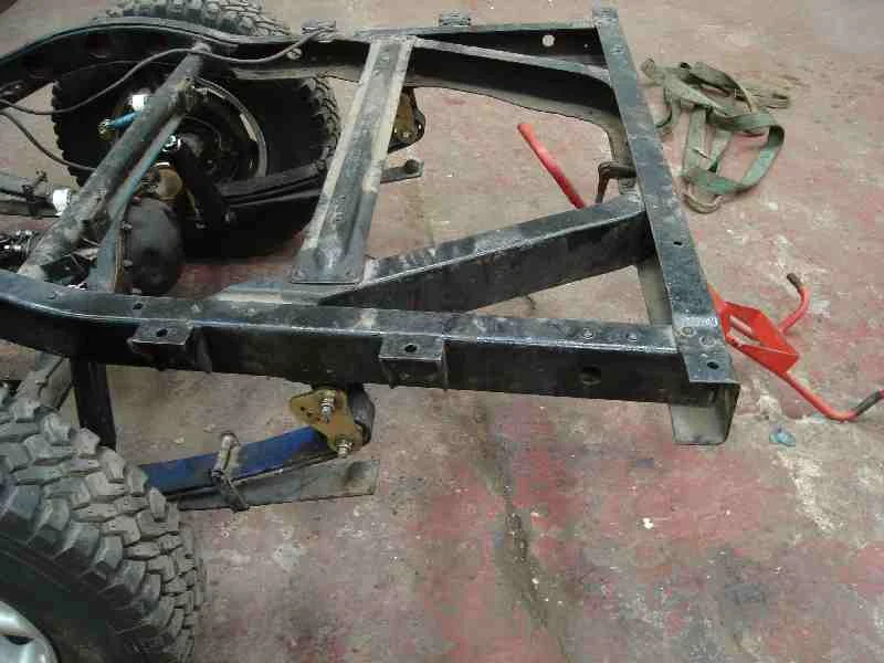

FJ45 Pickup Rear Chop
Chopped 14" off the back of my FJ45 so it fits in the garage.
Will also improve departure angle and has been the plan for a while but measuring the garage at our new house and finding it's 15 and a half foot long brought the plan forward.
Just got to drill and bolt the back C section. Those rivets take some getting out but it was reassuring to see how much metal is still in the frame.
Photos of before

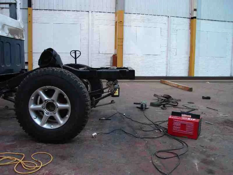

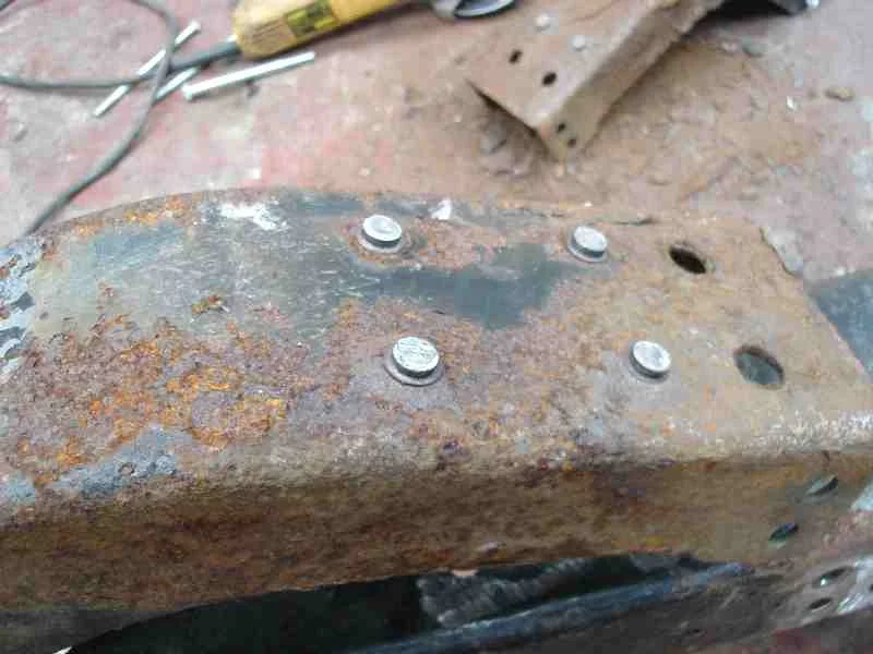

And after.
Just need to build a tray. I think this pickup was supplied bare and whatever was on there was long gone when I got it.
Also detal of rivets.
