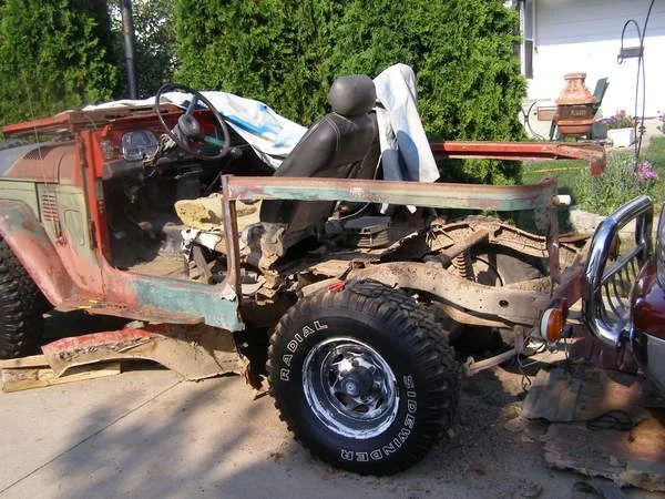

Right now I'm recreating the tub on my cruiser. I started with holes big enough to put your leg through and push it and so far gone that I couldn't even salvage dimensions to work from.
Any interest?
I'm working on creating all the more or less flat panels myself, purchasing the front fenders and rears quarters. I'm elimating the tail gate altogether to help stiffen the tub by replacing the amby doors with a hatch off a 74, I'm framing the tub in steel tubing and then bolting in new floor plan and wheel wells out of aluminum tread plate(MN salt kills vehicles). I'm going to order a gallon of red paint off ebay for color. I may pop for some sporty seats and Attempt to create a roll cage that is tight to the body and windshield frame that still fits inside the hard top. I hope to keep the drive train original with the exception of a change out of the weak front drums to discs.
Defintely not a true restoration or outragous build but I hope to have developed some new skills and end up with a fun 40.

Before you decide to "bolt" in a floor, think of what might happen in an accident. Not trying to be Debby Downer here, but I shudder to think of a side impact. Why not buy a harbor freight (inexpensive welder) and learn to do it right? All the rest sounds fine, but just name your buildup and put it in rig of the week.

You will be in the rig you pictured over $4k just getting it safely road worthy.

I'm framing the tub in steel tubing and then bolting in new floor plan and wheel wells out of aluminum tread plate(MN salt kills vehicles). I may pop for some sporty seats and Attempt to create a roll cage that is tight to the body and windshield frame that still fits inside the hard top.
Just so I have this strait:
You are going to use some steel to reinforce what is left of that tub, and then bolt aluminum panels into the body?
Then, you might get around to making a roll cage that then bolts to these aluminum body panels?
So then you are going to mount some seats to this bolted in aluminum floor?
What sort of elaborate bolt together seat brackets are going to be used?
Good luck with all that.....
Simply because this is some sort of inexpensive build does not mean that common sense concerning safety and structural integrity should get tossed to the side or ignored completely.

FYI... how you just cut that tub away you dont need to worry about your roll bar being under your hard top because you will never get it straight enought to get the hard top to fit again...

Not to worry. I built a 2x3 rec steel frame tied together with an 8 point cage in a street/drag V8 Vega and it was all good, with less body flex than most(My interior never filled with tire smoke and left straight). My current plans will tie the cage into the frame and provide support to the tub. A friend that build flat track chassis has a bender that we'll be using to bend up the cage. I'm drawing on the expertise on many experts in the business, however the rule on this one is I'm doing it all myself(Mechcanical, chassis, body, electrical, etc.)
"how you just cut that tub away you dont need to worry about your roll bar being under your hard top because you will never get it straight enough to get the hard top to fit again" Honestly due to rust and someone in the past backing into a tree or something, the tub and top were both far from square but I'll take that challenge. Admittedly finding a source for accurate dimensions has slowed work so far. This poor truck offered few hints. Just so you know the top and doors will be fit (and adjusted I'm sure) on the tubing frame before the quarters and floor are installed on it.
I'm waiting to finish the back third before I finalize the supports and mounting to move the gas tank under the floor.
"If you re-read Decided Advantage original post, you will understand. Starting with a safe base vehicle to build from is crucial. Nobody is bashing anybody, just letting them know to start with the end in mind and build a safe base vehicle."
Absolutely!! I've learned tons reading this forum, every build and thread has new information and ideas. I enjoy and have learned from them all. Safety is important to me. The locals in the know are questioning me on the weight of this creation rather than safety conncerns.
Not to say I won't have to sort out some issues. But I'll learn from them.
Actually I have welders in my shop. It has been awhile since the Vega, so I'm using this project to polish some unused skills before I jump into a prostreet Corvette project that must be perfect.
I have left out lots of details. Just thought I'd provide some teasers.
Now All I have to do is find a spot in the shop for it.
